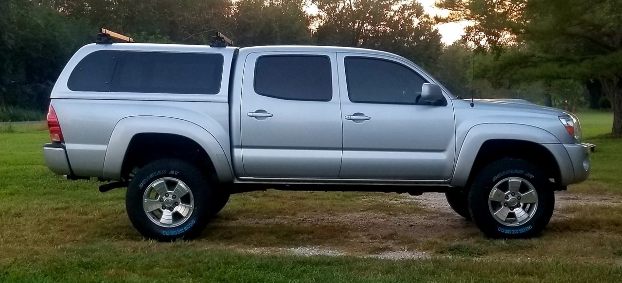

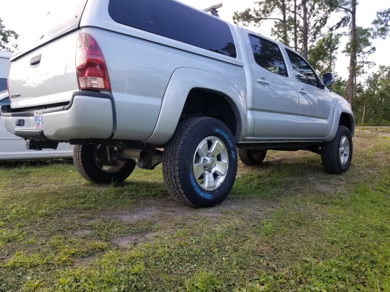

    Total Chaos 3.5 LT, King Coilovers, 35x11.5r17 on Falcon T2, ADV 4 inch fiberglass, 4.88 gears, FJ cruiser transfer case, 4 runner front diff, Cab mount relocate, archive hangers, shackles, king 2.5x14 rear shocks, icon rxt leaf springs, king hydro bumps
    Pulled the trigger on some 32s because the truck is still my daily. On the truck they are perfect width. I cant ever imagine going to a 285. Looks perfect (which is very important to 99% of us), rides great, and are at the moment as quiet as my H/T tires. Next tires will 100% be a 255/80/17. Not stoked about an 85% sidewall on a 16" rim with 3 inches of lift but I also have never driven with that setup. Thanks @Unchained 5150 for the advice
    Your truck is the NATO equivalent of the 5.56 round. Looks military. Very nice.
