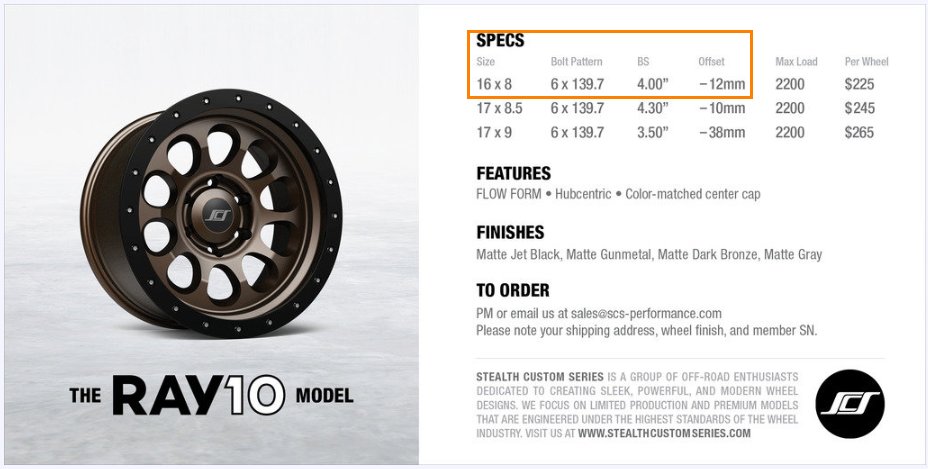

    Which offset rims do you have , and do you have a picture from the front or back. Looking to see how skinny the 255s are on an 8” rim.

    Only one option in the 16" variant. Specs are listed. Understandably this doesn't answer your question regarding the aesthetics.

    I thought they changed offsets on some wheels - I did some searching and you are correct - I thought they offered the deep offset ( -38mm ).

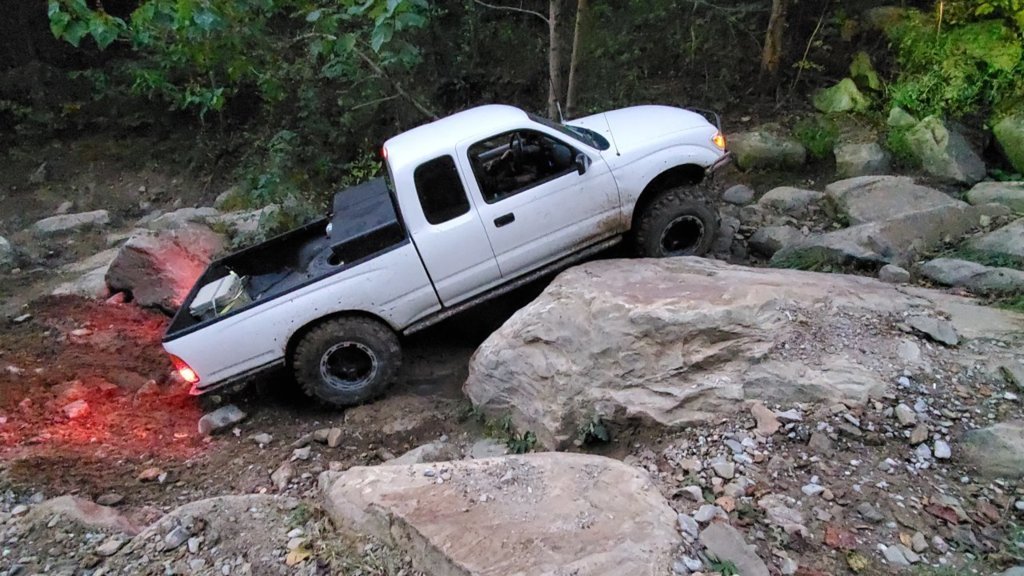

    I do the skinny thing. Probably a new size and tire for this thread. 34x10.5/16 LTBs.

    Great wheeling tire!! I have had swampers on a suzuki based trail rig many yrs ago!

    Yes, they do what they were made to do very well.
    Probably the biggest advantage I see in them over my 255 km2s is a product of the bias construction. The km2 really started to squat hard at 10psi, sacrificing quite a bit of GC. The bias tires stand as tall at 8psi as they do at 32. Deform like a play-doh around obstacles too. I’m very pleased.

    I ran tsl radials then ssr radials but wheeled with guys who has ltb’s for strict trail rigs and they loved them! Exactly the performance you described about flex and ground clearance

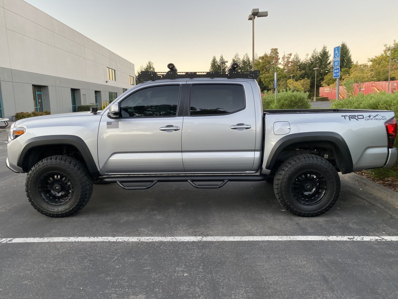

    I have had my Cooper S/T Maxx 255/85/R16 “skinny’s” on for 6 weeks and love them. Zero rubbing issues on stock UCAs. The tires are a little noisy on the highway but drive great

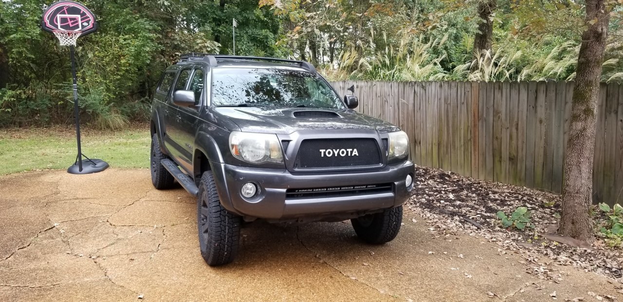

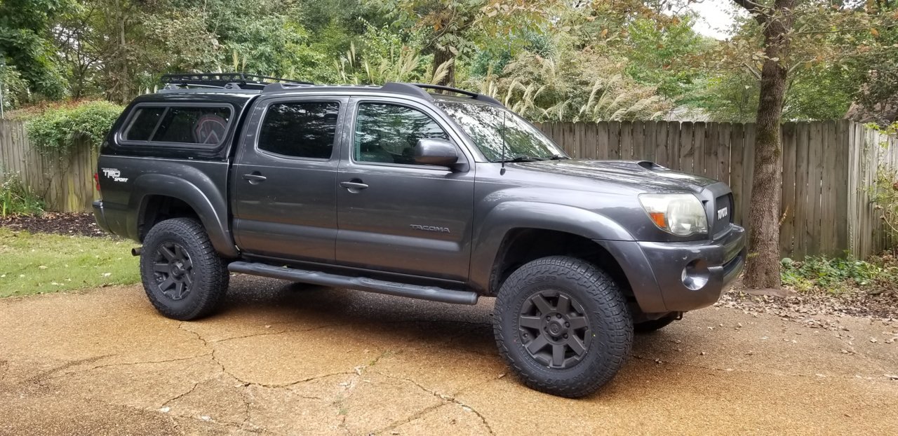

    My new set up..... 255/80/17 Falken Wildpeaks
    Full OME lift, SPC UCA, Dakars
    Rides like normal.

    Looks great! Can I bother you for a pic from the front or rear taken at similar distance?

    i can tell a difference. not a huge one. still get 16mpg and that's not taking into account speedometer difference. I am a little more concerned about the handling on wet roads in the rain (less surface area for speeding up and slowing down). But hey.... I'm quite happy with the purchase. Hardly any road noise and rides the same

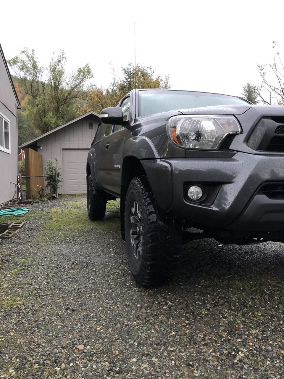

    E973E628-9F84-493E-9C37-835B61882DCA.jpg 255/85/r16 Cooper ST Maxx
    hope we get some snow soon to try them out!

    The tires look good. What tire and size did you run previous to the Falken?
