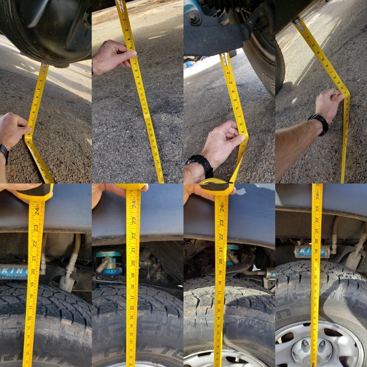

    Measurements before tires today
    Front tire to fender 6.5"
    Rear tire to fender 7.5"
    Front center hubs to fender 22"
    Rear center hubs to fender 23"
    IFS skid 11.5"
    LCA skids 9.5 "
    Slider legs 16"
    Rear diff 9.75
    On pathfinder A/Ts 265/75/16
