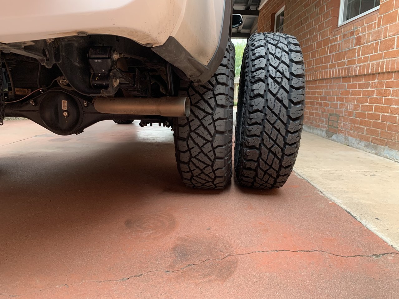

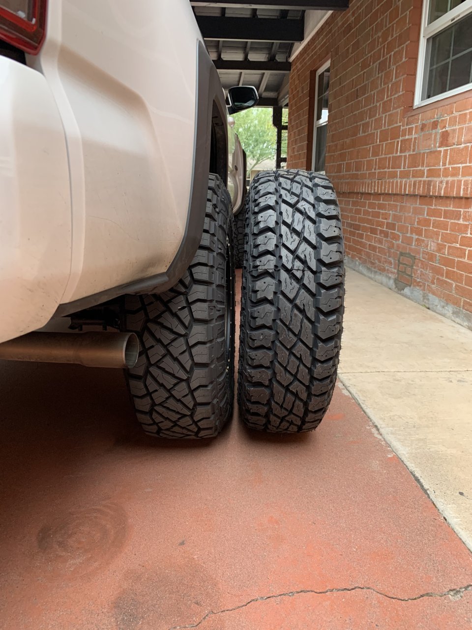

    Thanks for the comparison. Definitely going with the 255/85/16 on stock off-road wheels. I was worried about them being way to skinny. Thanks again

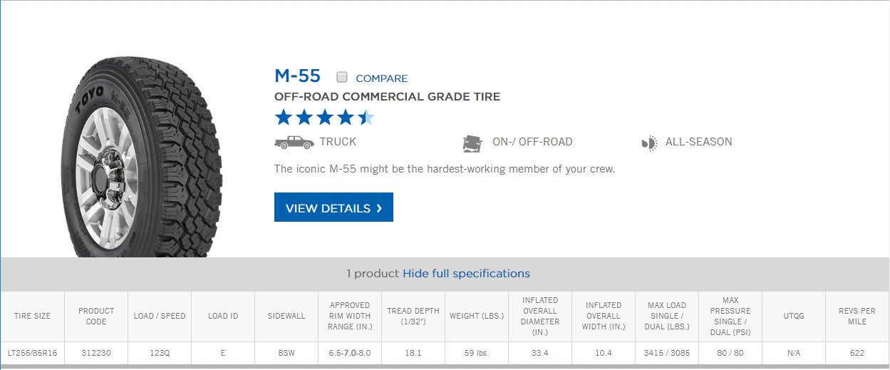

    I don't see the weight listed on the Toyo site, but I'm not super worried about weight. I think people overestimate the effect of tire weight. I have a general understanding of the physics and understand that the wheels add rotational kinetic energy in addition to translational kinetic energy, but the total truck weight is so much more than the moment of inertia of the tire that I'm skeptical that it is as significant as people think it is. The same topic comes up in the bicycle community as well. I could be proven wrong. I have not actually done the physics myself.
    Edit: here is one person that did the math. I didn't check it for mistakes, but he calculated that for a truck about the size of a Tacoma that the wheels make up about 8% of the kinetic energy of the truck. That seems small enough that I'm not worried about a few pounds difference in tire weight; especially since I added 150 lbs of sliders.

    59 lbs on the Toyo site. And it lists them as 33.4" tall. That's a half inch taller than most others in this size. I might investigate these further. I like the fact that they are considered Commercial Grade. I'm not sure exactly what that means yet though as far as LT class tires are concerned but I'd like to think it means a low rolling resistance, excellent on-road mannered tire, that can handle any kind of off road abuse you can throw at it. If it mounts without balancing issues like most more expensive tires it might be worth a hard look. Even if it is expensive.

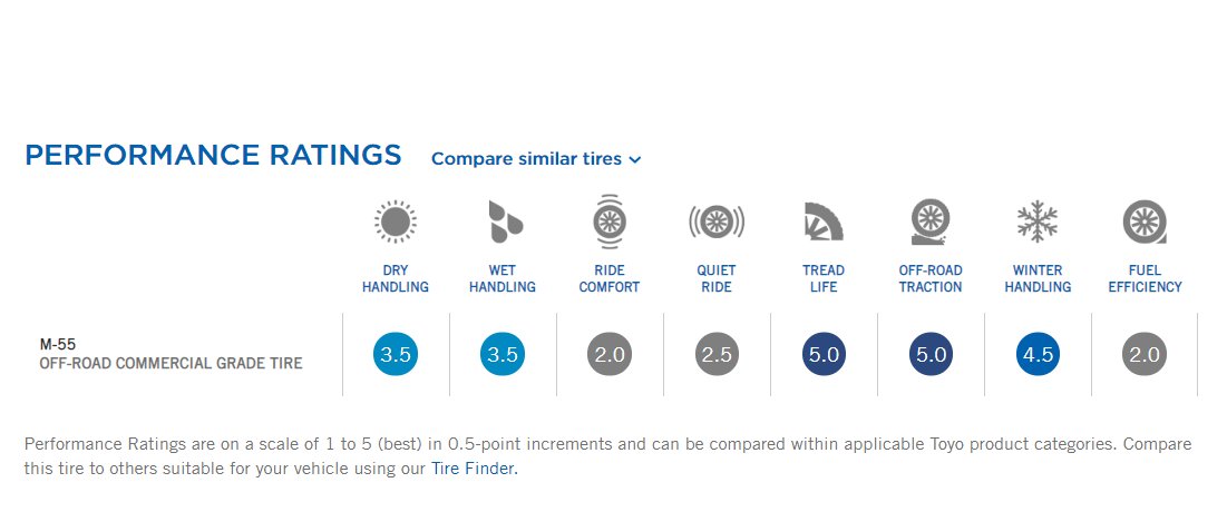

    I wish Toyo's own ratings for this tire were better. Dry and wet are as important, if not more to me than winter.
