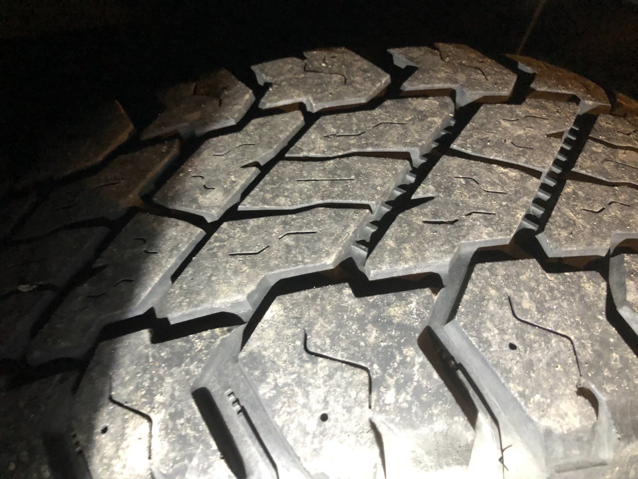

    My apologies I just got on here and saw this a few minutes ago. I went outside and took measurements. Both front and rear measure the same. If I measure to the little bars in between the treads it is 5/32. If I measure to the bottom of the groove it is 9/32. These measurements were in the center treads. This is with 57,000 miles, rotated every 10,000 miles, and inflated to 35-37 pounds. I am not the type of person to dare say these are what you want as I am sure others have not perhaps had the same experience as myself. I can only tell you what I have experienced and yes I would buy these again. I will most likely replace them in the sppring or summer depending on how much I drive it is not my DD.
    Please let me know if there is anything else i can help you with as I understand tire decisions can be a pITA

    Thank you very much Chris! I appreciate it a lot. Great review! 57k is incredible! I've heard nothing but good things about these tires, and it sounds like our habits, and use are the same. I ran the same pressure on the Sport with those Ridge Grapplers. They were an E rated too. I honestly believe that's what helps reduce wear on these lighter trucks. I have seen this tire in person and it's not exactly what I'd classify as an All Terrain tire as Cooper does. The space between blocks actually raised concern when I saw them. To me, the Nitto Terra Grappler, or Wildpeak A/T3 etc, are A/Ts. They call the Duratracs and Ridge Grapplers Hybrid tires. They are supposed to have the characteristics of both. I can only attest to the on-road side. Snow both were excellent with the edge going to the Duratracs. They have more sipes. The S/T Maxx definitely has a similar tread design with the center blocks providing a greater constant contact surface, and the edge blocks providing more grab when needed. They are M+S rated as well. I believe the advantage of the Armor TEK3 will make them a better choice. I know a lot of people run the Duratracs and Ridge Grapplers off road without any problems too, but I want to try something new. Prices are practically the same. Sizes are super close. The S/T Maxx fall in the middle of them on weight.
    I am going to give the OEM tires another chance since they are calling for snow and ice here shortly. If I don't feel safe I'll replace them immediately and sell them cheap while they have low miles on them. Apparently they are a hot ticket item for some 2nd Gen guys. $300 - $400 seems fair to me.
    4 S/T Maxx OTROTD with lifetime road hazard, and rotation will run me $1,121 w/tax. It would be nice to get 5 but not necessary. Maybe when I get a swingout.
    Thanks again!
