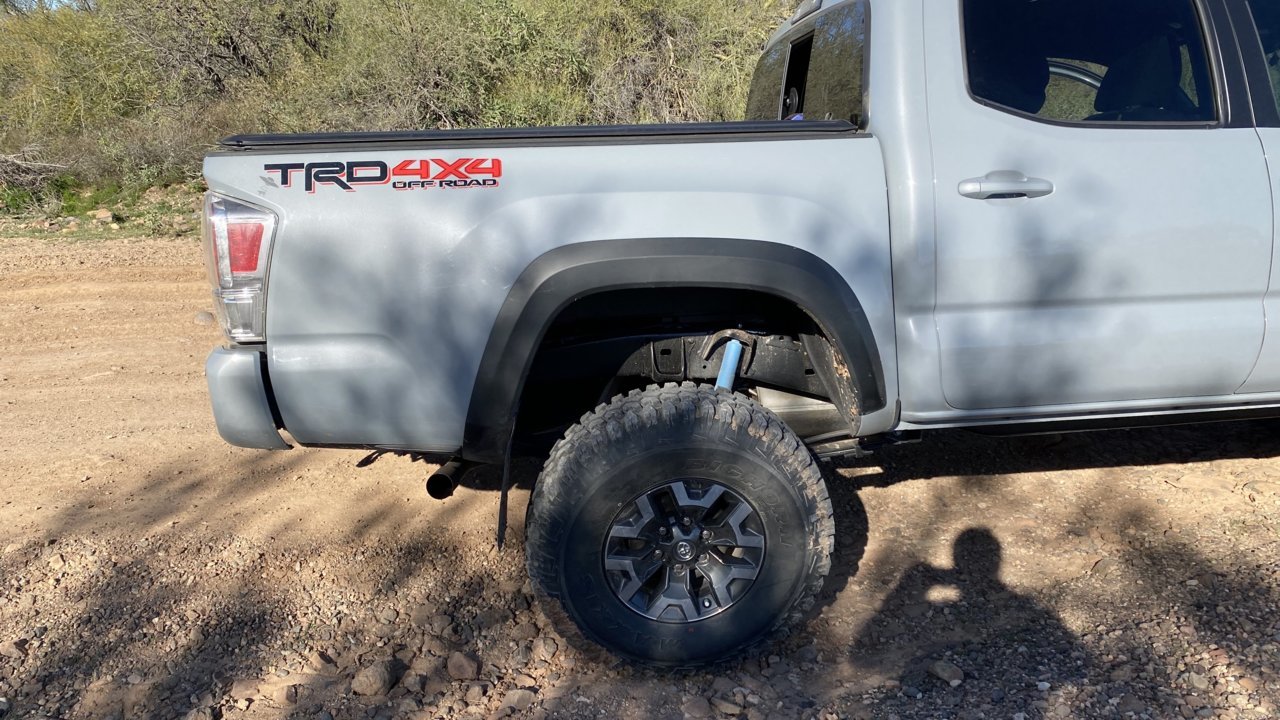

    How much are you lifted?

    Im not lifted. I went with this size specifically because i read these fit without needing a lift

    These trucks are kinda weird. On some you can get away with no lift no problem yet on another it'll rub lke crazy.

    A lot depends on the alignment and how much caster. Those with more caster will have less rubbing. Also, the wheels (back spacing and offset) make a huge difference.

    True even in stock configuration all that plays into effect

    If he's rubbing in the front and not the back either they are too wide or he has too much caster. Knowing there is no lift would lead me to believe there was no reason for an alignment with max caster. So I am going with too wide.
    Post the size again @-_- tumbleweed -_-

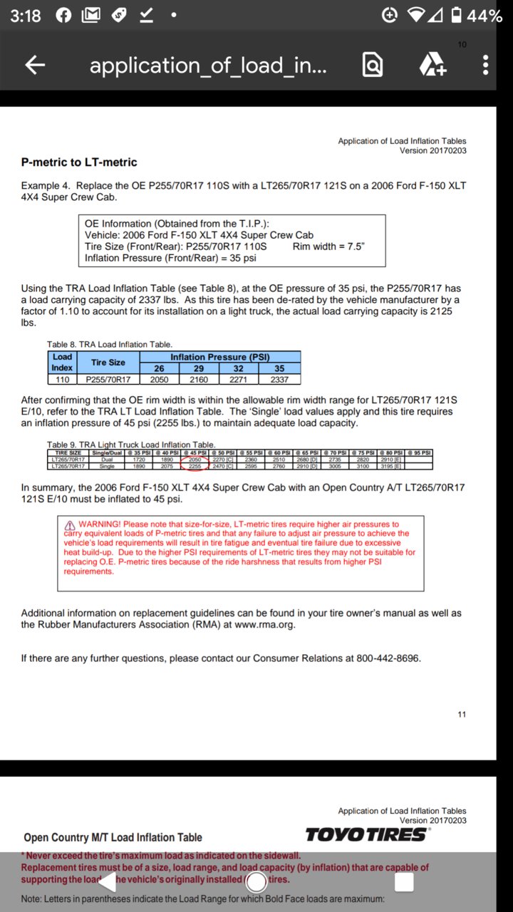

    So the gist of it from my understanding is this:
    Your truck was designed for tires with a specific load capacity, the combined rating of which is higher than the GVWR of the truck (5600lbs truck, tires let's say 8000lbs). I'm sure this is a designed safety factor for overloaded vehicles and dynamic driving conditions.
    Basically you want to equal the OEM tire load rating with your new tires. If the combined rating of your OEM tires is 8000lbs (4x2000lbs), you wouldn't want to inflate your new tires to a psi that only supports 6000lbs, even tho this is over what your truck "should" weigh.
    So, generally speaking what allows LT tires to carry more weight is that they can handle higher pressures. At 35psi a c-load/d-load/e-load have the SAME weight rating, and the same size tire in P-metric is actually rated for MORE weight at the same psi.
    If you look towards the end of that PDF, it has charts of almost every tire size and load, and I'm pretty sure these ratings are regulated so it should be consistent across brands. If your OEM tire has 2000lbs rated capacity per tire, you find your new tire size and load range on the chart. Then you figure out at what psi the new tire is rated for at least 2000lbs, and there you go.
    That's the issue with certain LT tires on our trucks, they need to be run at a psi high enough to equal the weight rating, which may be uncomfortably stiff. Running them below this pressure could lead to overheating and failure of the tire.
    Junkhead and RobP62[QUOTED] like this.
  14. Jan 28, 2020 at 4:54 PM
    #2594
    RocTaco
    RocTaco Free stun!
    Nov 12, 2016
    #202199
    2,055
    Pete
    Green Mtns
    21' SR5 Trail AG
    Example:
    My truck came with P245/75/16 and a recommended cold PSI of 32.
    Looking at that size and psi on the chart gives a load rating of 2,172lbs because it's a P-metric on a truck it gets de-rated by a factor of 1.1, so it's actual rating is 1,975lbs.
    My summer tires are Cooper discover AT3, LT265/75/16 C-load. Looking at the LT chart, the load ratings in that size are as follows:
    35psi - 1,910lbs
    40psi - 2,100lbs
    45psi - 2,280lbs
    So I'd need to run somewhere around 36psi to match the load rating of my OEM tires. Now let's say I stuck with stock size (245/75/16) but in a LT:
    35psi - 1,700lbs
    40psi - 1,870lbs
    45psi - 2,030lbs
    Here I would need to run at almost 45psi to maintain proper weight capacity. Most common LT sizes will meet weight rating at 35psi, but it's important to check.
    mallege and RobP62 like this.

    Pete,
    First, thank you for taking the time to go into detail like this. I appreciate it, and I'm sure others do as well.
    I'm an information junkie, so this is great reading. When I was younger information like this was the farthest thing from my mind. Even though I was an enthusiast back then we just listened to what other people said and followed what they did, no questions asked. This was long before we all had a computer and the Interwebs in our pockets.
    Your information sounds solid, thank you.
    It's going to force me to dig deeper for more though. Not with the intent to discredit that info, rather, I'd like to tell you you're 100% correct.
    :fistbump:
    My mind has been stimulated :thumbsup:

    Thanks. I did give the front inner fender a little snipping, i haven't had a chance to test it out yet but hopefully thats all thats needed
    They are maxxis bighorn 255/85/16s on stock OR rims. They measure to 33.3' tall and 10.3" wide
