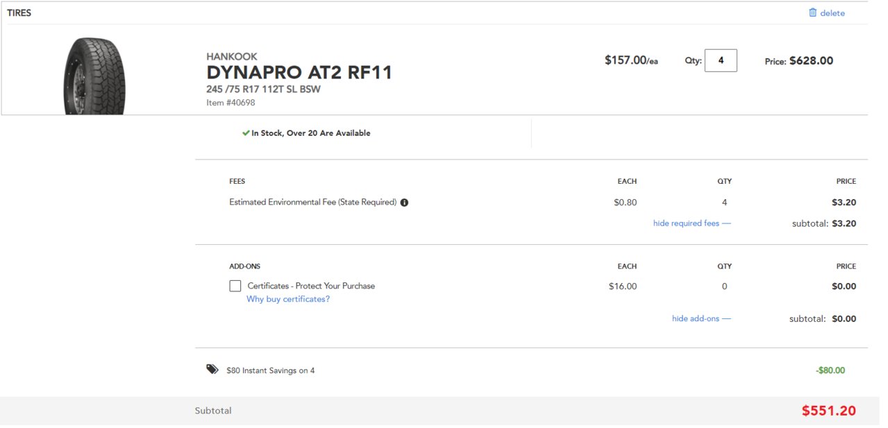

    Wow you sound exactly like me this morning. It took me the better part of the day to understand tire sizing, and I'm still not all the way there. You would increase the middle number to increase the tire diameter. The first number is width in MM, 2nd number is some weird ass ratio that has to do with tire diameter. The third is obviously the inner diameter (diameter of your wheel).
    Now to answer your question, the 255/75 17 is going to be almost 1.5" taller than a 245/70 17. I went through all of the sizing options this morning and settled on a 245/75R 17 FWIW. Got the Hankook Dyanapro AT2.

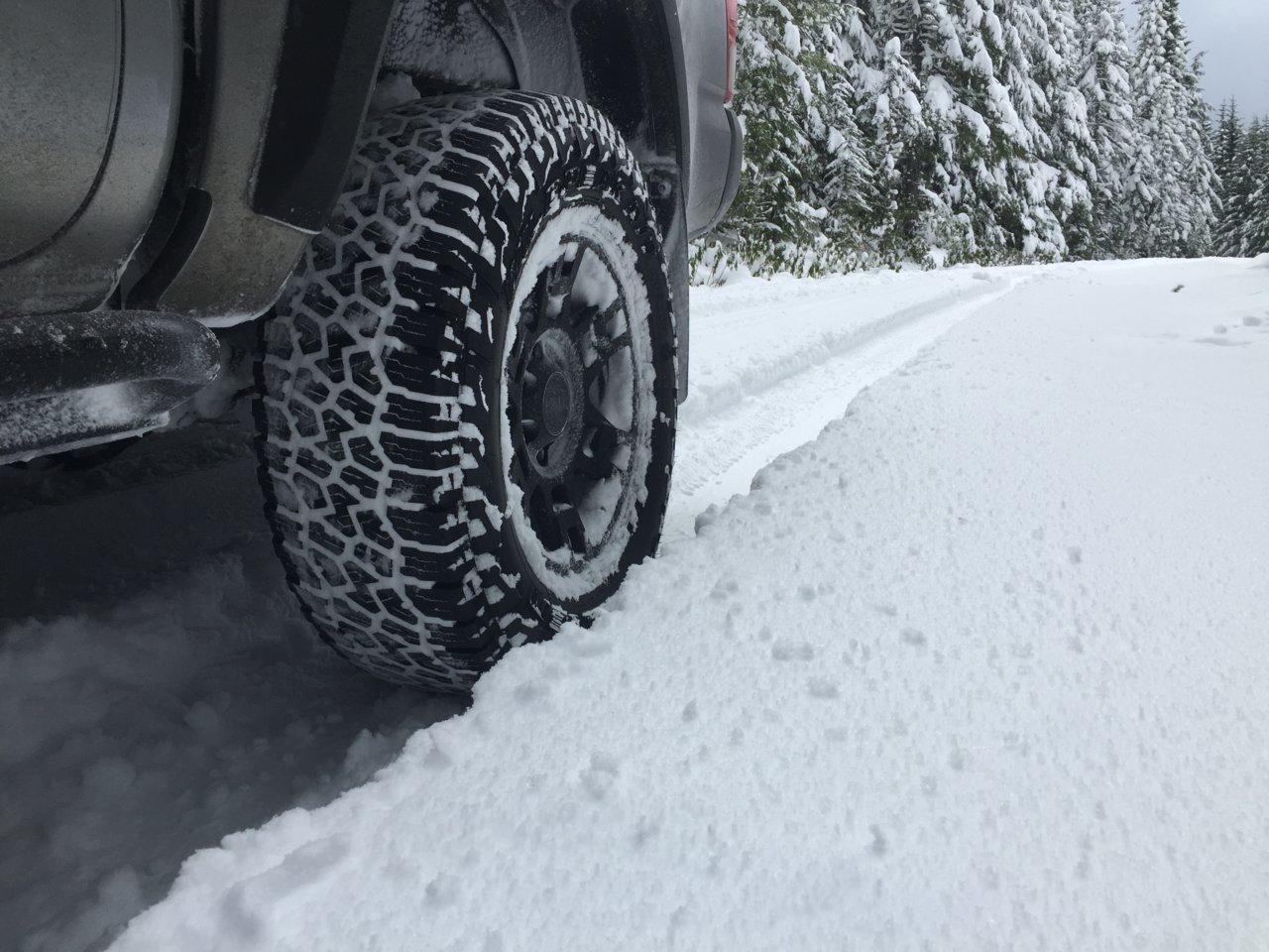

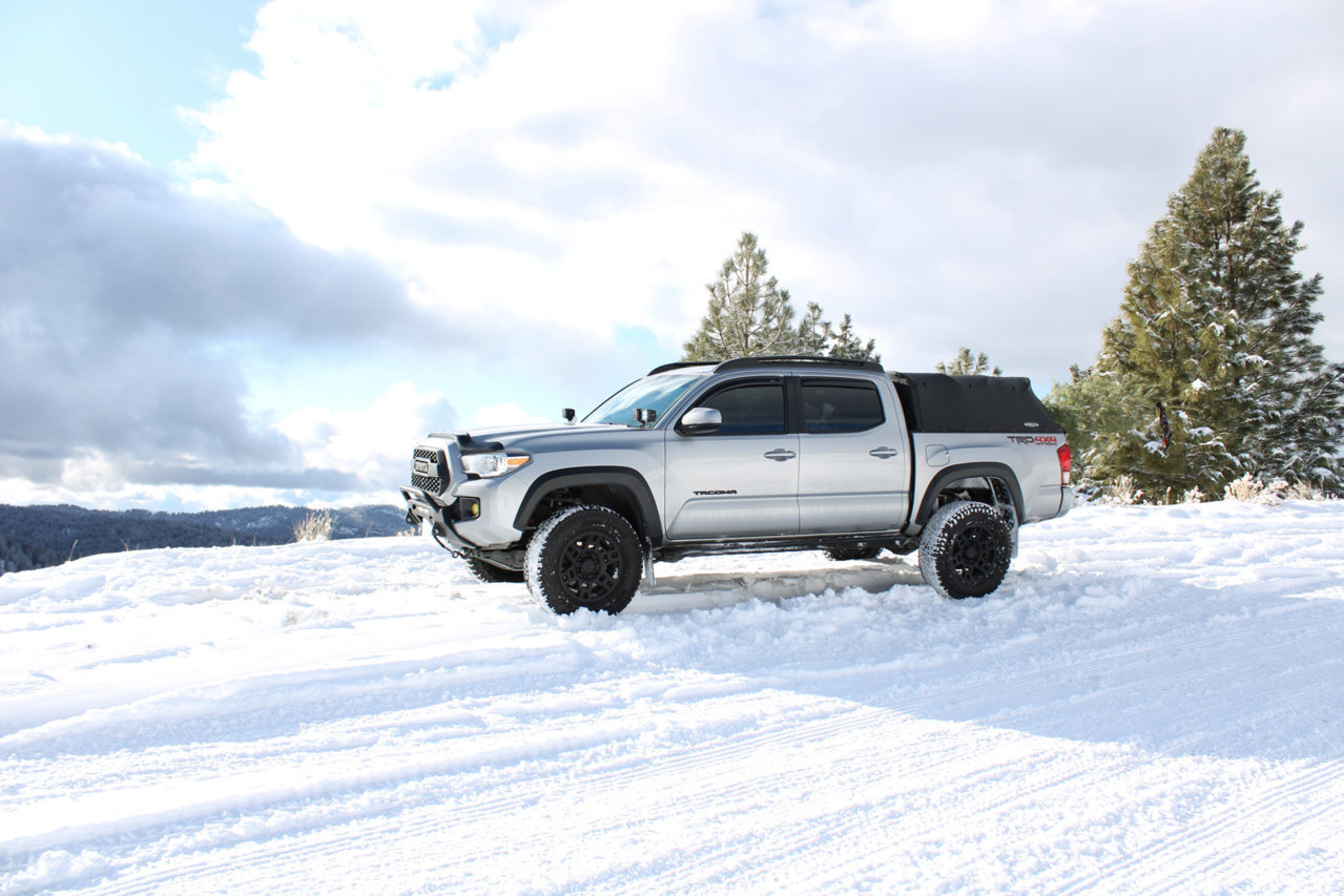

    Falken AT3 at $137 per tire work well. Haven’t got stuck yet. Same wheels you mentioned

    Is that in magnetic grey with the 4Runner Pro wheels as well? That is the exact color, wheel, and tire combo I am going to be running. Do you have a pic of the the whole truck?

    Nope. Silver truck. Black wheels and Softopper

    Nope. I’m just running the 4-ply basic SL.
    Load range C is 6-ply which is more than enough if not overkill for trail riding. Load range E is 10-ply, is super stiff and rough ride, but made for sharp rocks and crawling etc. I have yet to get a hole in a 4-ply that wasn’t caused by debris or hardware on the highway.
    I have even run 4-ply on some mild lava rock stone and was fine (not that I would recommend that)
