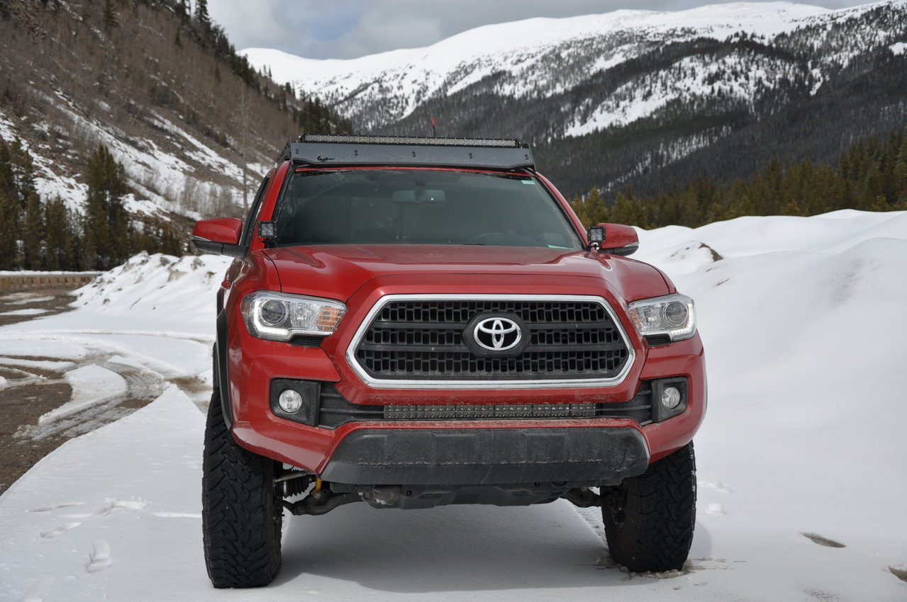

    I have 4.0” backspacing with TC UCAs on 255/85/16 and this is how my stance looks. I don’t rub on the UCAs. This is also lifted 2”.

    Like it. :thumbsup:
    Ray10s?
    LadyRed[QUOTED][OP] likes this.
