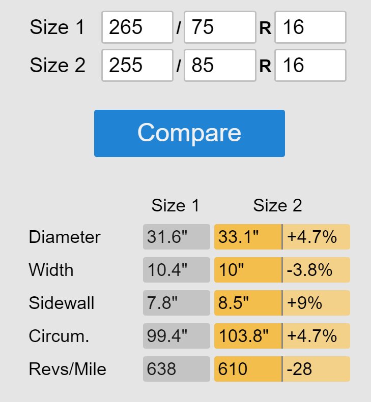

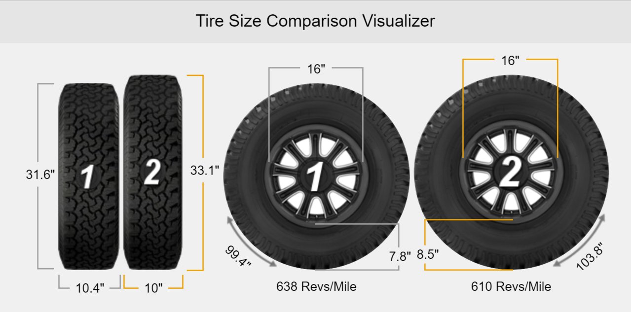

    Here ya go, as requested. :thumbsup:

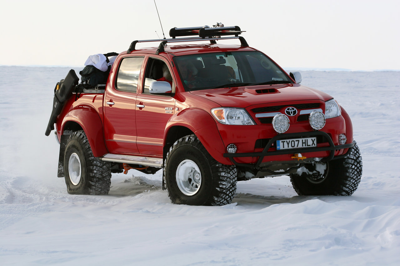

    Bird Dog RVM Bracket, Tint 20% all around, Spider Trax 1.250" wheel spacers K&N Drop in air filter Ram Mount A Pillar (And hard wire charging) Dual 2.4amp Charging USB LED Lower Center Dash Light Center Console Light Trailer plug moved to bumper Tonneau Cover Air Pump Filter Upgrade (UNI Filter) Ultimate reverse light upgrade (Phillips 18161) Anytime Fog Lights Blue LED shift light Nitto Ridge Grapplers 265/65/18
    More surface area on top of the snow always wins. At least in my experience. If you also take a look at purpose built snow equipment, or vehicles; its always the wider and fatter the better. The denser the snow, the more you float.
    Only because its a Yota, sorry to derail.

    Yea, I definitely agree that up there where the hard-pack is ehhh maybe 5' the surface they are going to use the fattest tires they can fit, then, as this guy is doing, air them suckers down until the beads are ready to roll out! I have seen some expedition vids and yes, every one of those trucks had tires like this on them, and some still struggled to stay afloat. It's that same with sand, on dunes.
    However, if I ever find myself in an area with 5' of fresh snow I better be in the hot tub at the ski lodge.

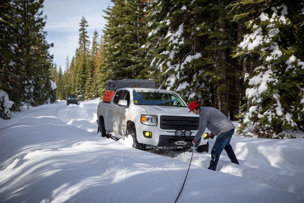

    When the snow is deeper than your ground clearance you want to float on top. Cutting through is bad because you'll sink and get stuck on the chassis/axles. This is why you never want to stray from the packed track when snow wheeling unless you have huge wide tires and can stay on top of the snow. After you "cut down" and break through and have to winch yourself out a dozen times the "theory" starts to make sense. :)
    For shallow snow and on-road snow skinnies are great. Not in this stuff though.
    In these conditions if we strayed even a little off the packed track we'd break through and have to winch. I believe we winched well over 15 times that day/night. I grew to hate that sinking feeling. lol

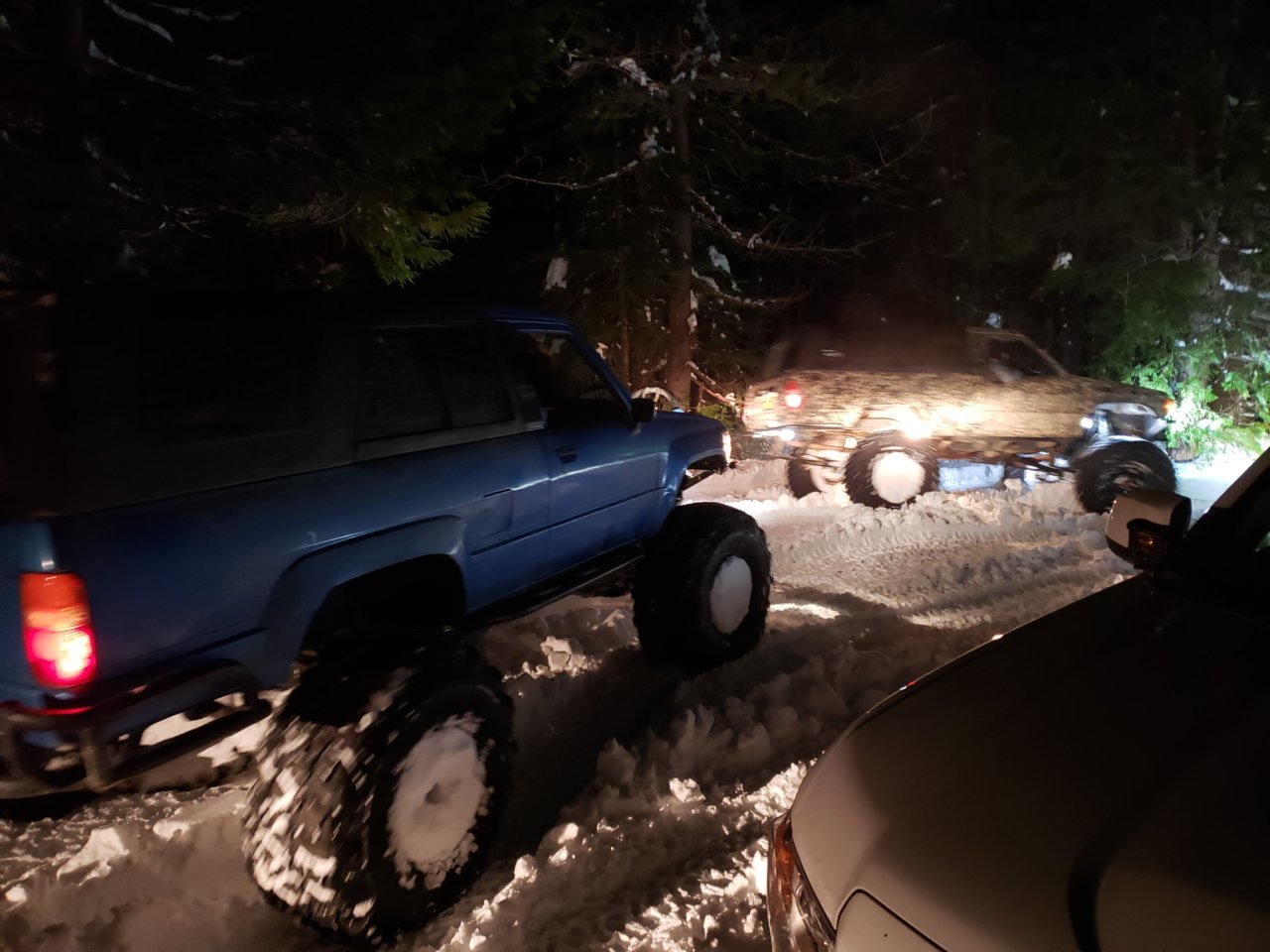

    These are the guys who blazed the path we are on. We ran into them in the evening and they kindly tamped down a camp spot for us just off the trail. Old school 4Runners on 40s FTW!
