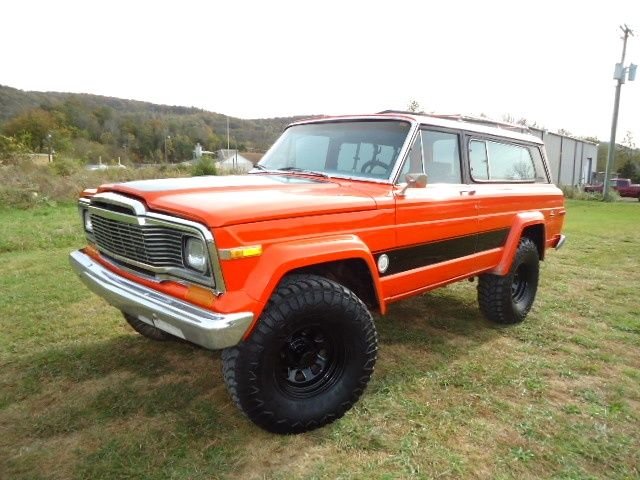

    Pretty much . That actually looked like the type of wheeling I used to do in my 79 Jeep Cherokee . But much deeper mud :D Meaning much deeper mud for me :)
    DrFunker likes this.
  9. Mar 10, 2020 at 3:46 PM
    #2829
    lynyrd3
    Apr 9, 2008
    #5848
    35,597
    Bill
    East Central Upstate NY
    Almost identical to this one . V8 360E05E3CA2-125E-46CB-9EE5-368248410ED6.jpgmine had homemade steel tube bumpers
