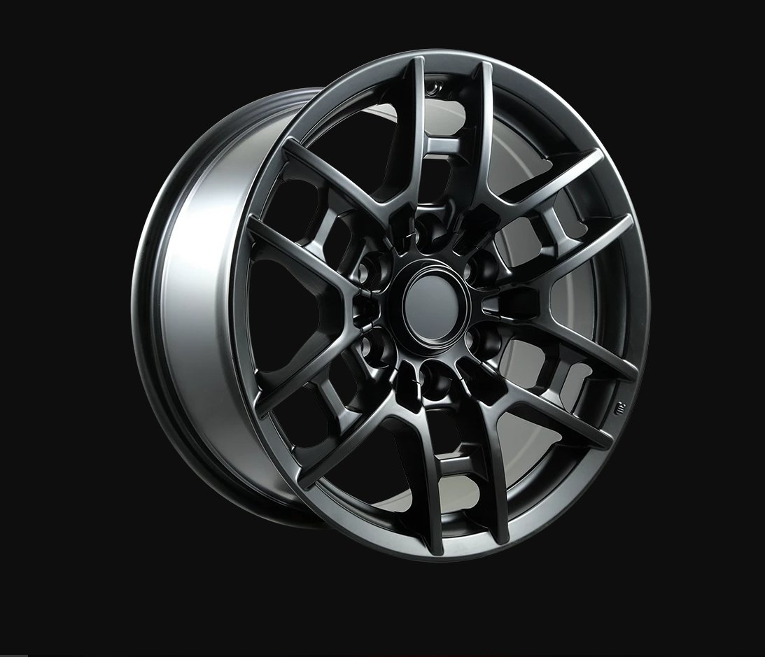

    Here is 4 choices of wheels, three 17x8" and a 16x8"...
    https://wheelsco.ca/products/trdto?variant=31845550784597
    2020 TRD Pro Style replica for $199.75 each $799 for 4 CDN free shipping in Canada (Toyota's 2020 TRD Pro wheel is $330 plus $25 for the center cap)
    These are available in Matt Black and Matt Gunmetal 17x8" +15 offset 6x139.7
    They also sell 2019 TRD Pro Style wheels in 17x8" +15 and 4Runner Pro Style 16x8" +0 and 17x8" +15

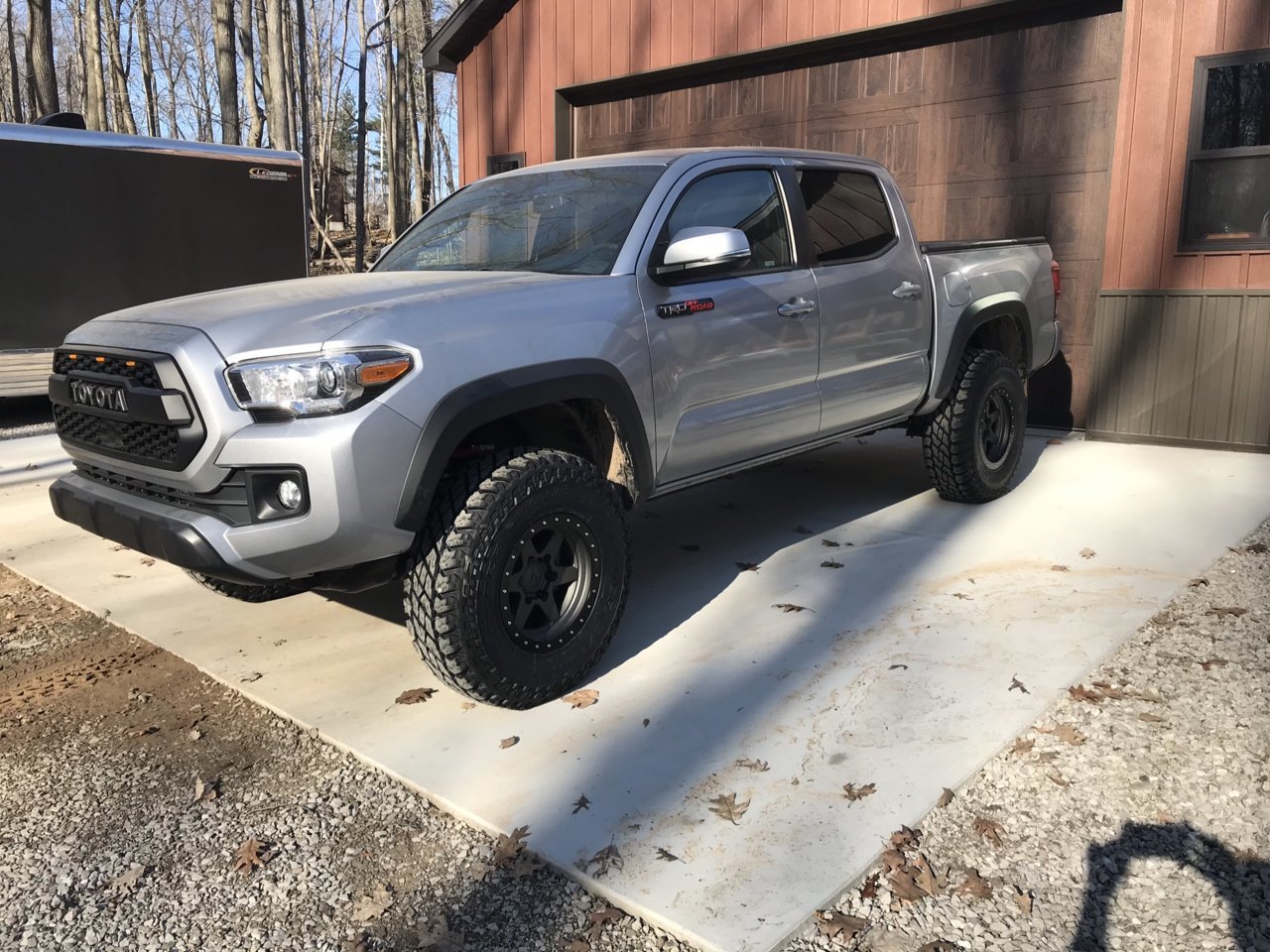

    6112’s 4/5 setting, 5160’s, JBA UCA’s, Headstrong 3 Leaf aal, ECGS bushing, sway bar relocation blocks, SCS BR6’s gunmetal in 16x8”, 4.0” back spacing, -12 offset, 255/85/16 Cooper ST Maxx’s. Waiting for alignment, have some usual rubbing as stated by some and should be able to fix with alignment.

    Looks like you got a small rake out of it too.

    Lifted about 1.5” front and back to keep the factory rake.

    I just did the same.

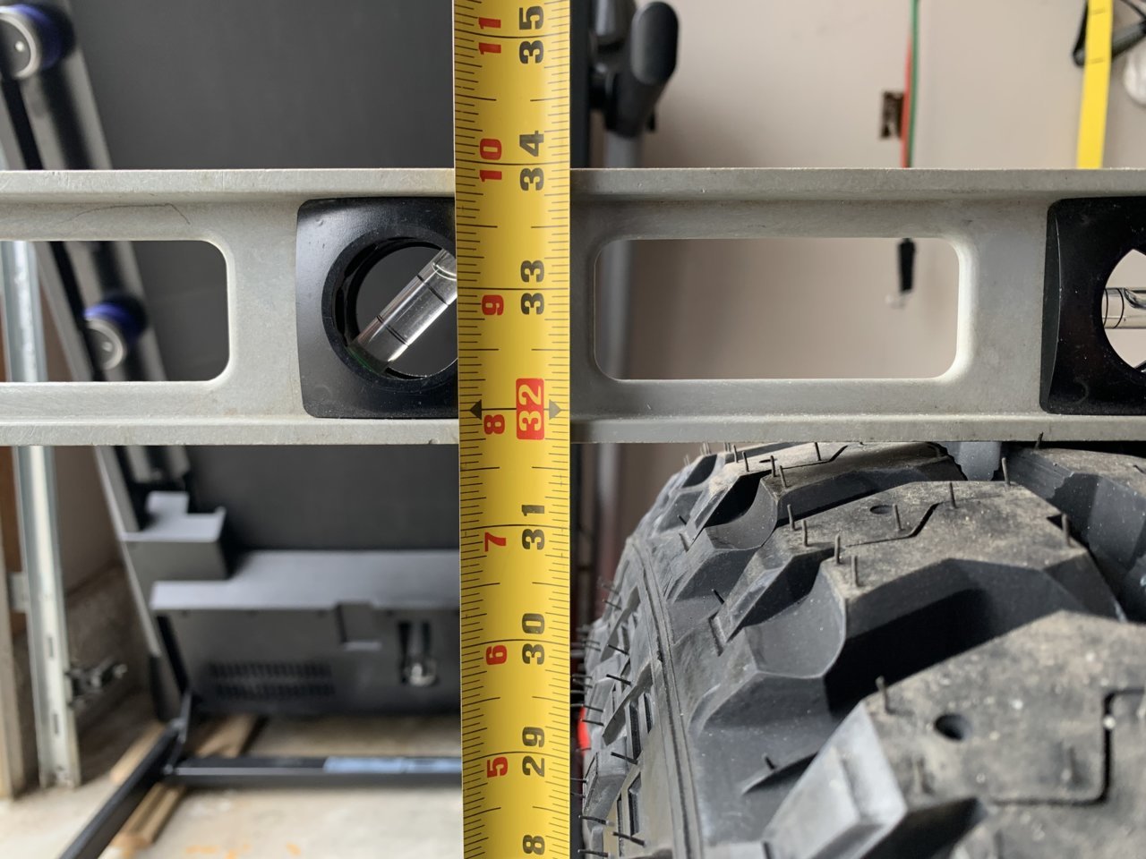

    Feel better? I think it’s trivial at this point. Once they are on the vehicle you will lose .5”-1” as far as height (from compression). Hope they are everything what you wanted
    I just bought some 255/75/17 Hankook and they measure 32.1” :notsure:

    It was fairly trivial the first time it was discussed too. You were actually debating with someone else before. But since you were so adamant that the listed specs were wrong I was just offering the real world measurement.
    Also since Hankook lists theirs as 32” I would expect they measure close to that hight.

    What size tire is being measured? 31.7 I'm guessing
