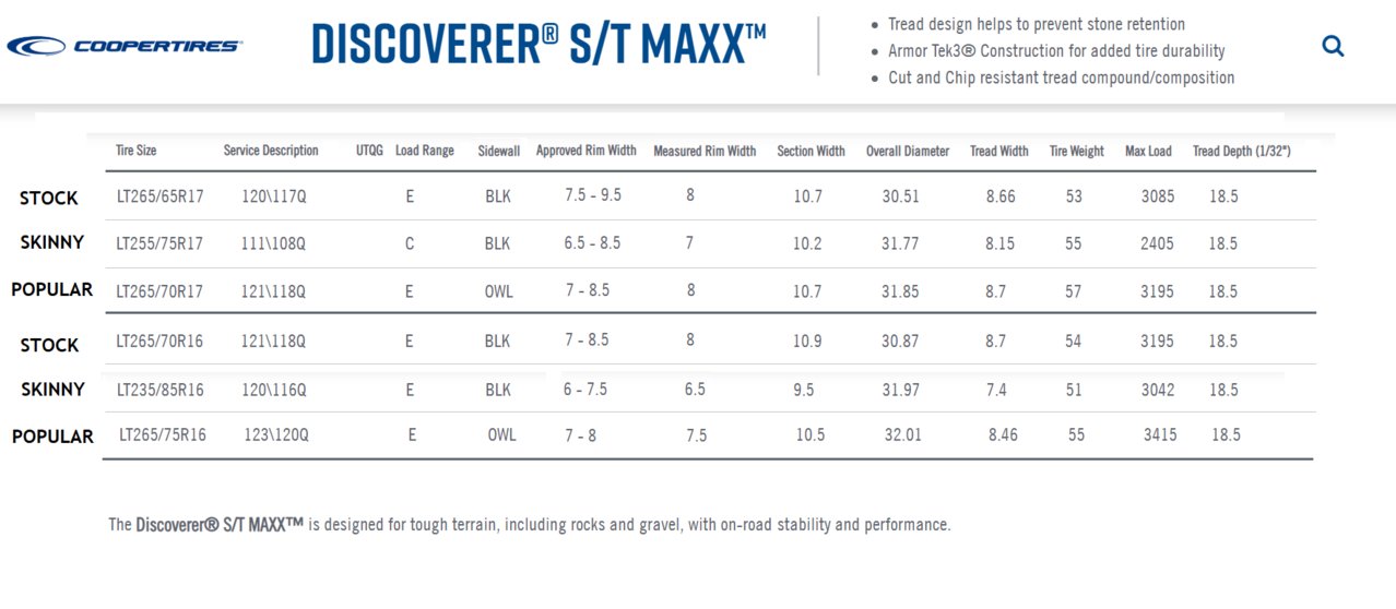

    Interesting skinny tire from Cooper. Skinny is less popular than getting 1 size up. With the Coopers you don't gain much height going for a skinny. I was looking for a little more than 30.7" in a tire trying to get to 32.x without rubbing and cutting on stock suspension. Is it not the main reason to get skinny tires in the first place? Size, Weight and Load.

    So I’ve run 2 sets of 265/75/16s and just put on 255/75/17. They are maybe a few tenths of an inch taller and with the lower profile sidewall I expected them to look smaller. To my surprise I think the 1/2” narrower actually makes them look bigger.
    Compared to a 265 they are lighter load and lighter weight. Cooper says 55 lbs but all 4 tires weighed in at 52 lbs. And they were about $15 a tire cheaper.
    If you’re staying with stock suspension, tire width and wheel offset are going to make or brake you.

    255/85r16 gets you +3 with nearly identical width

    When talking 33's the tire shop is thinking 285's should be on an 8" wide rim but you are wanting 255's approved rim width is 6.5" to 8.5". Just check the tire specs for the tire you want to use.
