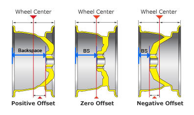

    You said don't run a neg offset when in reality adding neg offset pushes the wheel and tire away from the control arm and frame. You can get away with a + offset depending on the wheel width. but a 0 or - offset is preferred for any aftermarket wheel wider than the stock wheel.
    You should of said don't go too positive of an offset.
    Here is a diagram if it helps visualize

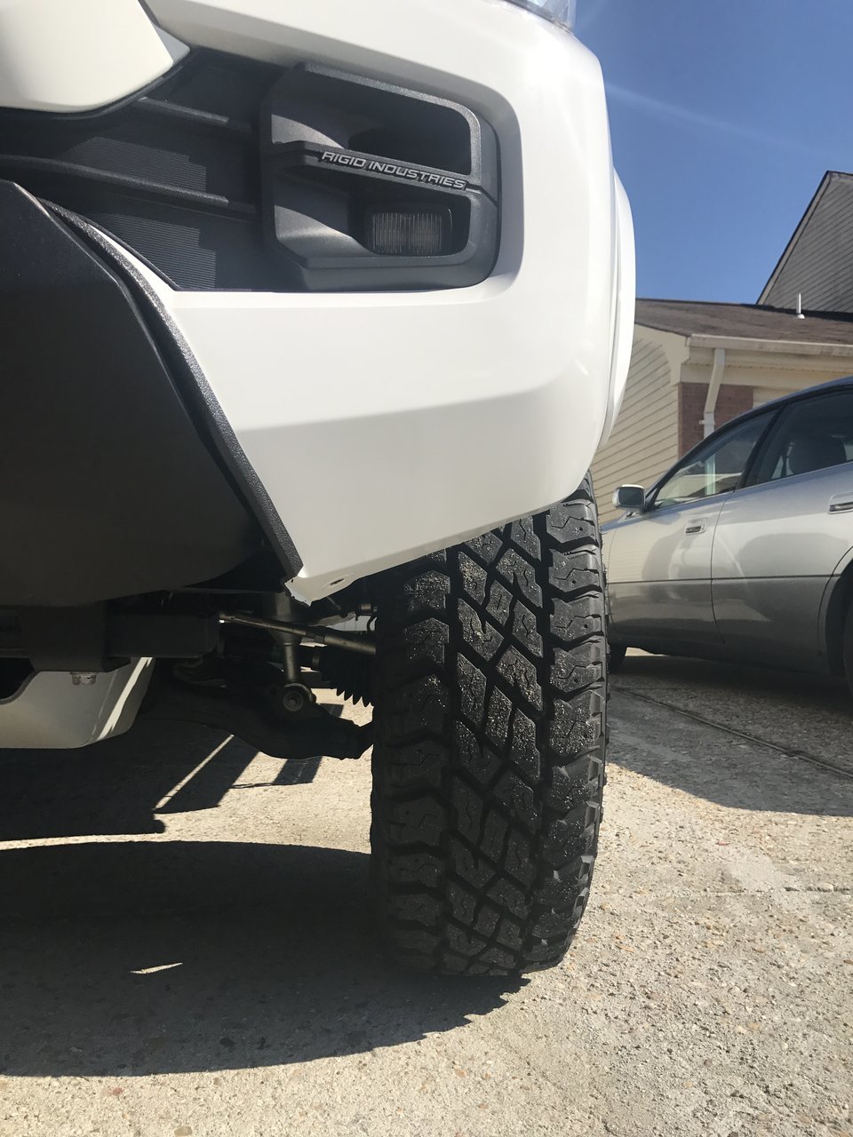

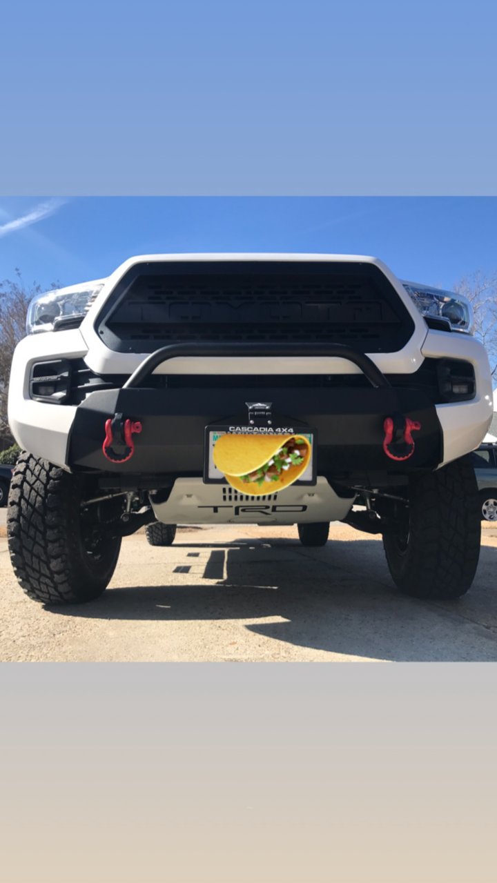

    I think he means you have the corrected backspacing with your rims of 4.5". It is a good answer of using the recommendation from JBA to clear 255 tires.
    Do you have a pic from the front? trying to decide if the tires will stick out too far for my taste with the 4.5" BS or if i need to go a different route with my build.

    Why I never get into offset and BS conversation no idea why I decided to do it now lol....
    As requested
