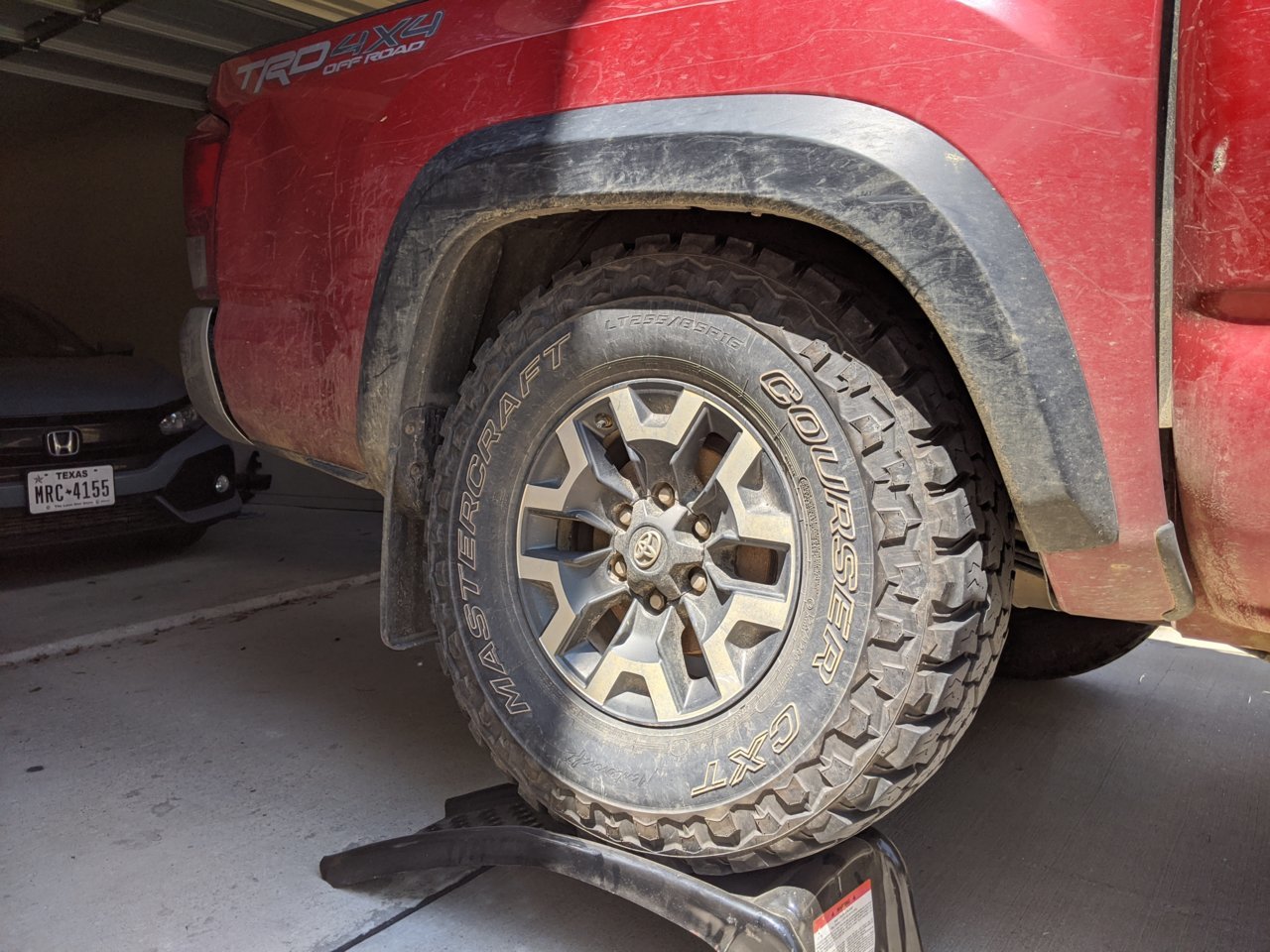

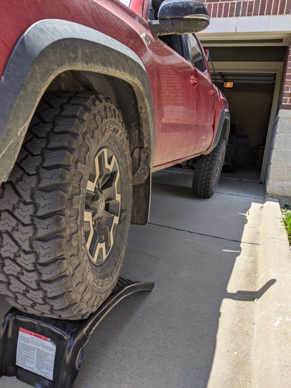

    EubeenHadd
    EubeenHadd Bit of a derp
    Jun 6, 2017
    #220828
    1,980
    Nick
    Indianapolis
    2005 T4R 4.7 AWD
    Encounter AT 32", OME 90021/885+63005/895
    These are the best shots I have, with a little bit of flex to show front/rear wheel well clearance with some uptravel. On a stock rig, the only rub I've experienced is up front when entering parking lots/ramps at an angle with significant steering angle, or braking with significant steering angle. All on the mud flaps. I pulled them off before and fixed pretty much all my rub issues, just had to throw them back on for winter.

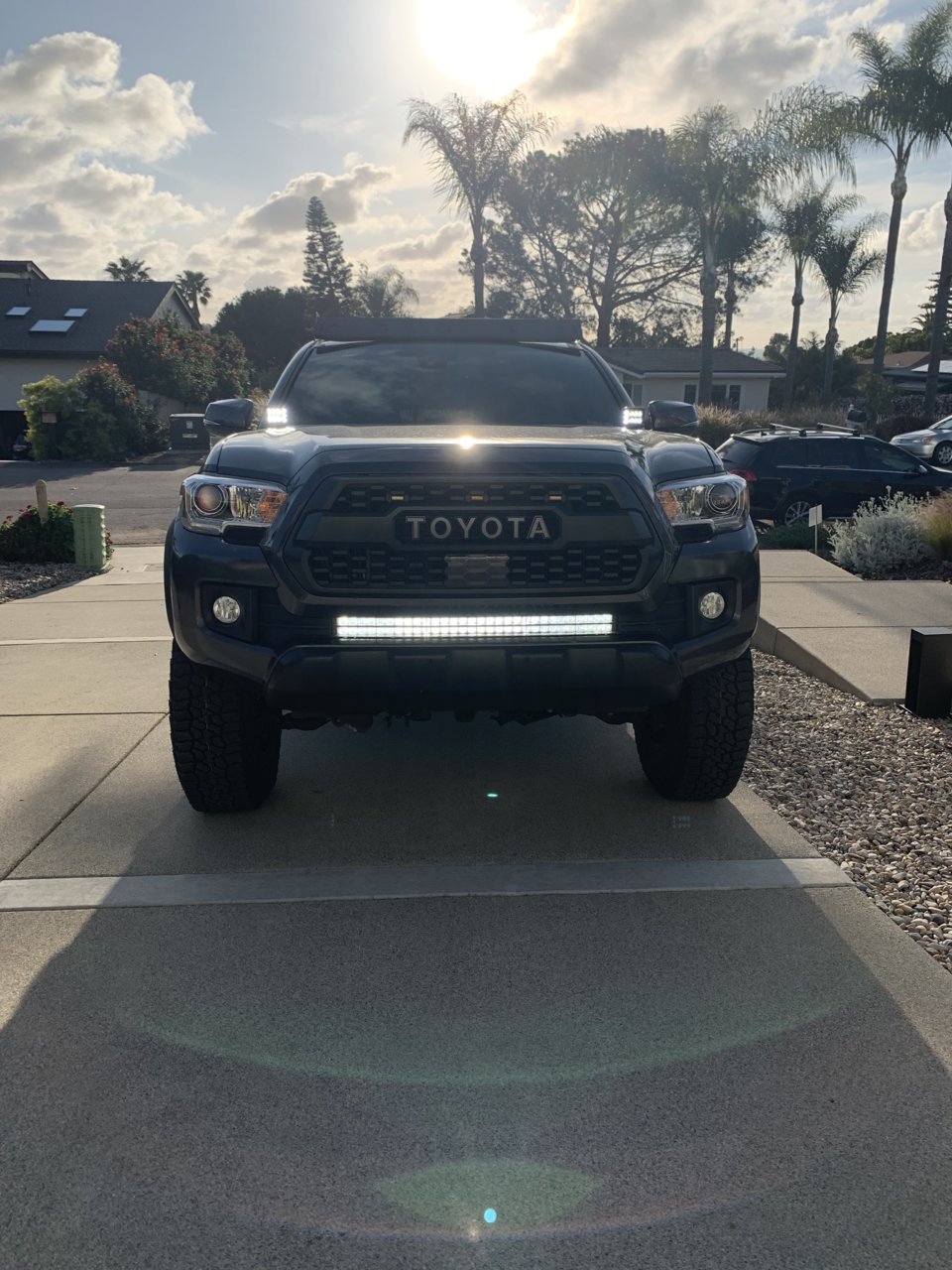

    Jamie4x4
    Jamie4x4 Well-Known Member
    Aug 14, 2018
    #262887
    447
    Jamie
    San Diego
    ‘18 MGM OR 4wd DCLB (Stolen), in market for new DCLB
    255's, 5100s w OME, full Martin Roof Rack, Snugtop
    63103225-3DEE-48E5-A46D-B9AD770FCFA0.jpg Front on with the 255s

    I think since the wheel has a negative offset, you might have a tiny bit of rubbing on a 255/80/17 like I did. Mine rubbed a little bit on the inner front fender when I went over a bump or dip at over 10 mph. It was a super easy fix as I just cut a little piece of plastic out.
