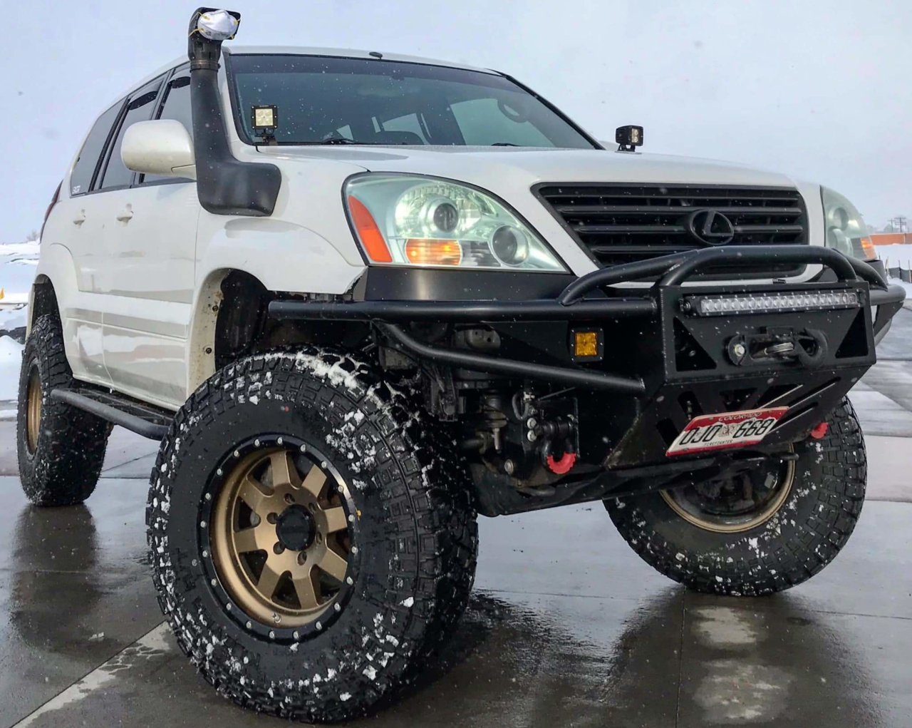

    @Rezkid do you know if they like em or not?
  4. May 19, 2020 at 6:37 PM
    #3104
    Rezkid
    Rezkid Not a Well Known Member
    Sep 16, 2019
    #305481
    1,010
    TJ
    WTX
    '08 DCSB TRD RT
    Little bit of this and that
    Concensus on GXOR is that they are a good tire and hold up well to wheeling. Mind you the GX is a heavier vehicle and does have the added power of the V8 to help move them but I would imagine that they would be a viable option for Tacos.

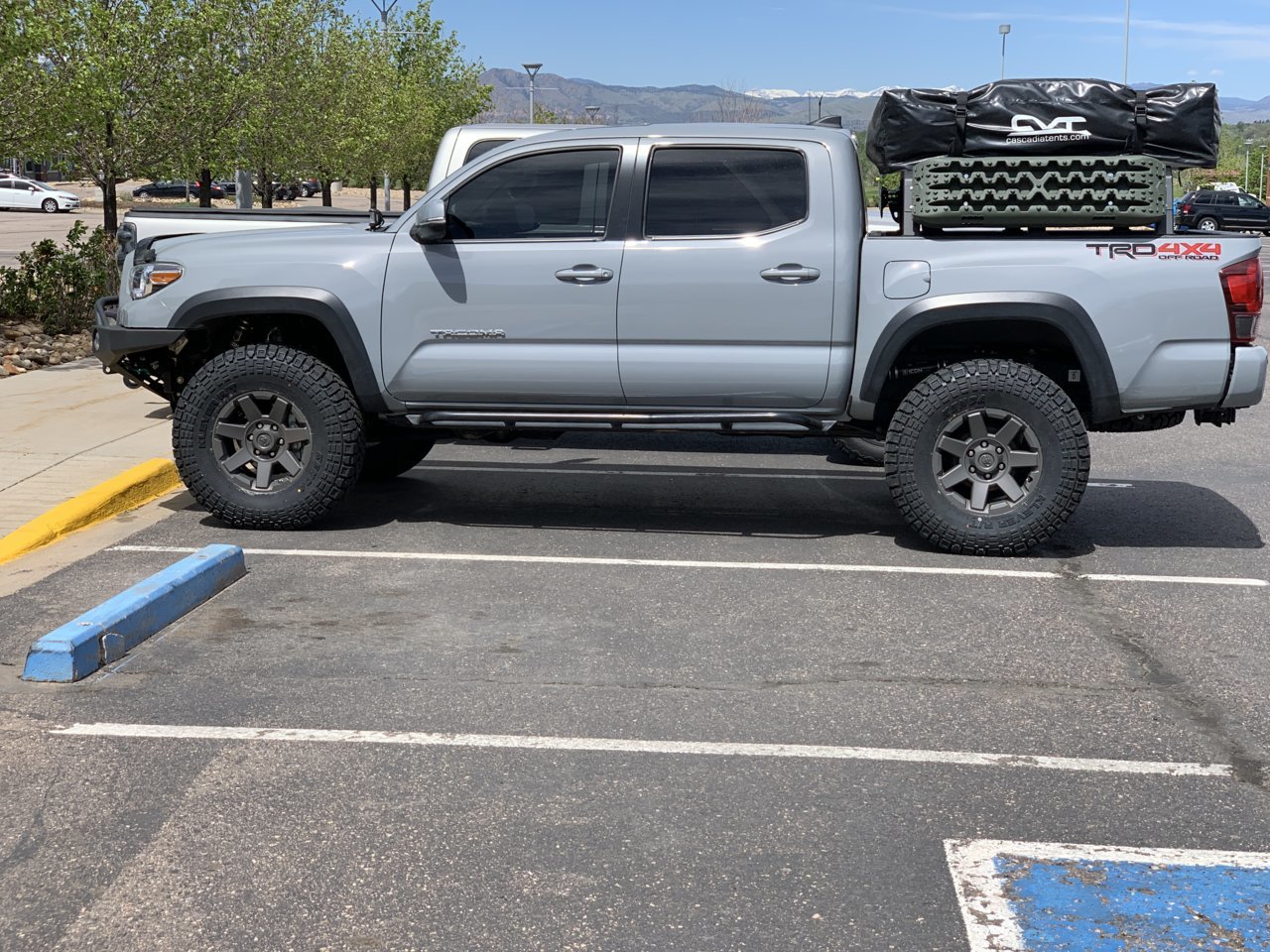

    blake - what lift height are you running here front & rear?
    great looking truck!

    I am running 6112 on 4th notch up front with JBA UCAs and 5160 in the rear with a wheeler's add-a-leaf. It gave me a little over 2" lift, maybe slightly more because the factory suspension was completely shot before I replaced it.

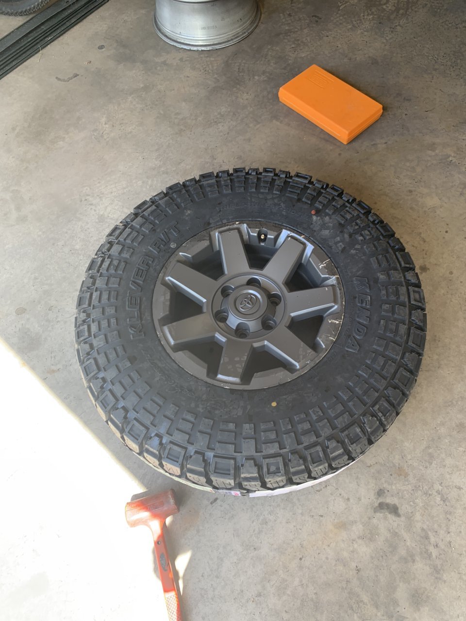

    I got the kendas

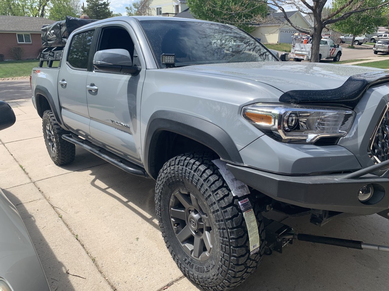

    Some more angles

    Nice! Are those the 33x10.50R17's?

    35x10.5x17

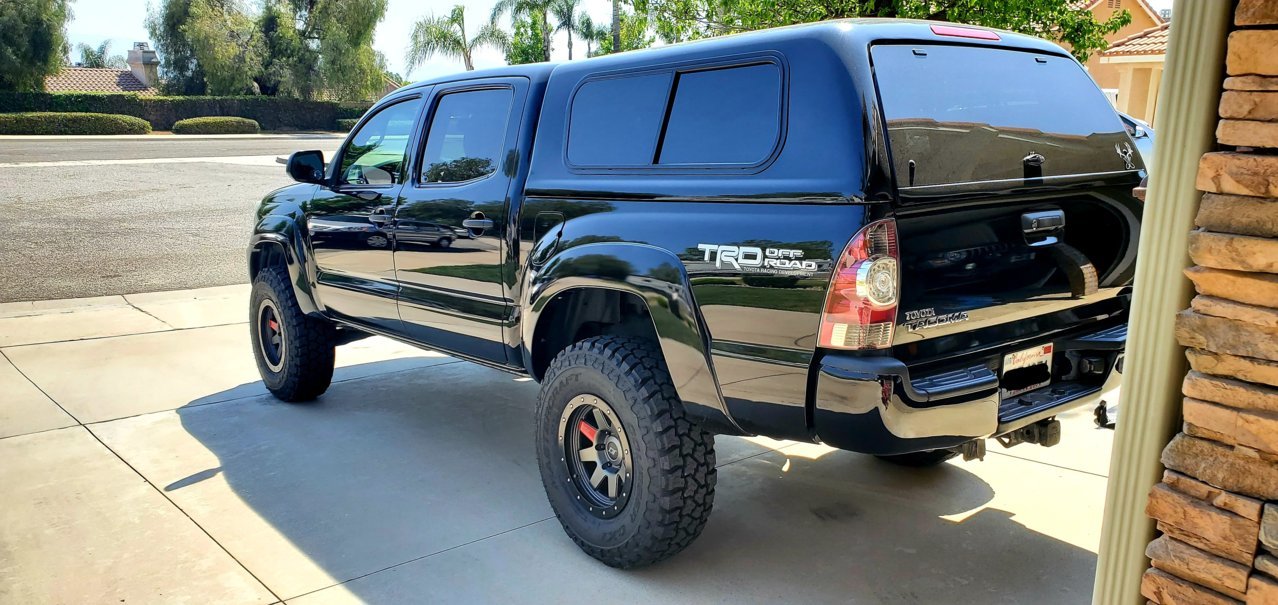

    I was rubbing on the bottom corner of the fender behind the front tires with my previous setup due to my wheels (SCS SR8 16x8 4" BS w/ -12mm offset) so I already had that area trimmed, but I am sure I would have had to do the same with these (went from 265/75r16 to 255/85r16). Other than that I have not really tested it offroad yet so cannot say too much about where and how much it's going to rub, but I have about 700 highway/city miles and very light offroading and have had no issues whatsoever so far. One of these days I will get around to actually cycling the suspension for clearance but just don't have the time to do it at the moment unfortunately.

    Can you show us a pic of the sidewall? Those look tiny for 35

    Second photo is a 255/85/16 in the rear. They’re 2” taller than the 255s. Measure 34.8 off the truck
