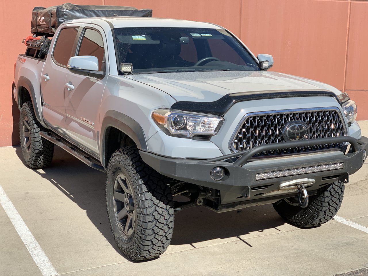

    @1tondriver I just put on 255/85/16 Toyo MTs on my TRD Pro and it rubs on the front mudflaps when making a leveled turn. I do have a front bumper and winch so the front is a little bit lower than a stock TRD Pro. I took the mudflaps off, they still rub along the back fender when taking a turn quickly with any type of actuation in the wheel. Otherwise, no rubbing. I hope that gives you some insight on your TRD OR.
