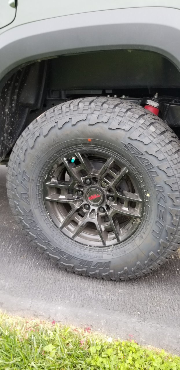

    I have a 2020 Pro and just switched to Wildpeaks 265/75/16. No rubbing at all on or off road, but then again the tire diameter is only 1" bigger overall

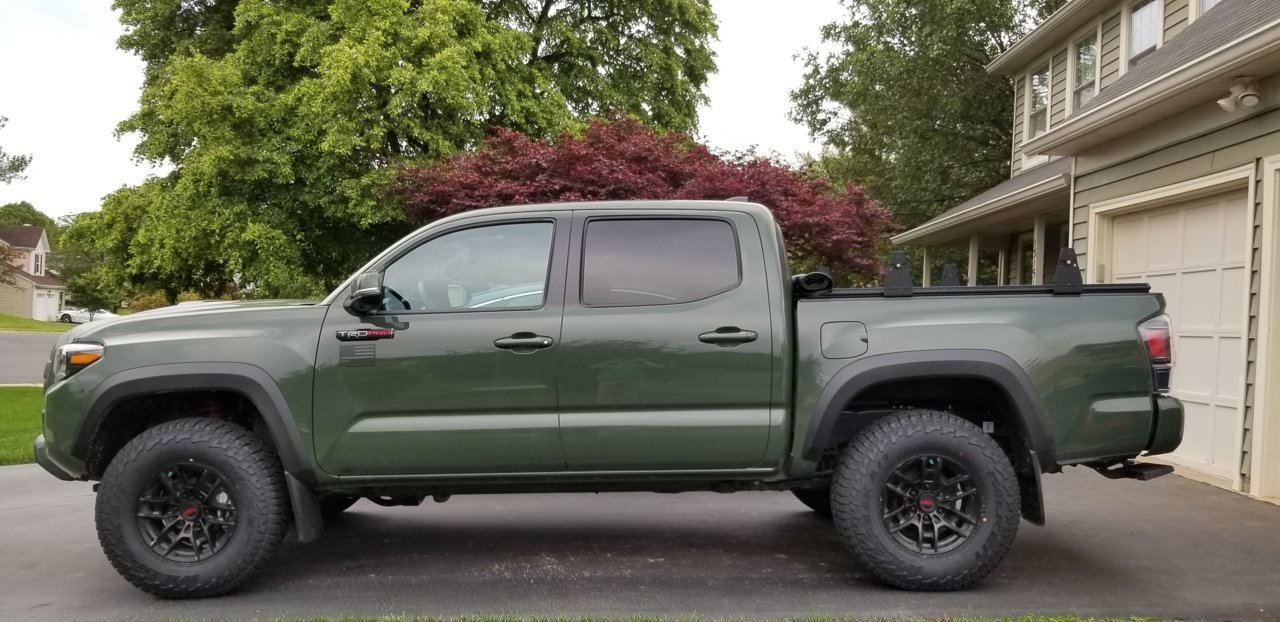

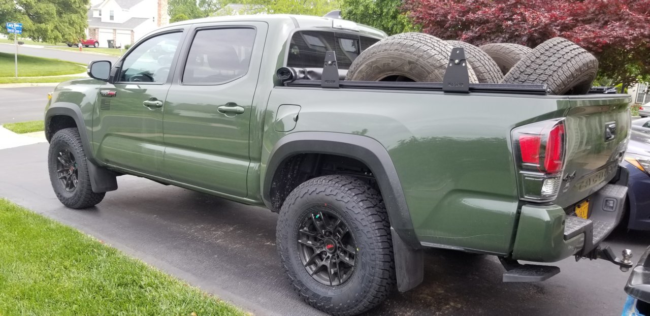

    Beautiful truck. I know the tires are "skinnies" but what size? I'm guessing 255/85 16?

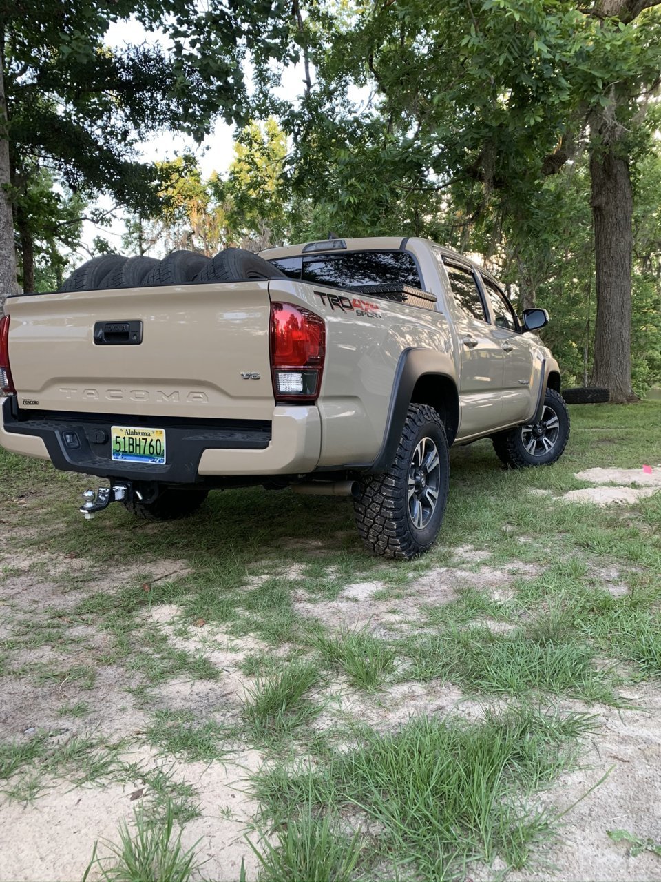

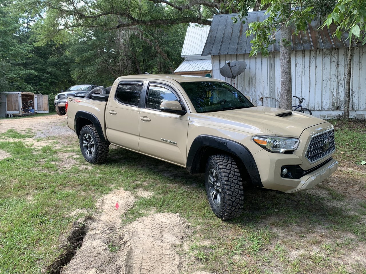

    B74CD15A-9E7C-4BB7-8411-E888FCCC279B.jpg 051FED51-CD4C-48F7-9047-76FC43A380B6.jpgJust got some 255/75/17 BFG KM3s really pleased with them so far although the highway noise is more than I expected.
