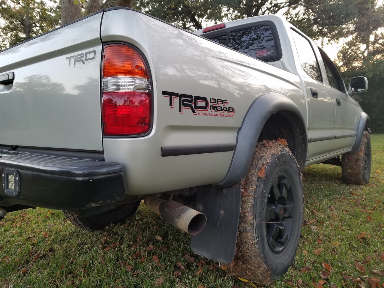

    Finally getting the massive punch list knocked out in a good way.
    *edited for gramical errors.

    Green w/silver looks great! Might go black on the center-cap/rim center hole?
