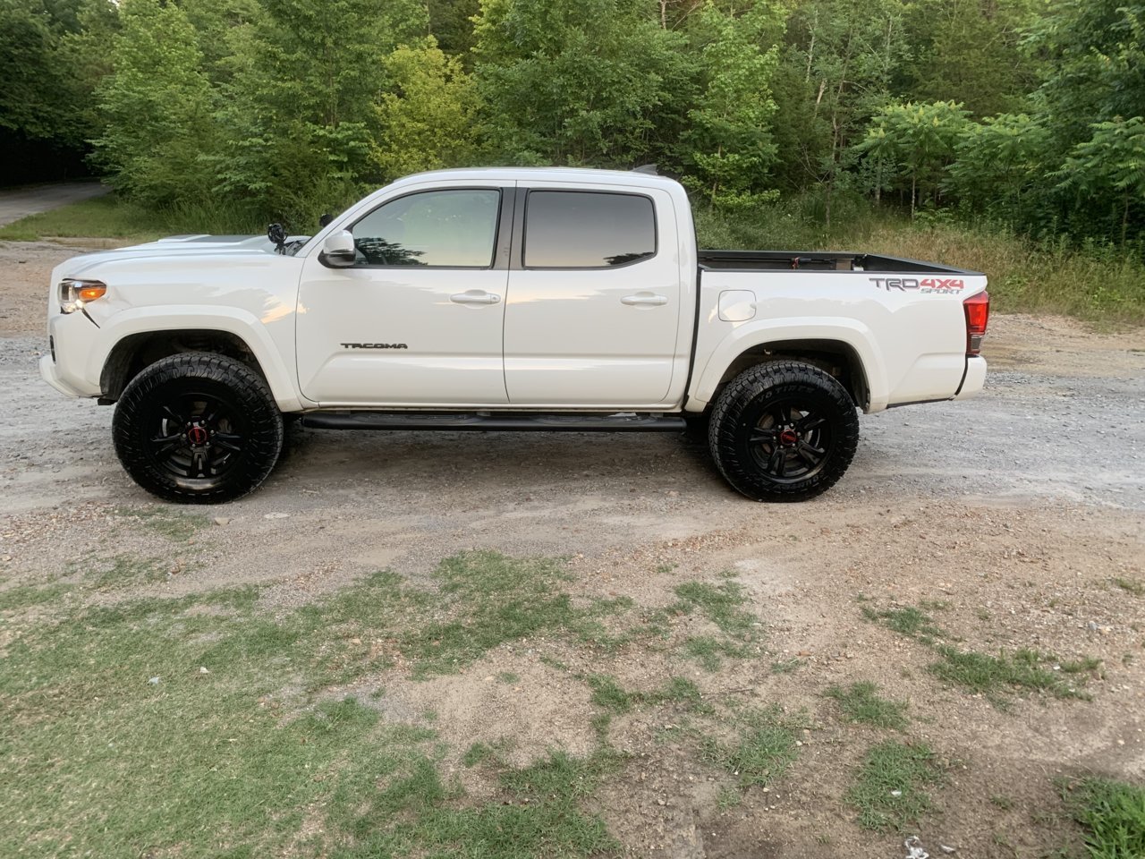

    Just put on some 255-75-17 Duratracs on a stock 2020 TRD Sport today. 32.0" skinny tire, with no lift and no issue. Local Discount Tire store took care of me today. No clearance issues as it sits. I am going to do a post with the details and more pics.

    Did you paint or powdercoat the wheels? I like em.

    Thanks. They're painted.

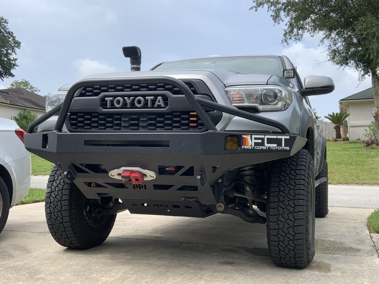

    LT255/80R17 Falken Wildpeak AT3W Bilstein 6112 front coilovers Bilstein 5160 rear shocks JBA UCAs OME Dakar Med Leaf Packs Rigid DSS-PRO ditch lights At The Helm Fab front bumper Dobinsons Snorkel ECGS bushing
    I am currently running SCS 17x8.5 -10 with my 255 Wildpeaks and love the way it looks a lot more than the 17x7 +4 pro wheels I had.
    This is with the 17x8.5 -10

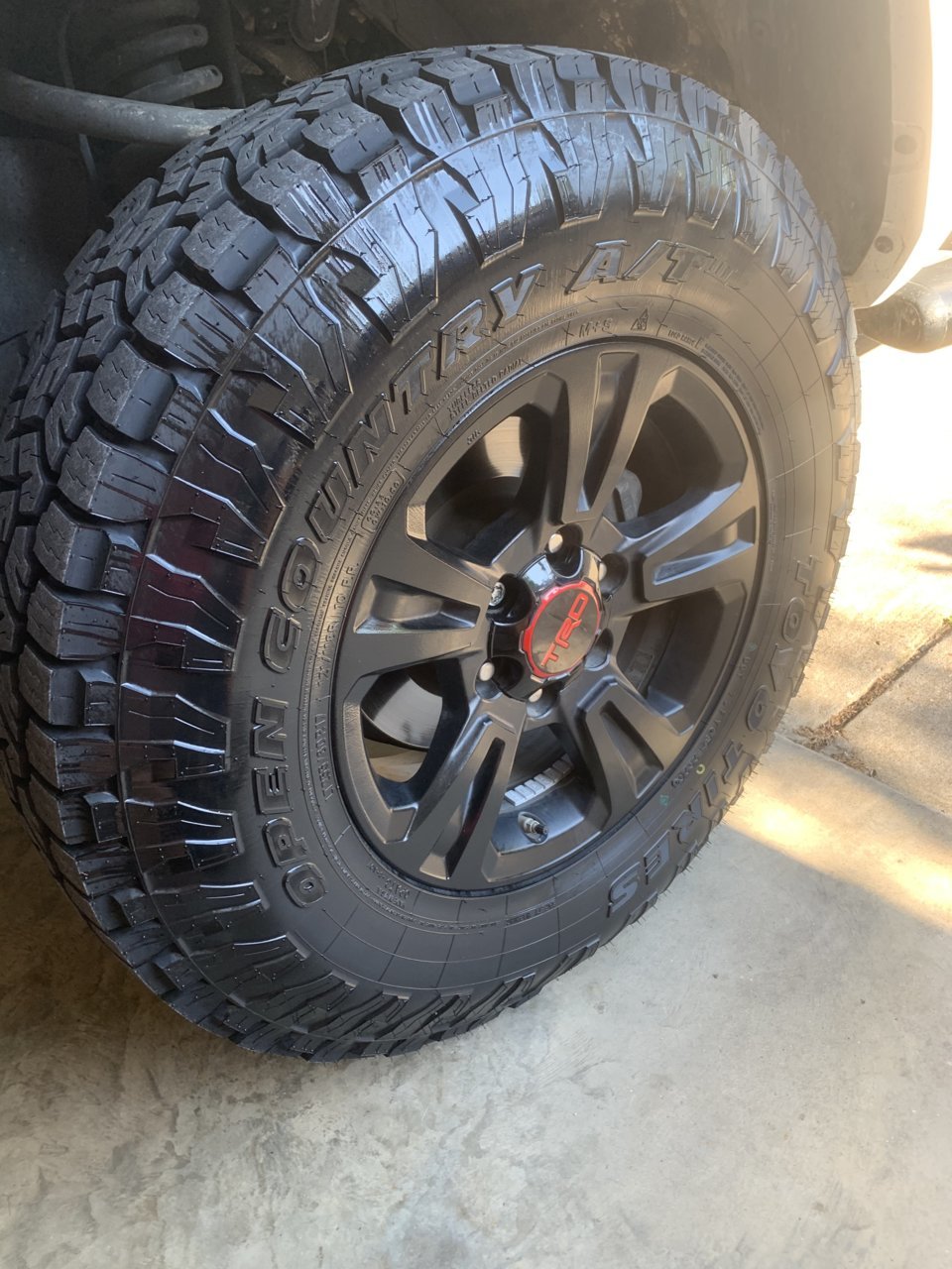

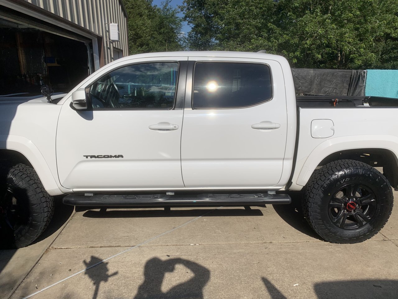

    A5703F06-CF41-45C1-A779-4FFF5DE28E82.jpg 2D2D86D0-55B2-4768-9A9A-F3929220A2D9.jpg C1A1ECD4-F7F2-408B-BBCF-7D18B62C62F1.jpg 77080501-BB95-47B6-9E82-E0C05EB196D0.jpg I went skinny for first time today with toyo open country AT3s in the LT255-80R17

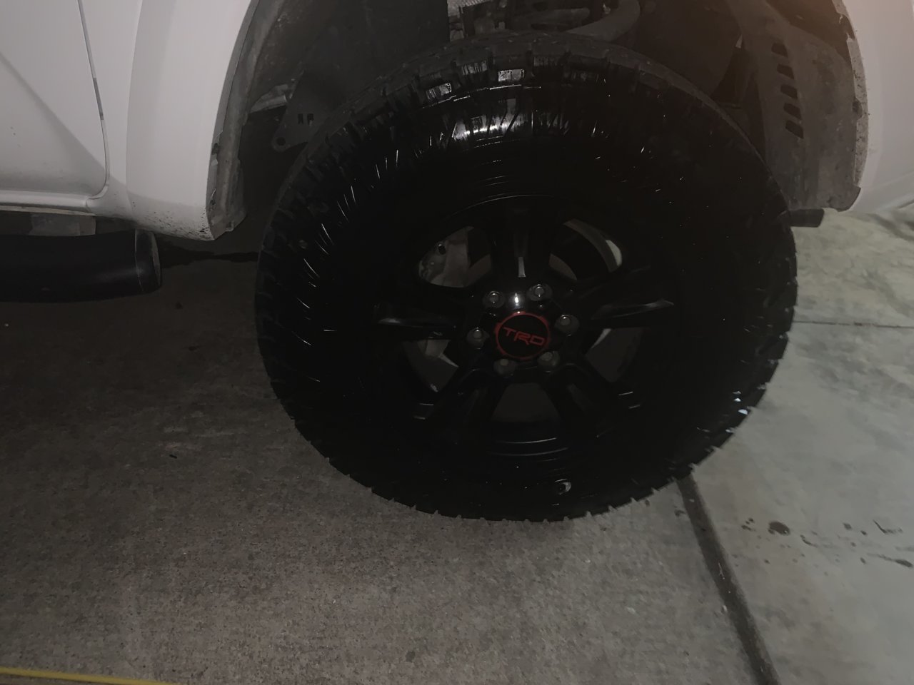

    Alright after a day of measuring and remeasuring, it looks like even 255/75/17 won’t fit. Is it possible this is because my suspension has settled too much? Pretty sure it hasn’t been replaced and the truck is at 144k.
