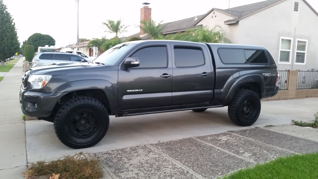

    Finally pulled the trigger

    Looks really good. How big of a lift are you running? Did you get any rubbing?

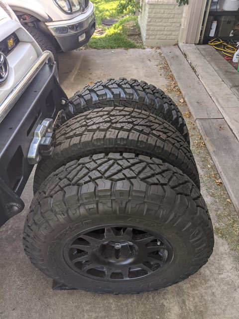

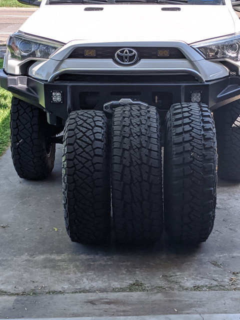

    two skinnys vs a 315 75 16..
    Nitto 255/80/17 < vs Pro Comp 315/75/16 < vs Goodyear 275/80/17
    Pro comp spec is listed @ 34.6" the same height as what Goodyear list the MTR's All three of these tire are new and mounted....
    1_e0271b93bf4ec5277bd9a4af63b1fb2350a284ef.jpg2_f1ed2841ecc80c59c489fc23d3187db6354a1b7e.jpg
    The Nitto's above are the same height as the Toyo 255/85/16 MT's below next to the 255/80/17 Cooper ST Maxx both of these tires also have zero miles. This shows how some tires run big and some run small....

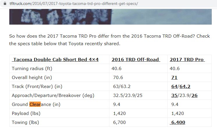

    I'll continue to edit this post so there's not too many new posts when I gather more. But here's a table of measurements taken as well off a 2017 model PRO and OR. Notice the total height difference too.

    That’s because the tires are the same size. Ground clearance at the differential will be exactly the same. Tall skinnies add ground clearance at the differential. They are 2+” taller.

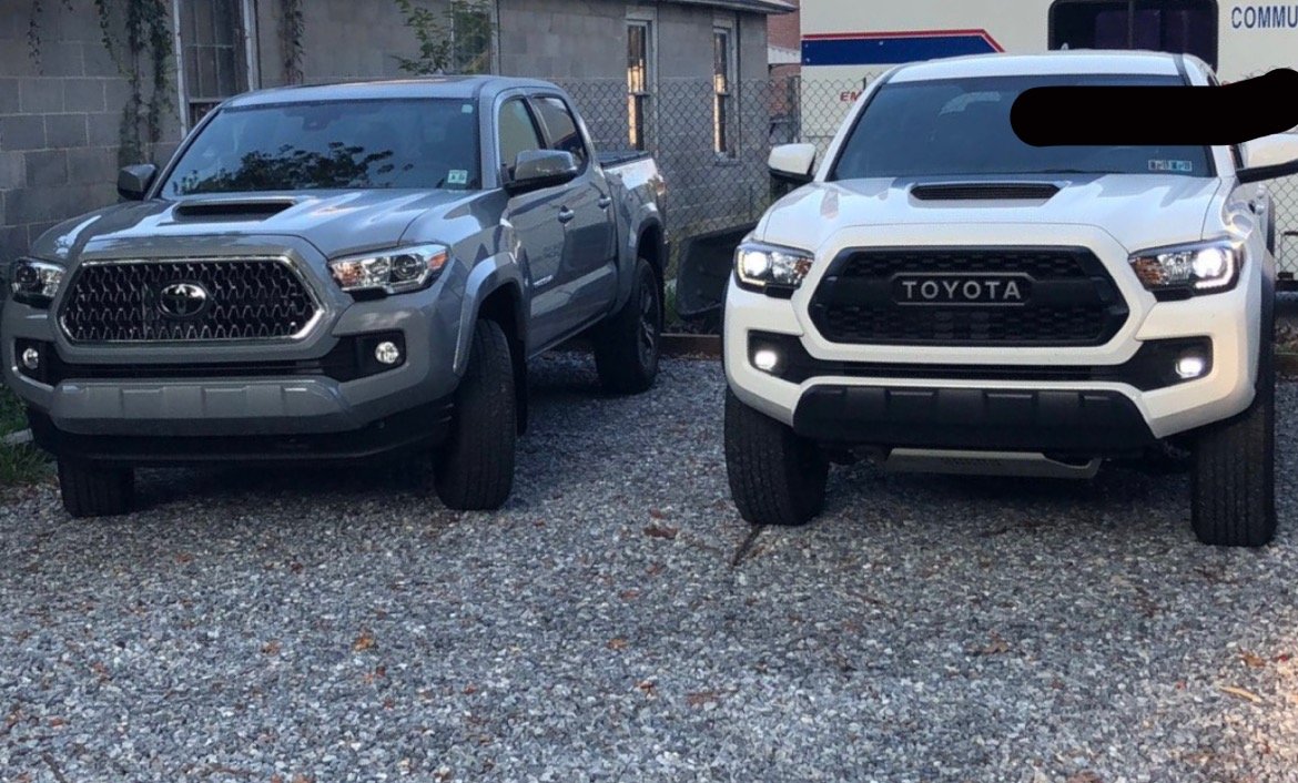

    if the tires are the same size stock, on a stock 16" wheel, and the overall height is .4" difference, there's no 1-2" lift. Currently at work but I'm looking for a picture of mine next to my friend's stock sport next to a stock SR5. I'll find it eventually.
    Edit: Sharpish I get what you’re saying now for ground clearance
    And, all I'm saying is I've never noticed a lift difference next to other stock models. I'm not saying I'm right, but I'm definitely not saying that they're lifted.
    Yes we’re on gravel, yes the lot is even. Next to a 2018 TRD sport. I’ve been up close in between the vehicles and didn’t see a difference in height at all. May not be the best pic but if there’s a 1-2” lift in there, it’d be noticeable.
    I hope I am wrong I could use the extra height, but like I said I just don’t see it. This week I guess I’ll take a tape measure to the dealership and compare lol.
