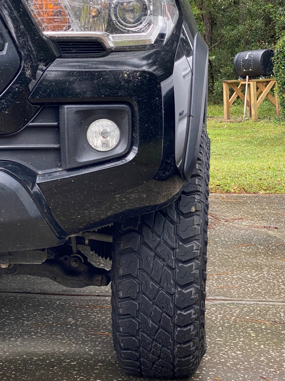

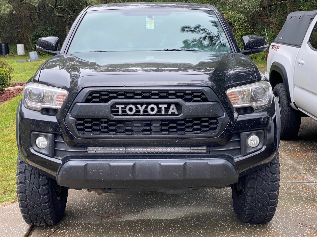

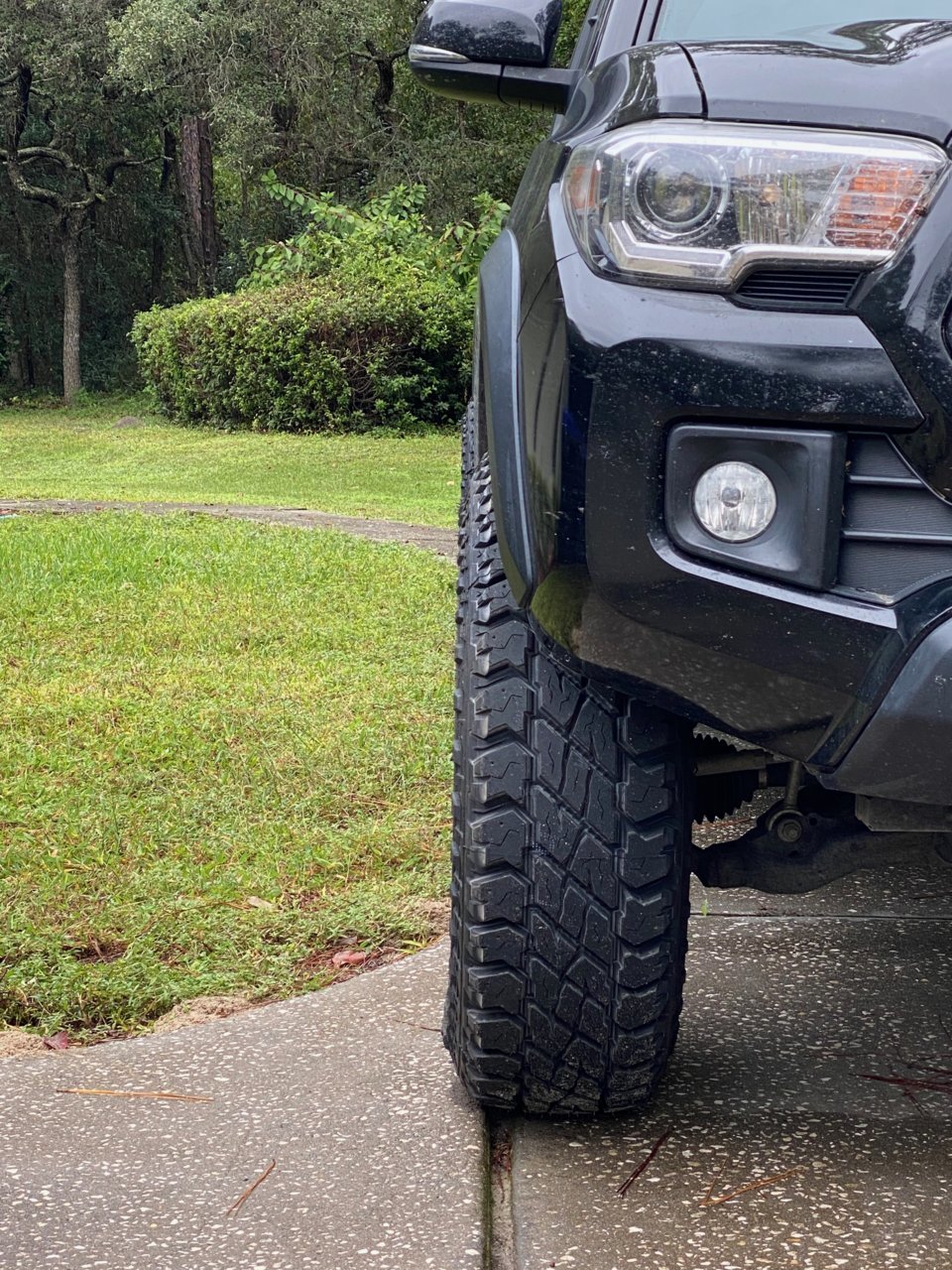

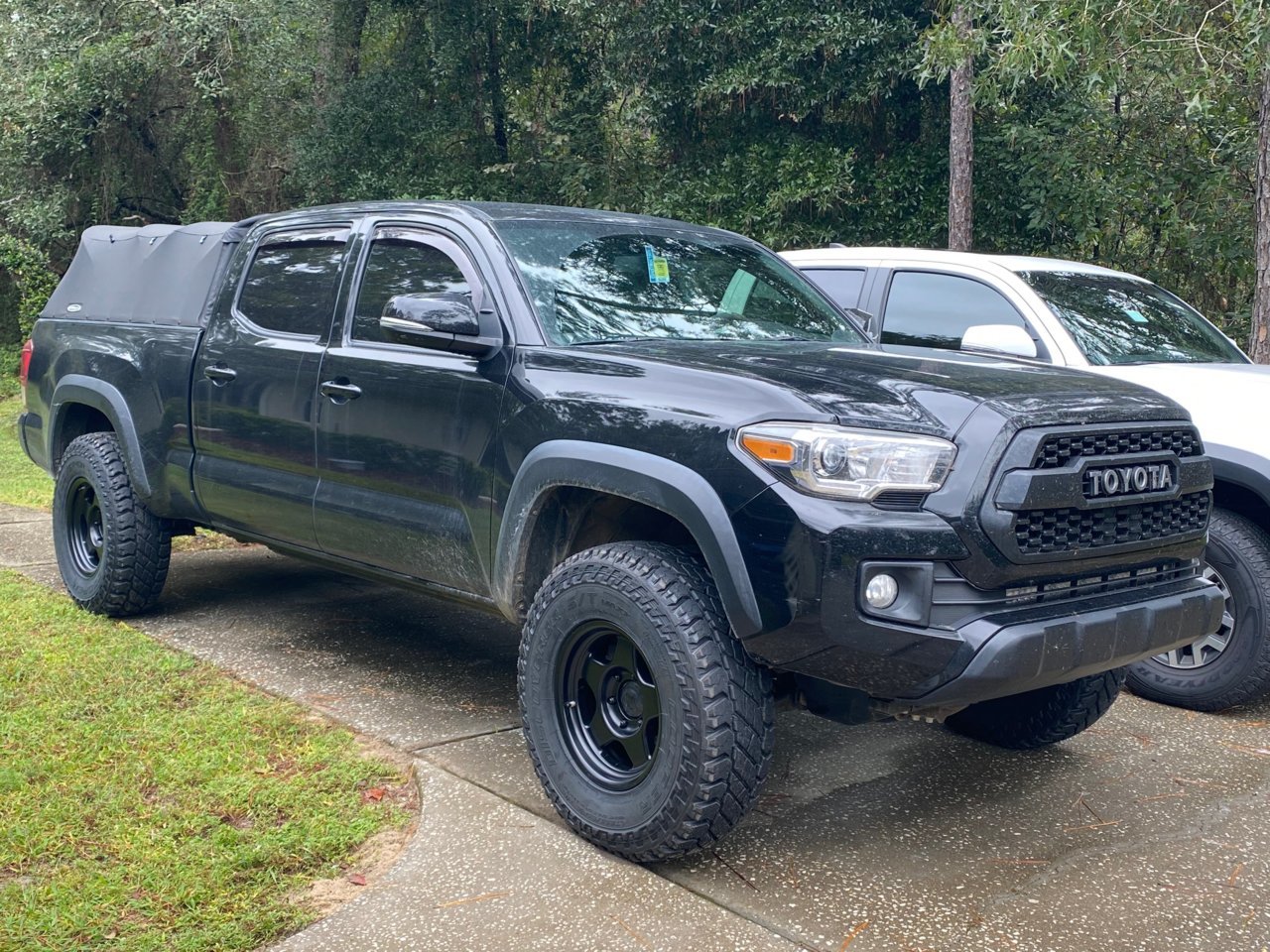

    Truck is dirty but looks so much better now on these 255-85-16 Cooper ST/maxx
    5100's all round front set at 1.1" 3rd clip stock coils
    Re-gear 4.88's
    SCS F5's 16x8 4.5"BS +0mm Offset
    Need to do some work to get the spare to fit under the truck.

    Looks fantastic. CMC required? Pinch weld smash? Love it.

    No CMC or pinch weld smash needed, no rubbing at all so far. Not flexed it yet off-road. Full crank left and right forward & reverse and no clearance issues.
    Thanks I'm stoked with the way my truck looks.

    These look GREAT! Seems every tire is a little different but I'm often surprised how well some of the skinnier tires fit on such a wide wheel. Yours don't look stretched really at all compared to the 285's you normally see on 8" wide wheels.

    I don't think they looked stretched at all

    The skinny tires are still 10.5" wide, there is no way they would be "stretched" on a 8" wide rim.
