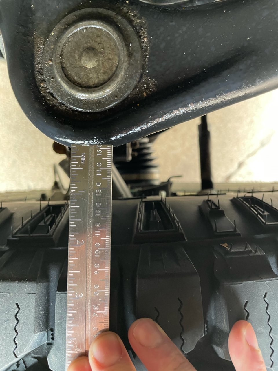

    Just double checking you'll get about a half inch of space with the 255's. So without the spacer that may be enough. I do know that these suspension systems don't always give the same numbers. Don't know how accurate you can measure but hope this helps. The ruler is sitting above the UCA since resting on the tread. Due to the position/angle of the camera, anything measured below would be off slightly.

    Sure appreciate that! Exactly what I needed. That should be fine.
    FWIW, I’ve got a set of Spidertrax I ran for about 1000 miles but then took off. To me they seemed to change how the truck drove and I took them off. Sitting on a shelf in the shop building.
    Thanks again.

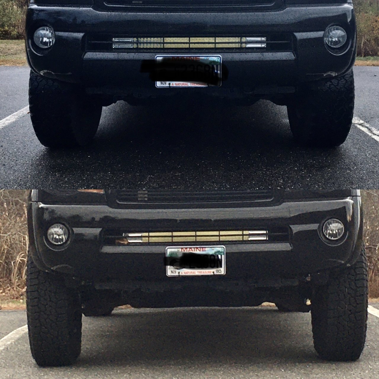

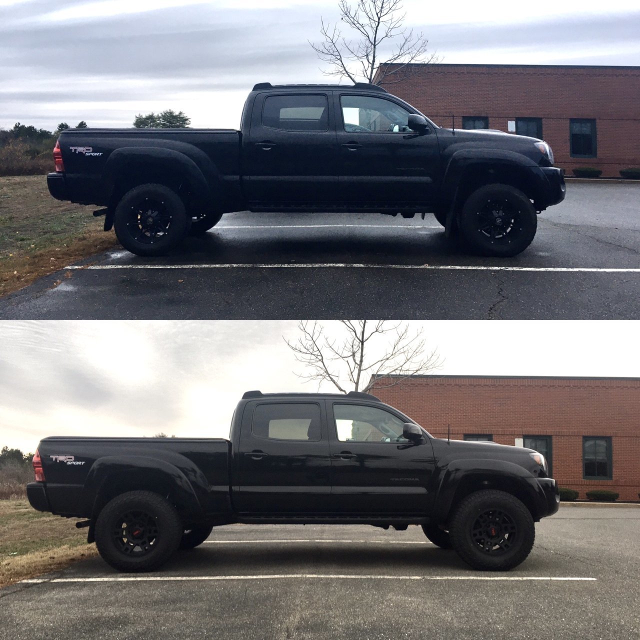

    Went from 265/65/17 on 17x9 wheel to 255/80/17 on the trd pro 17x7 wheels. Had to remove the front mud flaps and heat mold some plastic. I believe my truck has a 2” lift, I bought it used with spacers so I’m not positive. Love it so far. Cruise control up hill struggles a little, other than that feels almost identical to stock size. Haven’t been able to compare gas mileage yet, have to buy a scan gauge first.

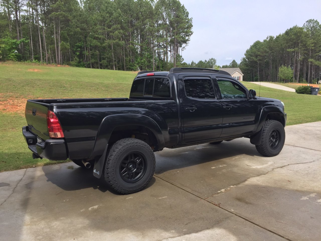

    Good looking trail limo. Makes me miss my old gal.
    Also on 255/80 here.

    Thanks! I might have to pull my TRD sticker off after seeing yours, that looks nice!
