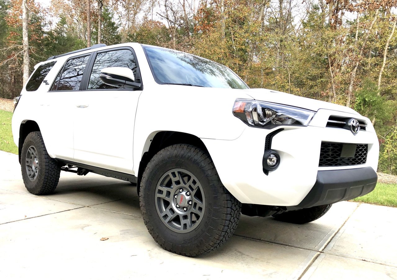

    Pulled the AT IIIs off my Taco to test them on the new stock T4R, going to take a little trimming but should fit nicely.

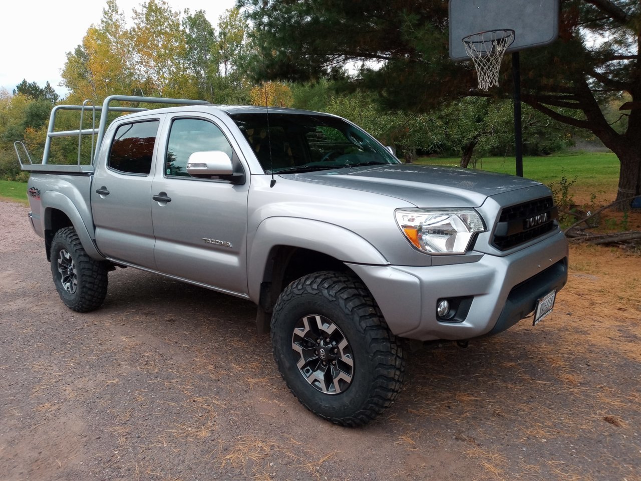

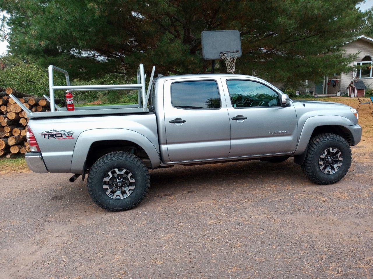

    I guess I forgot to show off here-picked up some KM3's in 255/85r16. Put them on some 2020 OR factory take offs. No rubbing at all in front, but I now have caught the right rear fender flair at full flex and need to do some heating or grinding. Worried about the ice coming soon; maybe should have sipped them but I hear that voids the warranty. Ride great. look great and no discernable losses in handling or mpg. Loving it!20201002_173451 (3).jpg 20201002_173431 (12).jpg [

    what is the offset/backspacing compared to the stock wheels (sport or offroad)?
    & how much lift F & R?

    What rack is that?

    I made that rack-high enough for a canoe to go on top and clear the roof... Mounts to the bed rail system. 2' exhaust tubing, some bending and mitering. Cost $80 for materials and $250 to get powder coated.

    I believe the factory OR wheel is 25 offset and 5 back spacing. I put 3rd gen struts and UCA's, plus a 3/4 spacer for 2 1/5" up front. HS AAL in the rear-probably 3" gain with that change.
