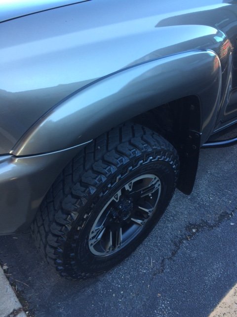

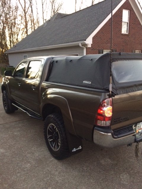

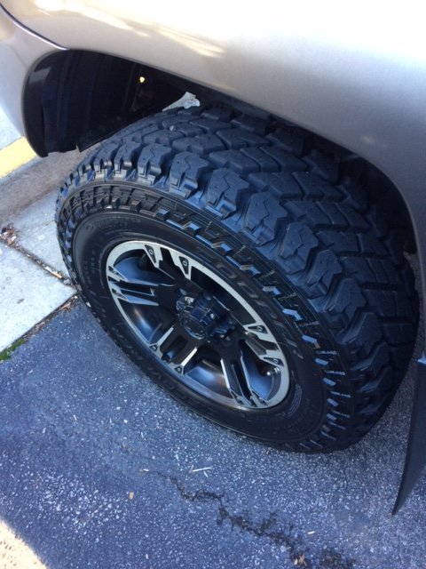

  16. Dec 15, 2020 at 4:11 PM
    #3476
    Poncate
    Poncate Well-Known Member
    May 4, 2013
    #103479
    540
    PNW
    04 DCSB 4x4
    Canadianguy91 likes this.
  17. Dec 15, 2020 at 5:14 PM
    #3477
    Gen2Tacoma
    Gen2Tacoma A Question Asked is an Answer Learned!
    Jan 22, 2020
    #316947
    1,465
    North East Atlanta
    ready6delta likes this.
  18. Dec 15, 2020 at 6:15 PM
    #3478
    Poncate
    May 4, 2013
    #103479
    540
    PNW
    04 DCSB 4x4
    They look great!
