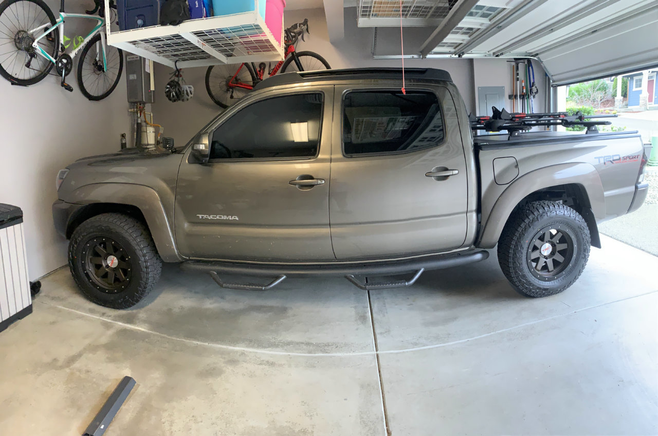

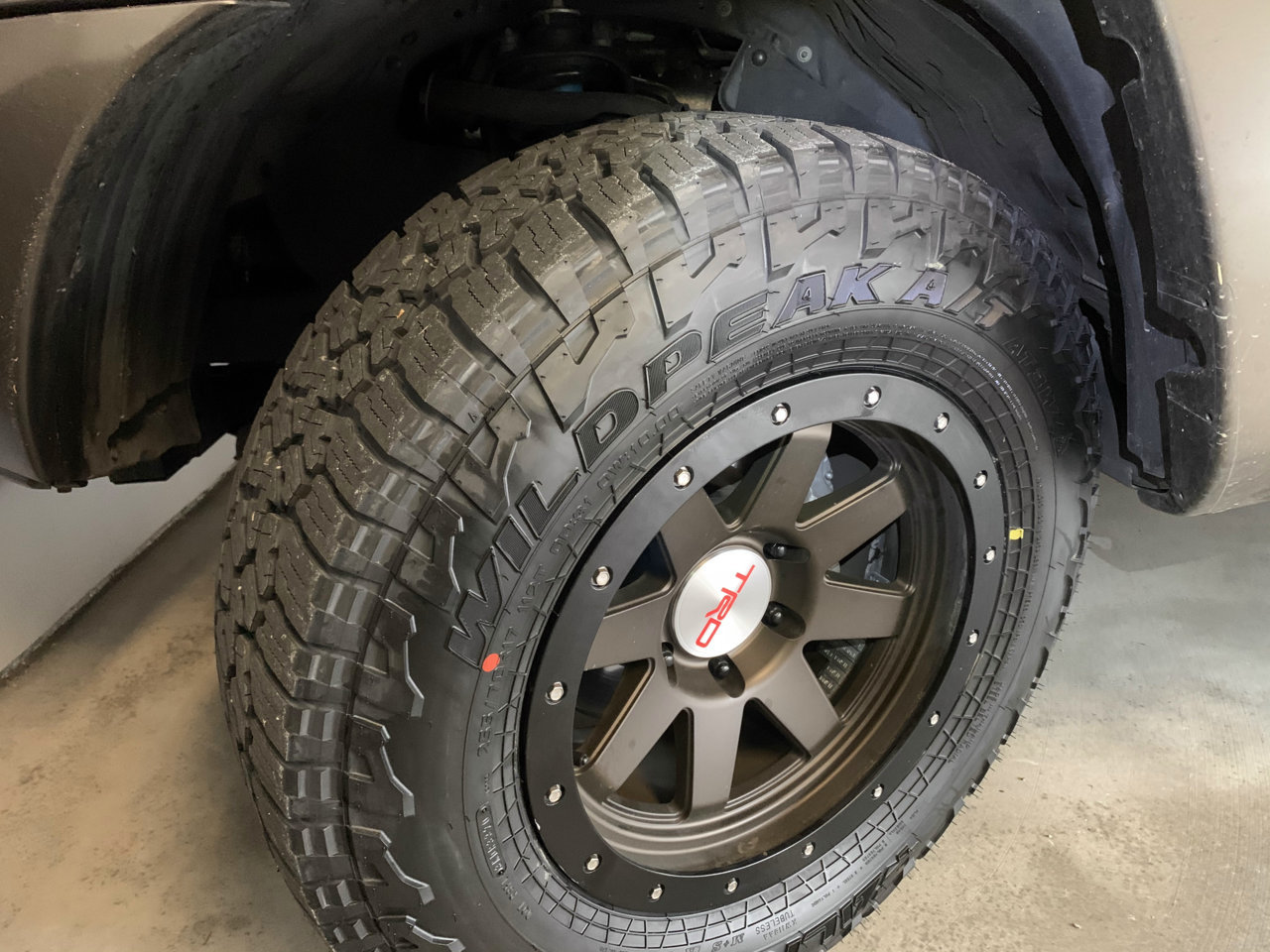

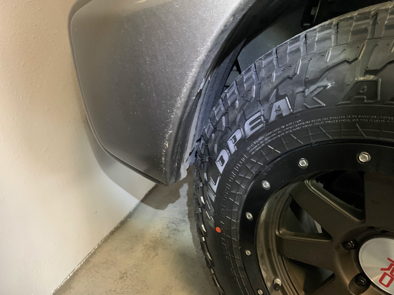

    My quest led me to 255/70/17 on my SCS wheels... not very tall but anything taller would have rubbed. I took the air dam out and my front mudflaps off. Here are some pictures - profile and full locked steering both sides.

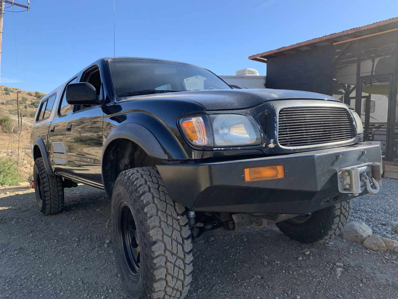

    I joined the club with Cooper discoverer s/t maxx 255/85R16.

    What width are those wheels? 8.5?

    I am not sure. I haven’t measured them and I’m not sure what the actual brand is. I’ve had the wheels for a long time. They actually came off my old tundra. 8.5 is a good guess.

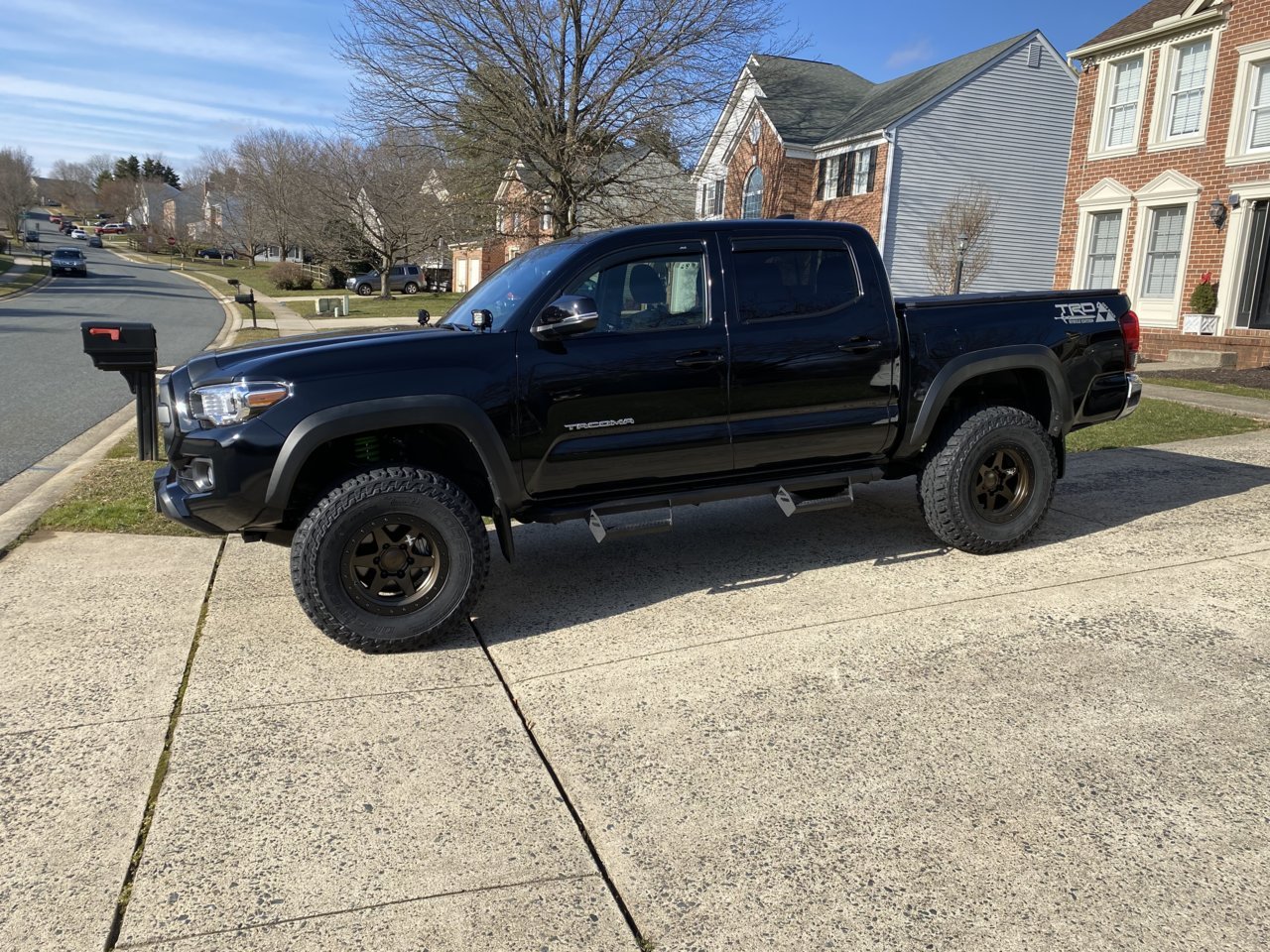

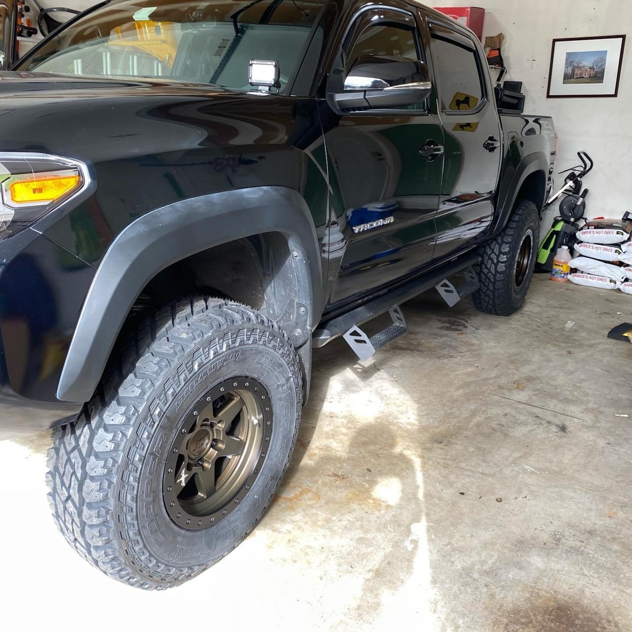

    Joined the group!
    For those with the SPC uppers did you set LCA to max before you took it in for alignment? What are your numbers and how’s it drive. I’m planning on trying for 3.0caster,0camber and .0-(-).03 toe.
    255/85/16 st Maxx on BR6 with -12 offset.
