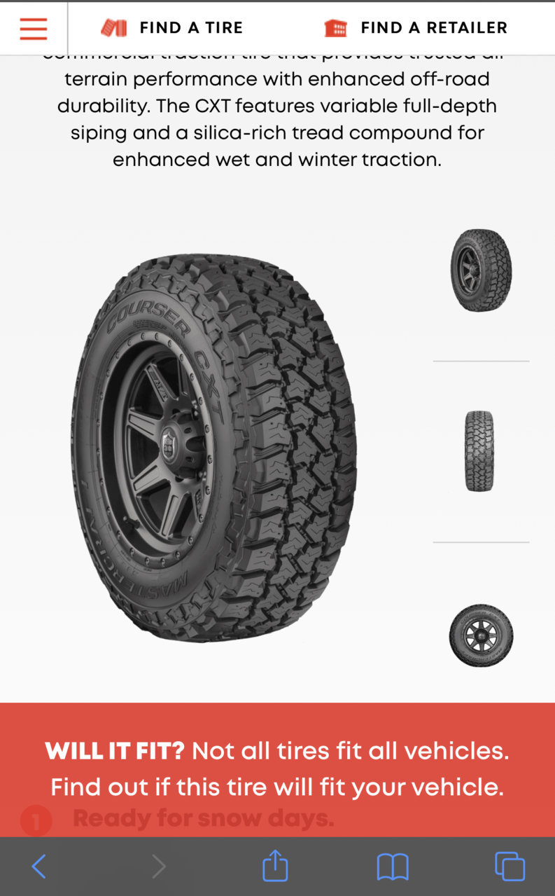

    Would you be able to post a few pictures of the Mastercraft CXTs when you had them on your truck?

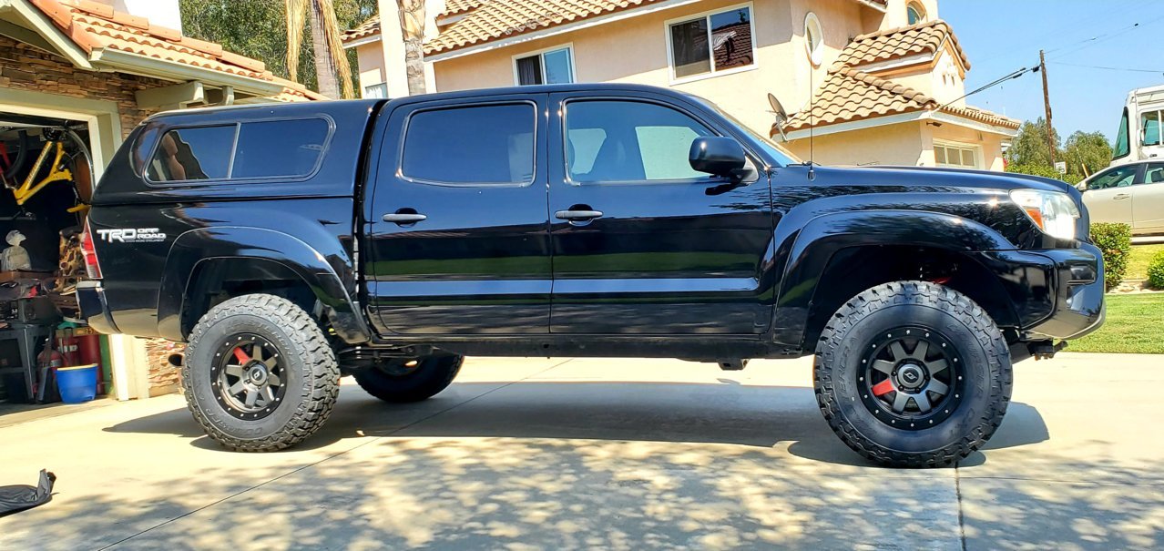

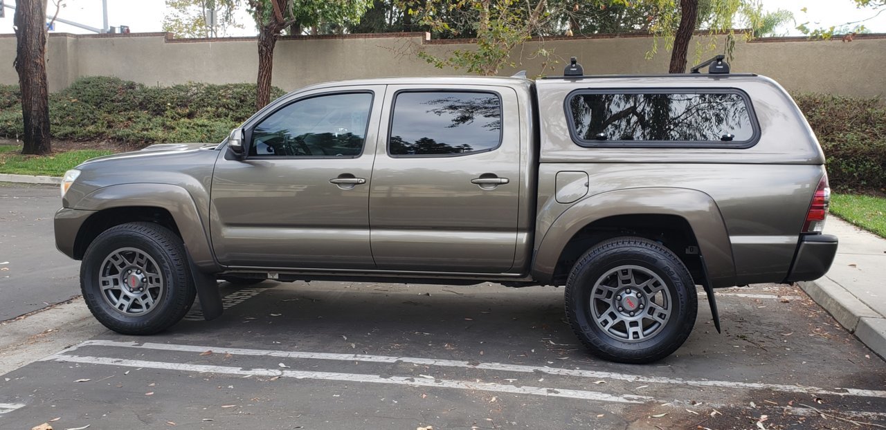

  10. Jan 24, 2021 at 8:52 AM

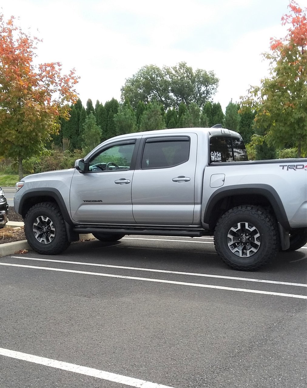

    spentshells
    spentshells Well-Known Member
    Apr 15, 2016
    #184365
    808
    Rob
    PA
    TRD off road
