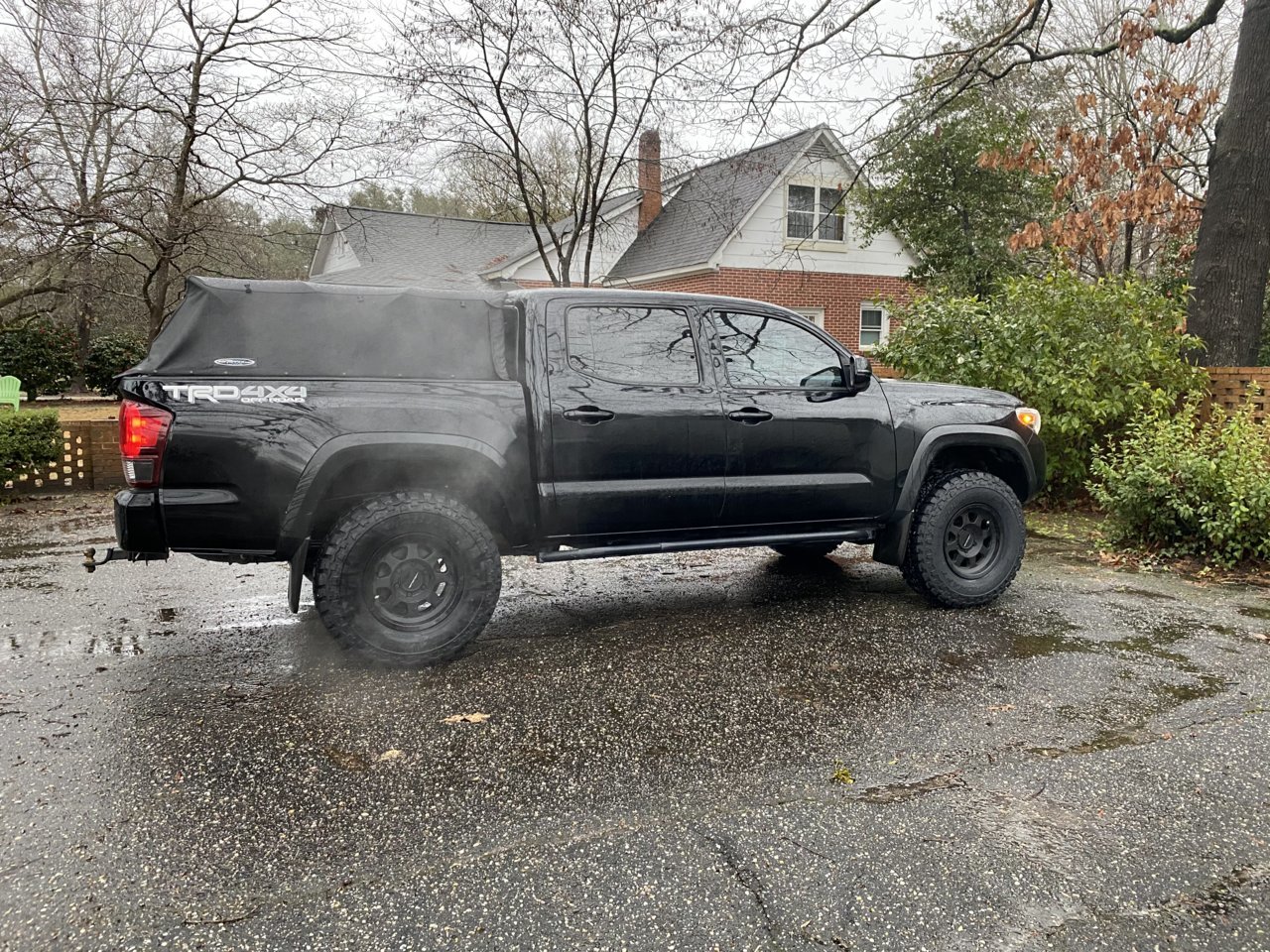

    Courser CXT 255/85r16
    Before: Wildpeak 265/75r16E42389C8-5B65-478B-9309-FACDE13FED6D.jpgAfter: 4FEEFCD6-21E6-4008-8E14-9DB249024E38.jpg
    Fills the wheel well out perfectly imo.
    Really no noticeable power loss or pedal feel at least. Steering feels a bit tighter maybe. I will say they do not hum but SING. This is the closest thing to a mud tire I’ve ran though, so not a lot to compare to. Rubbing a bit in reverse at 1/2 turn and coming into my driveway curb while turned. Looks to just be the mud flap but it’s raining out and will investigate further later.
    Other specs:
    16x8 0-offset
    5100’s with 885 springs in front, inch block in rear, stock UCA.
