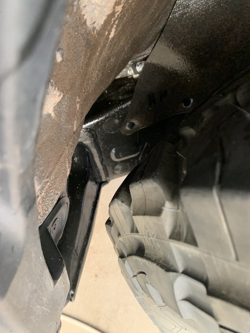

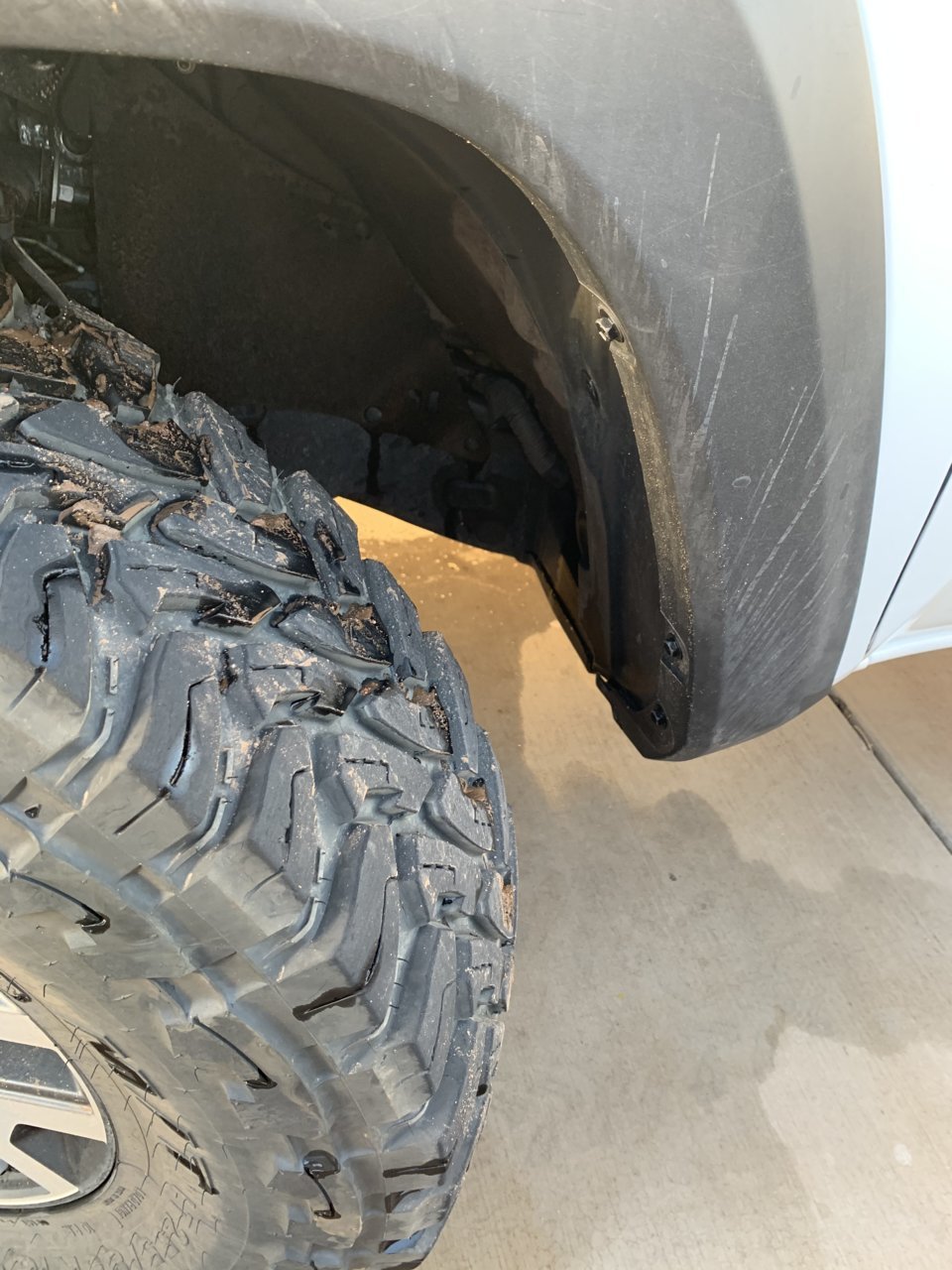

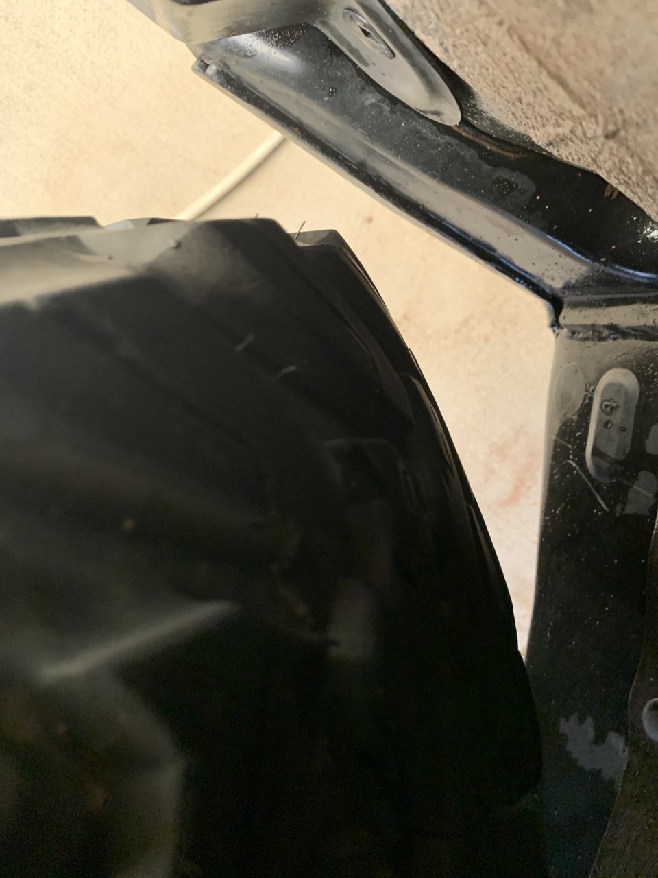

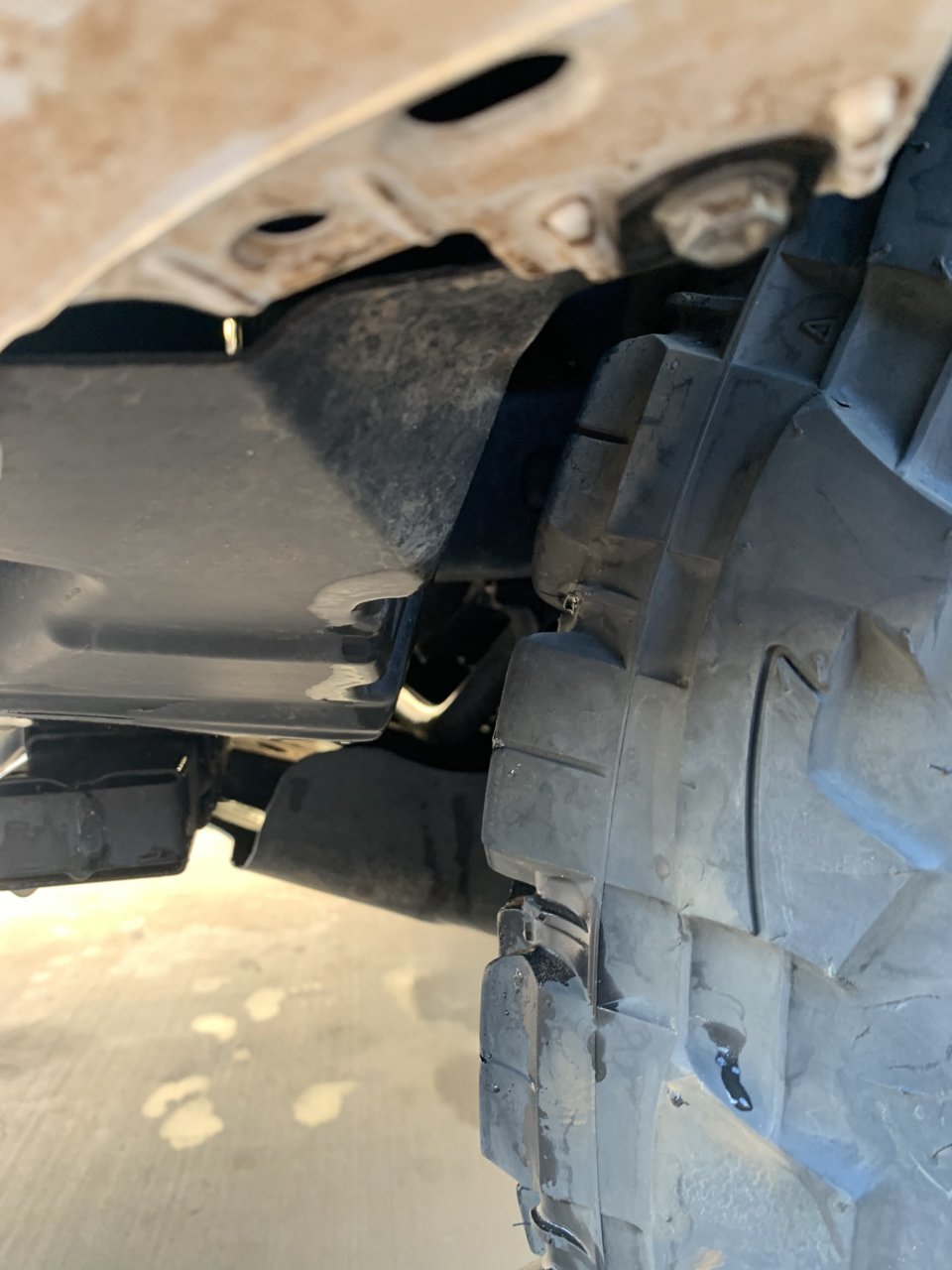

    For those curious about clearance of 255/85R16’s on stock 3rd Gen TRD OR at stock ride height. Here are some photos I snapped while power washing of clearance with the wheels at full lock.

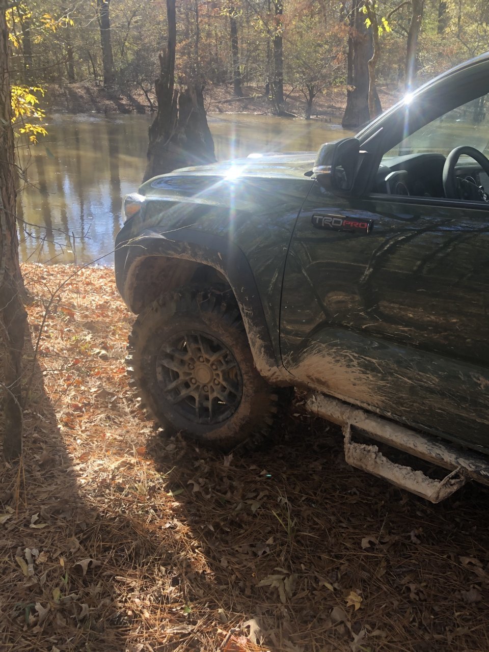

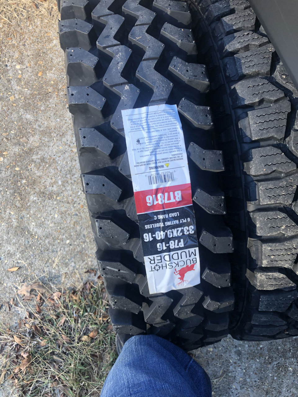

    D3AB02D7-9695-491A-A13E-E51C405FEFE9.jpg D3AB02D7-9695-491A-A13E-E51C405FEFE9.jpg 89E2EE95-D2B7-4059-BB86-142F85377D61.jpg 33x9.50x16 buckshot gumbo mudder

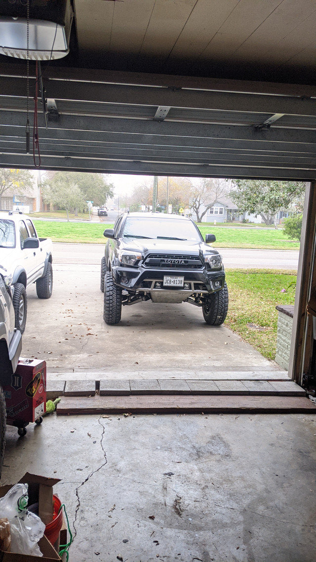

    This truck is on a TC2" kit but it has a cab mount relocate and is fixing to get fiberglass fenders this is what it will take to clear these tires. It would do it with chopped fenders but the cab mount would still have to be relocated to fully stuff these tires on this kit.

    They look great on your rig, also look like they would be great in snow or trails, and I think you may have something thinking the center may keep them quieter.

    Those look old school cool! That's some deep tread too, what tire is next to it in first pic?

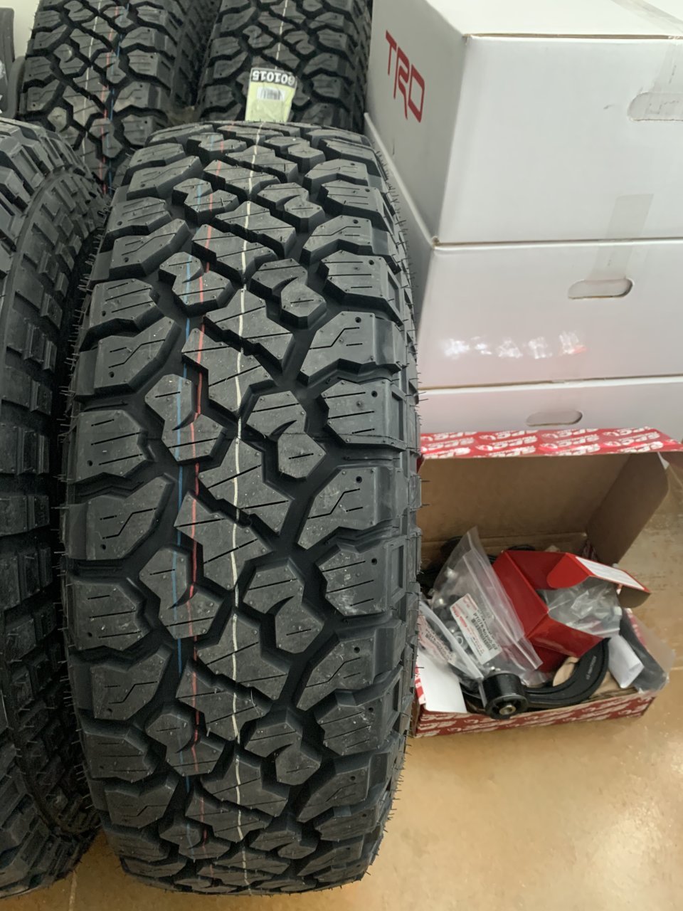

    They have arrived. Should have them on Monday or Tuesday. Have to do the fitment work this weekend with the full-size spare and set alignment. I’m very excited to see the wheel wells filled to capacity.
