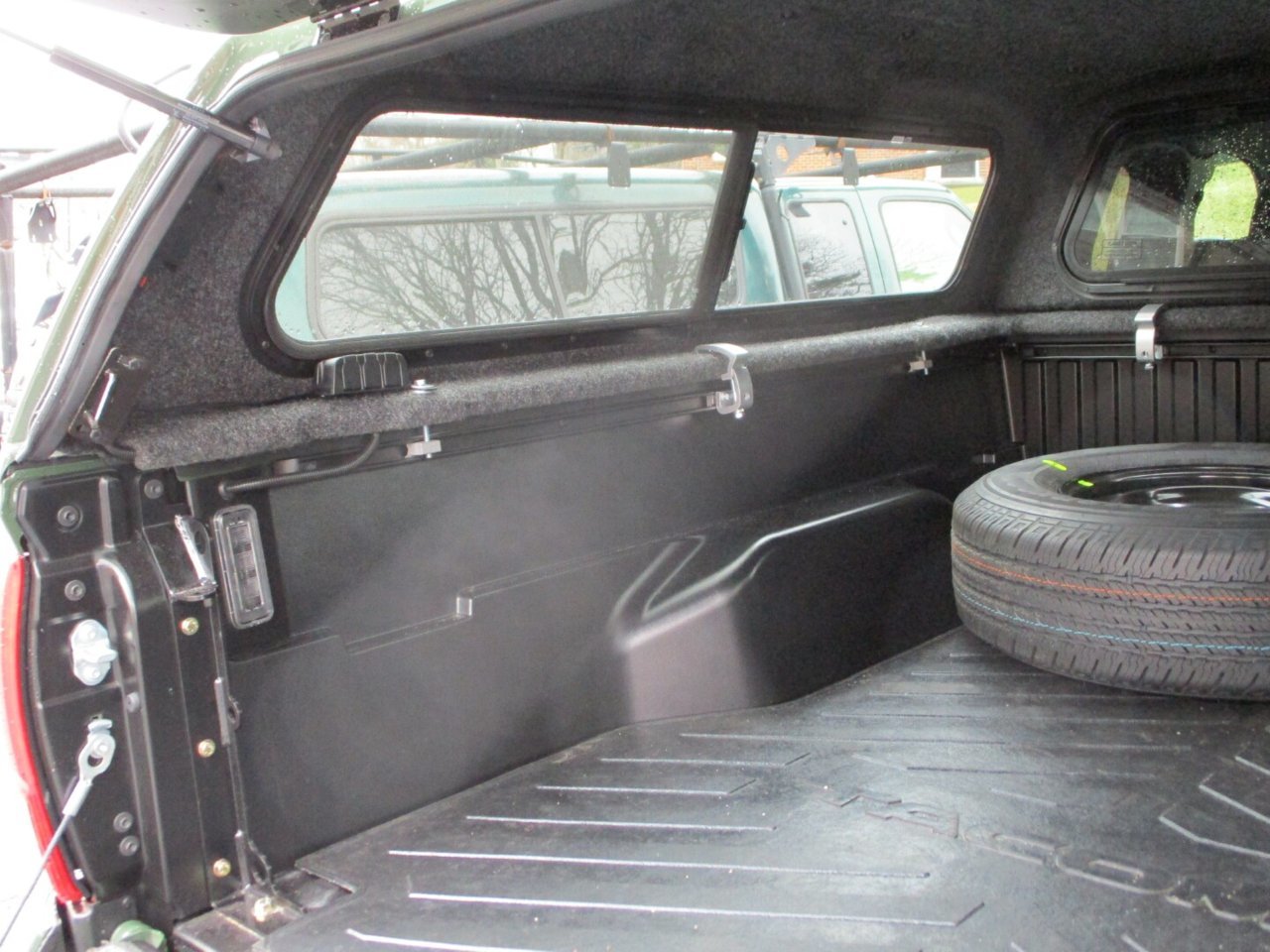

    This is how I'm carrying my OEM spare -- flat, in the bed. This is working out well, on a temporary basis. (I don't want to carry it underneath the truck for a variety of reasons, based on experience.)
    However, I would eventually want to build a sleeping platform in the back. This would use the existing ledge / notches for support. The issue spare tire sits too high, and would interfere with the platform. I need to find a tire with about 25% less sectional width, that is, less than 8" wide, while having the same diameter. This would be a hypothetical 195/95R16 tire, but such a size is not available. But the old 7.00-16 (used in 1950's trucks) is almost the same size. It's being made today, as a radial that outwardly resembles the old bias-ply. These are pricey (~$300 each) but I only need one. I would also need a narrower wheel.
    Is this a workable plan?

    Why don't you just build the bed platform a couple of inches higher?

    I would build the platform to clear the tire. Why not?
    There's not that much difference.

    The hardest part of that would be finding a wheel that is a.) skinny enough, b.) has the right backspacing so if you do need to use your spare it’s not tucked in a half a foot, and c.) is the right bolt pattern.
    The other downside would be sleeping with the off gassing smell of the tire.
    You could stand it up against the back wall and make a cut out in your platform there. Taller person can sleep on the side without the tire, shorter on the side with it. If you sleep with your foot toward the cab perhaps there’d be enough fresh air on the other side to offset the tire smell.
    EDIT: looks like a short bed. You’ll have to sleep diagonally anyway. I’d put it upright in the front corner.

    No, it's the long bed access cab. BTW, I like the tire smell.

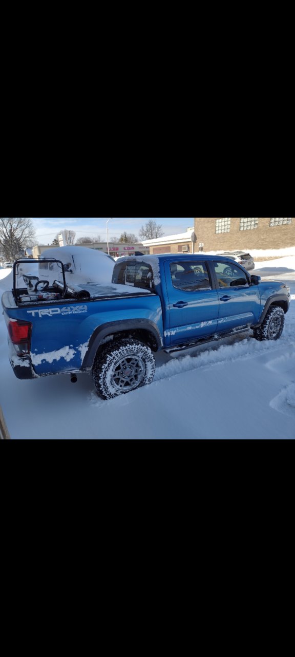

    They absolutely eat snow. Not many miles so far, road noise is minimal, kind of sound like a snow tire. Ride great, balanced great
    Suspension is lifted around 1", i have some crazy ass caster set up front and some plastics trimmed, heat mended. I can't comment on stock suspension.

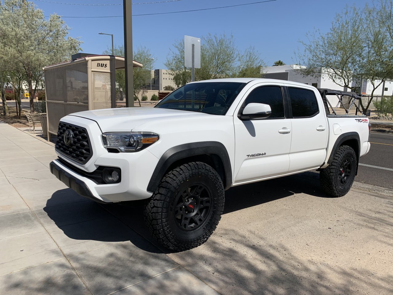

    Got my Kenda’s mounted. No rub lock-to-lock at stock ride height. I’m very happy. Took an aggressive CMC, pinch weld, some hammering and a little cutting on the lower fender, flares and bumper. Installed SPC UCAs and played with the alignment.

    Damn, that looks fantastic

    What size are these tires?
  15. Mar 10, 2021 at 2:36 PM
    #3695
    Maxx
    Maxx Well-Known Member
    Dec 30, 2012
    #94017
    1,397
    35x10.5x17
