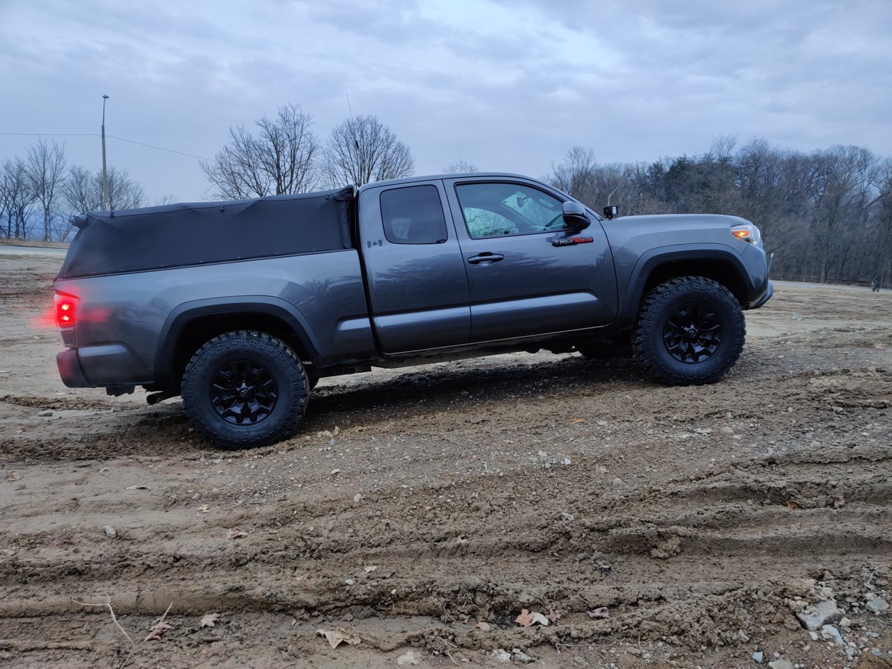

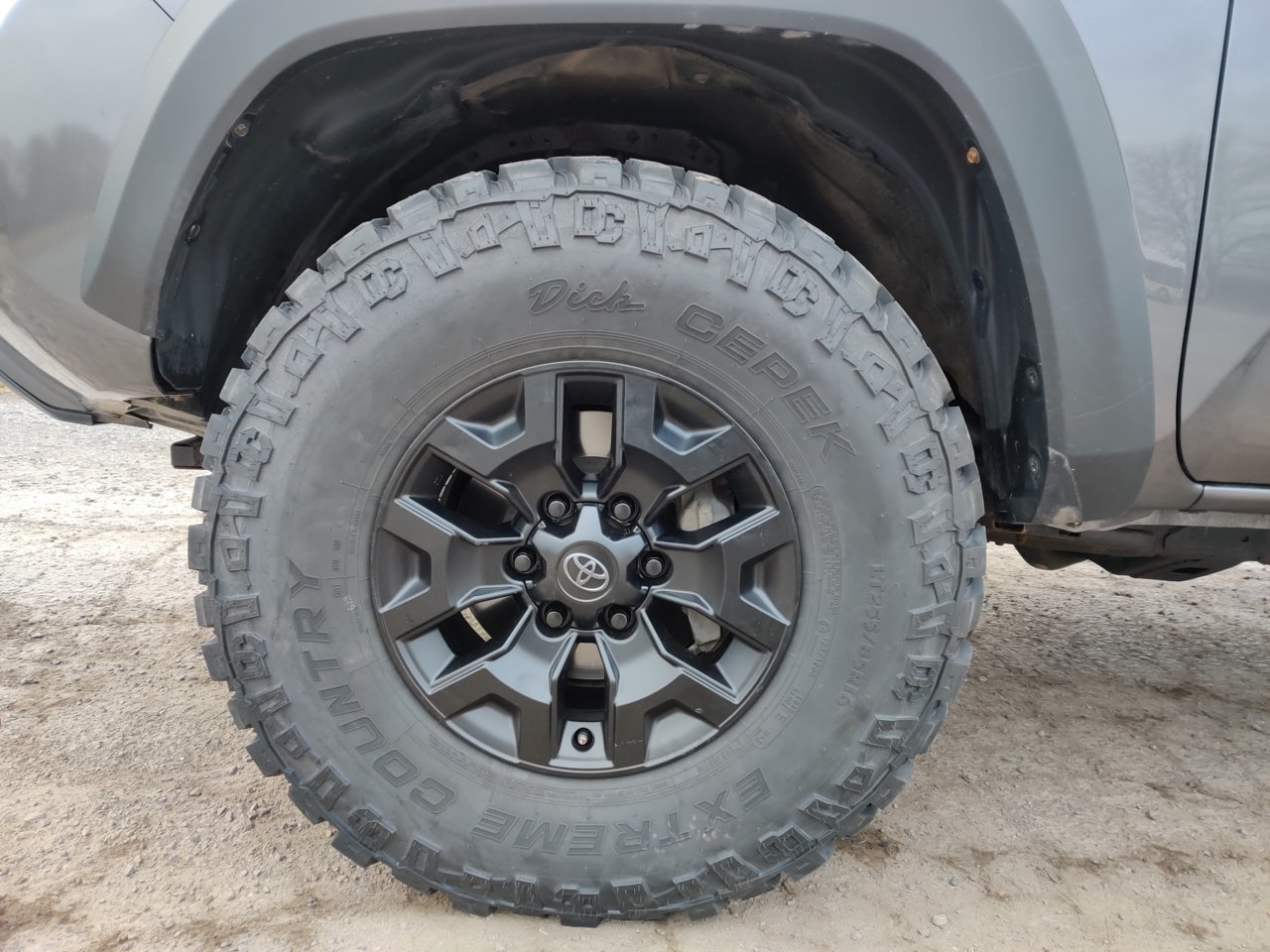

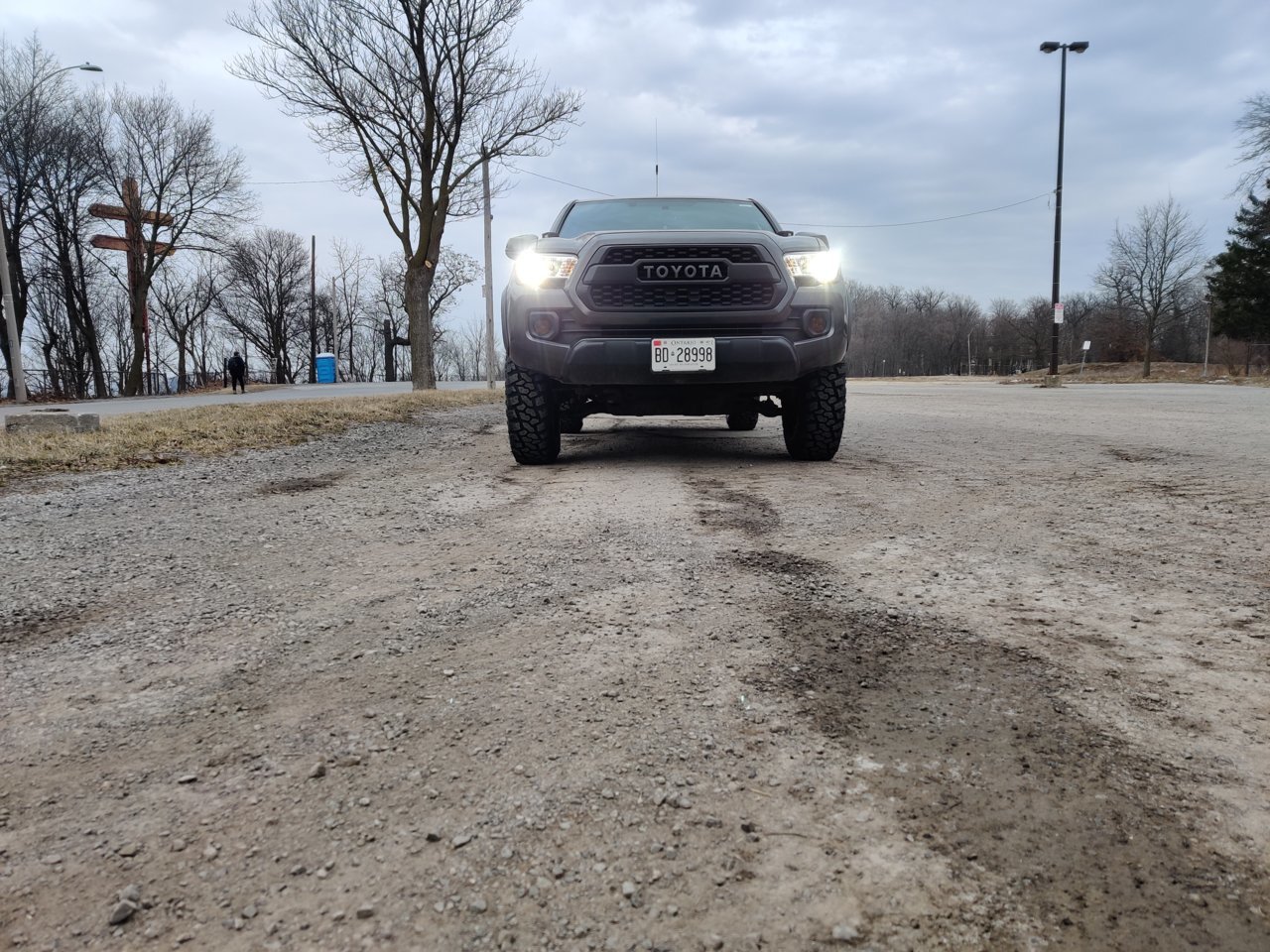

    255/85r16 dick cepek extreme country on stock rims, no lift.IMG_20210317_190639.jpg IMG_20210317_190724.jpg IMG_20210317_191423.jpg

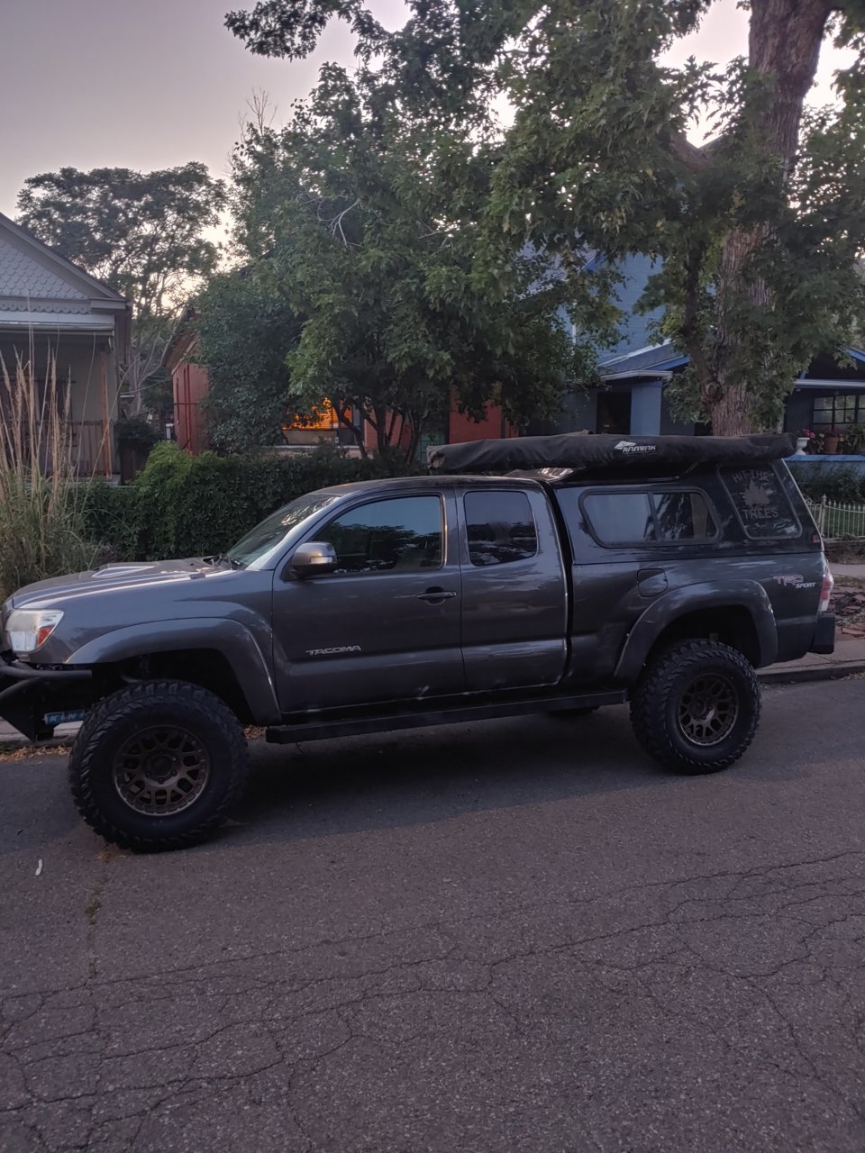

    front +2 allpro long travel with kings. Marlin crawler lca reinforcements, alpine design cab mount. All pro spindle and upper control arm reinforcements. Willwood 6 piston front calipers and 2 piece rotors. rear 7 pack expedition soa, 12 2.5s, archive garage shock relocation kit. Archive garage shackle flip kit. wheels 285/75/17 geolander g0003 on 17x9 with a zero offset. engine bay. antigravity atx hd-20 lithium battery arb high capacity air compressor. 3* exhaust cam timing. intake spacer custom stuff custom made sliders, custom bed rack system, custom drawer and bed system, modified mounts for arawak awning. Fiberglass/lexan cap door. Boxed out frame in spots I could reach. soon to be a chopped bed at the rear axle interior -lathewerks co polymer stainless shift knob, modified from a wrx to fit. -pioneer mid and treble speaker replacement. -future mods -4.56 gears arb front and rear lockers -traction bar for the rear. -full carbon front clip. -supercharger eventually.
    tread width is 9 inchs. From sidewall to side wall is about 11 inchs when inflated at 40 psi.

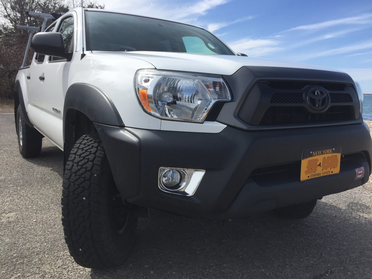

    Finally took the plunge after much procrastinating and bought 235/85/16 for 2nd Gen 2015 stock suspension.
