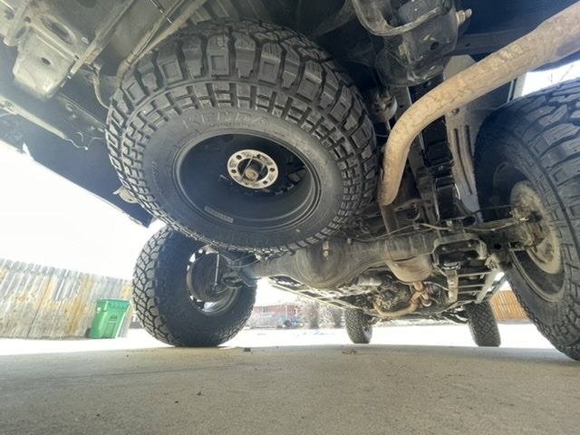

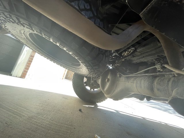

    By the looks of it, that's not as simple as unbolting and rebolting. How are you reattaching it?

    You have to drill new holes and bolt it.

    Mine fit when I pounded down the tabs with a BFH. No rub on the exhaust or the pumpkin. 255/80/17 Falken Wildpeaks.

    I fit my 255/85R16 in there by hammering the tabs and moving the mechanisim rear about an inch or so. Marked, drilled and bolted. Pretty easy. I'm about to cut the exhaust and try and make my 35 fit under there. Another guy on here said he made it work so I'm going to give it try.

    I have read 35's hit the stock hitch receiver and the pumpkin. Are you running an aftermarket rear bumper that would move the receiver? If you can make a 35 fit under there I want in on whatever info you have because that's one of the two reasons I didn't go 35s and went 33's (spare fitting under the bed, and regearing)
