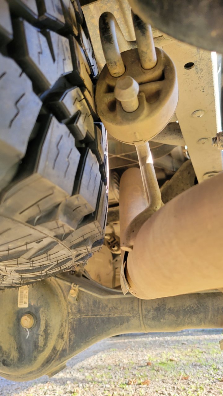

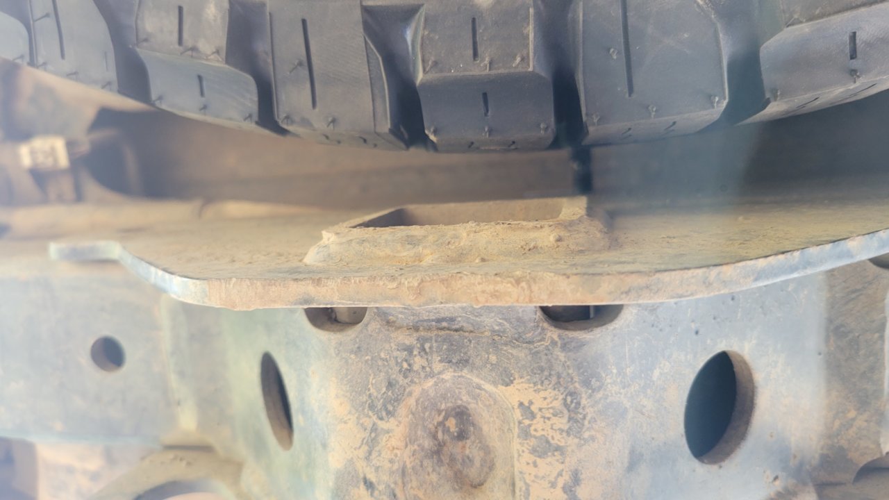

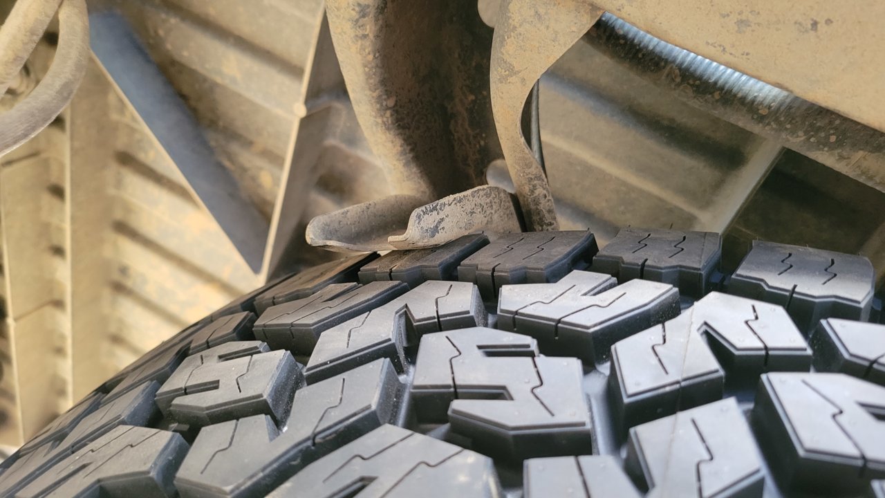

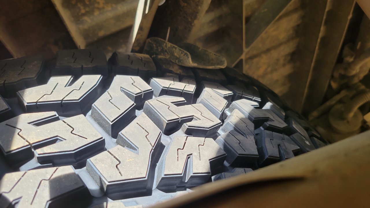

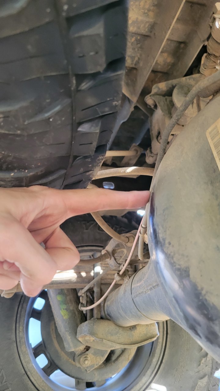

    Quite a few things at this point..
    Got my spare to fit with zero modding. I run 255/85r16 Yokohama Geolandar MTs, spare is actually a 255/80r17 Toyo OC AT3 and completely deflated.

    I cut my muffler off just after the axle anyway for ground clearance issues, then hammered that metal bracket up and cut the brackets off for that rubber thing to make sure my spare fit without any undo pressure points. It fits very comfortably now.
