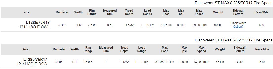

    if tiresize.com is to be accurate it shows a difference, granted .4'' isn't really much

    The tires SHOULD have exactly the same tread width. I would guess that, in that example, the fact that they were measured using different width rims changes the measured tire width.

    And it's a measurement given a certain rim width.
    See this VV
    .4" difference in a 1/2" narrower rim. Check out the measured rim. 8.5 vs 8
