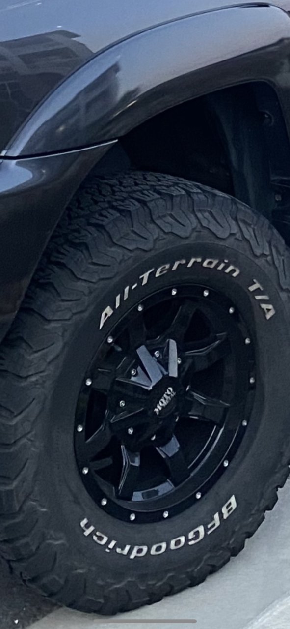

    Did some research but rather ask the pros, so:
    I have 265/75r16 tires (w = 10.4”)
    I want 235/85r16 tires (w = 9.25”)
    Do I need new wheels??

    I suppose that that depends on what wheels you have now.

    Those wheels are 9" wide, and the 235/85/R16 AT and MT tires I just looked at on DT all were spec'd for 6.0-7.5" wide wheels.

    The tires I got 265/75r16 the rim width range is 7”-8”. Understanding. Appreciate the help

    If you're currently rolling on 267/75r16, Those are definitely not the wheels you have. Maybe the same style, but not the exact same wheel. Those are a 20" wheel. They're also 8 lug. The wheel in your picture looks like it has 8 lugs, but I guess that's just the center cap? Tacomas have six lugs.
    Assuming that's the right style (MO970), then it looks like you have a 16x8" wheel. I don't see the Tacoma bolt pattern (6x139.7, aka 6x5.5) listed in a 16x7 on Moto Metal's website.
    There are probably some identifying markings cast or machined into the wheel that will tell you for sure.
