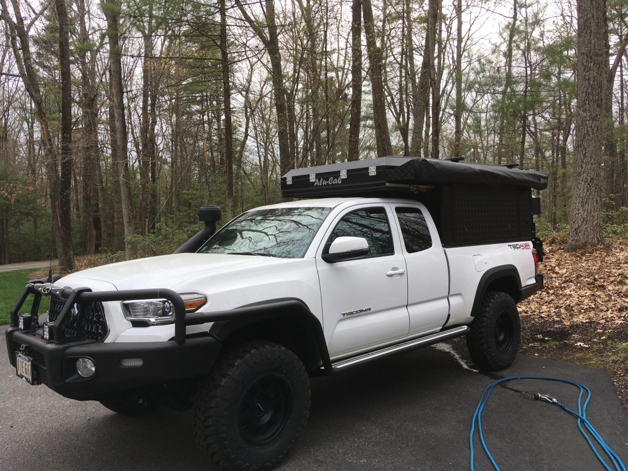

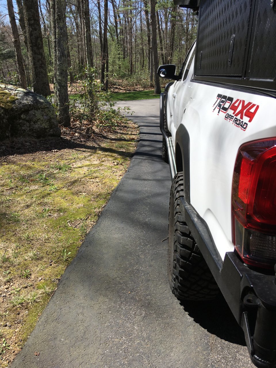

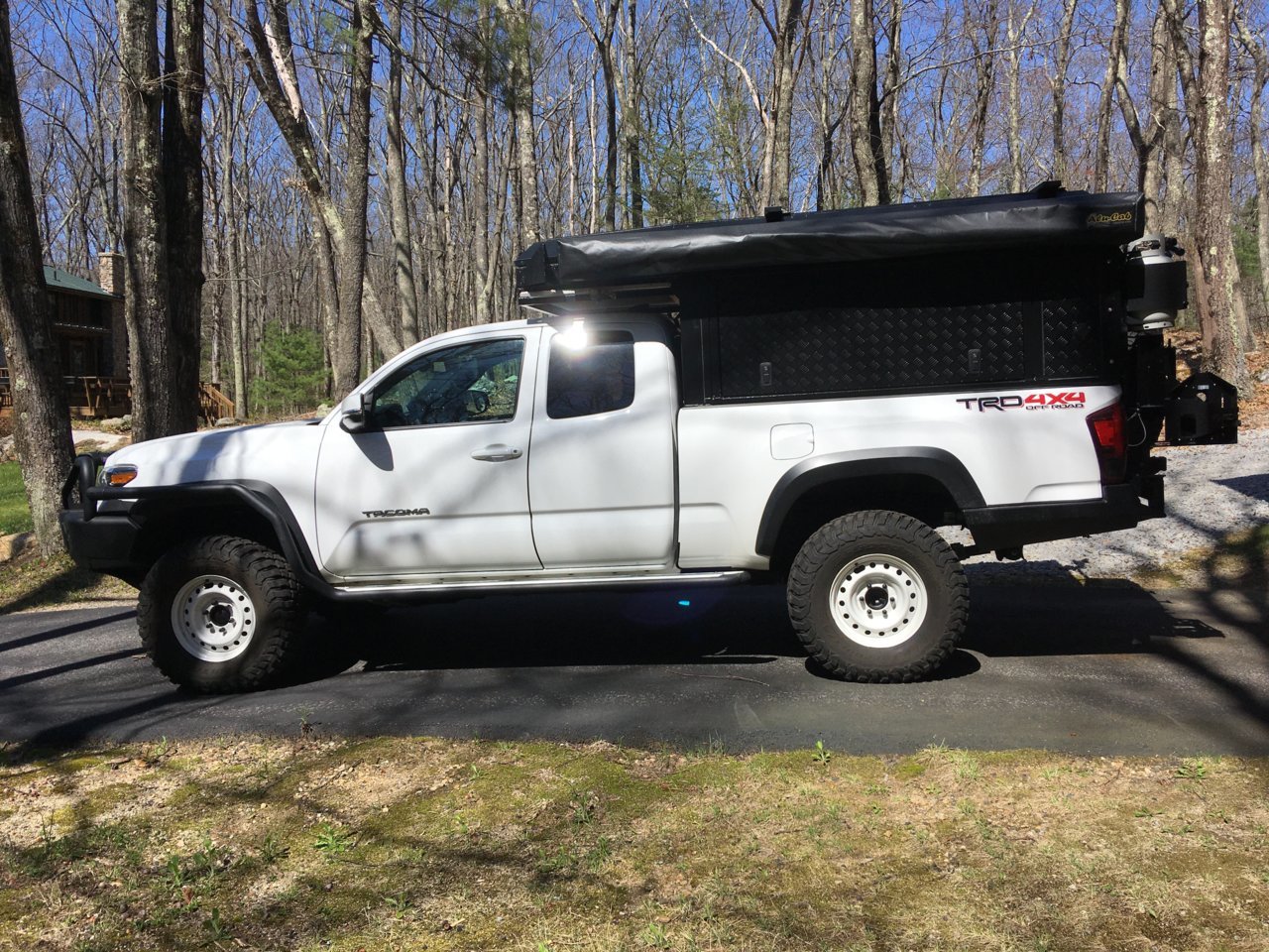

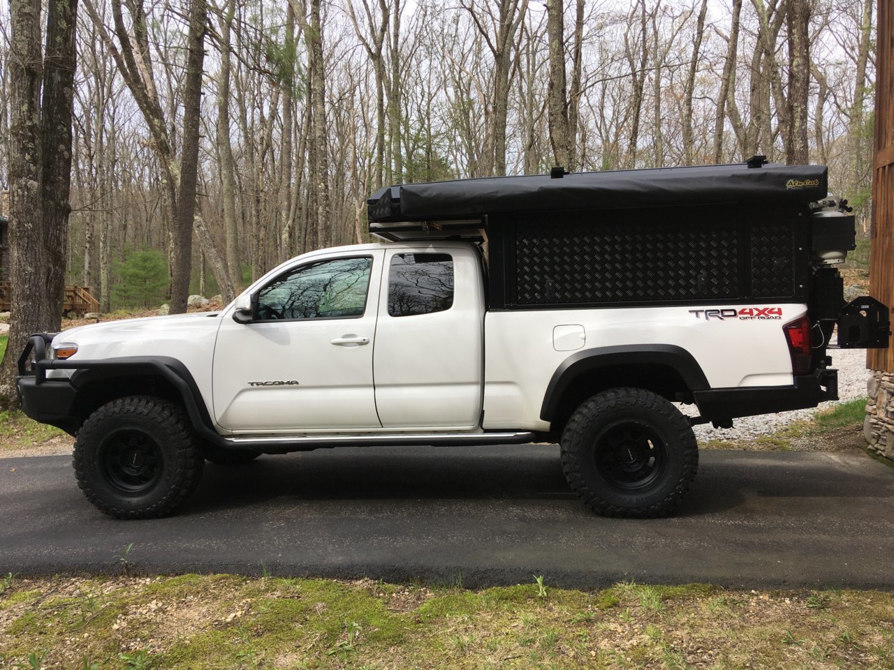

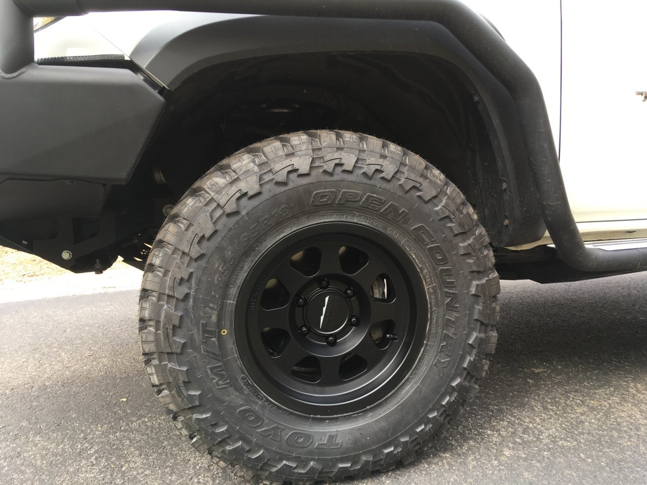

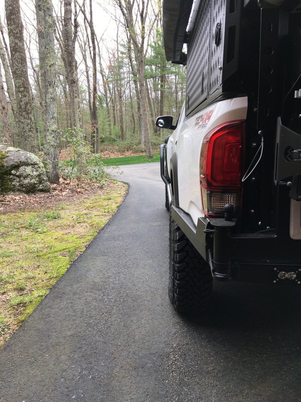

    Finally mounted up today! Tire shop had a bit of a struggle getting the Toyo's to fully seat on the Method Trail Series wheels. Once they got the hang of it all went smooth. I really loved the old school look of the steelies I replaced, but the Method wheels are definitely sweet and a big plus is I don't need wheel spacers anymore.
    The details...
    Suspension is OME BP51's, with Dakar HD rear leaf pack and an add a leaf. Overall about a 2.5" lift
    Original setup: Toyota Tacoma factory spare steel wheels with Spidertrax 1.25" spacers (approx 4" BS), BFG KM3 MT 285/75R16's
    New setup: Method 701 Trail Series Wheels (4.5"BS), Toyo Open Country MT 255/85R16.

    Seen some posts where folks have had issues with the sidewalls getting punctures or splitting while wheeling. Yours have held up well? These are on my short list of tires.
