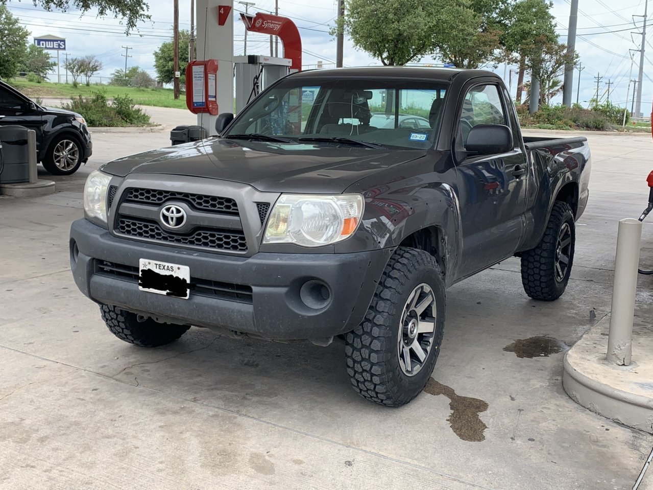

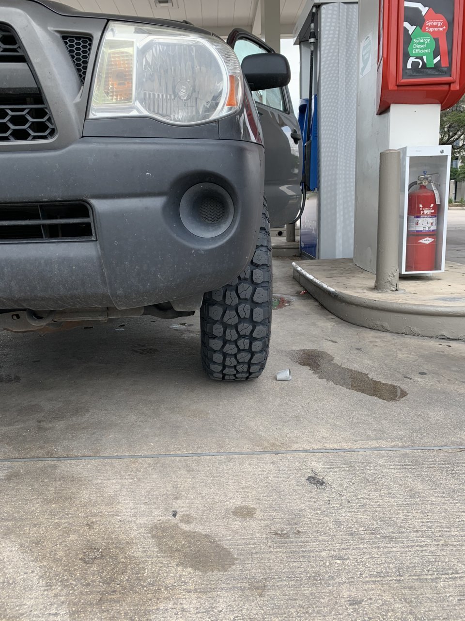

    I finally got myself some pizza cutters. Had a set on the truck when I got it a decade ago and stupidly put bigger tires on only to find out it he on and off road performance was severely diminished. Can’t wait to throw some
    Mud on my truck on my hunting trip this weekend!
    The tires are iron man all country m/T’s in LT235/80r17, load range e 10 ply tires. I drive about 300 miles a day so I wanted something more puncture resistant that would hold up to some abuse and not break the bank. I’m saving up for a set of higher end tires as we speak along with a lift, so If I get 1-2 years out of these I’ll be content with how little money I had to spend on these.
    2011 reg cab 2.7l 4x4.
    i feel like pizza cutters are the best choice for reg cab 4x4’s.

    stupid question but will the 2020 TRD Pro wheels accept the skinny tires?

    yes they will my wheels are the same specs, 17x7” and the ultra skinny 235/80r17’s fit great. Almost like that size wheel was made for pizza cutters

    I wonder if I need to trim anything. I mean I already have that 1 inch lift from the factory. I love the look of the skinny, but the trimming is something that im kinda meh about

    You won’t need to trim if you go with 235/80r17’s. I have zero lift and zero rubbing even at full lock
