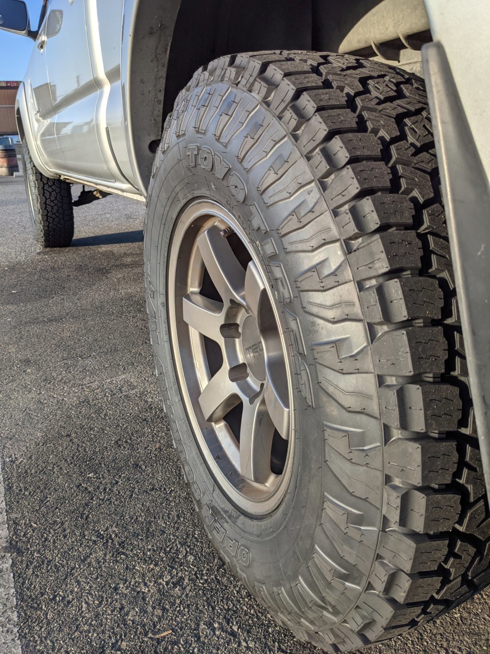

    Finally moved up to 255/80/17 from 265s. I've had a 2.5-3-in lift for a while now, but I hadn't got around to putting 33s on. So far so good.
    Thanks to @Bannerman and a few others for motivating my to go with this size and Toyo AT3. And this thread has been invaluable. Now let's see how power and gas mileage on these bad boys

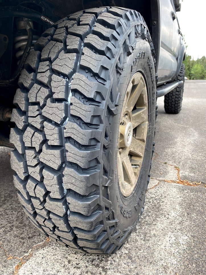

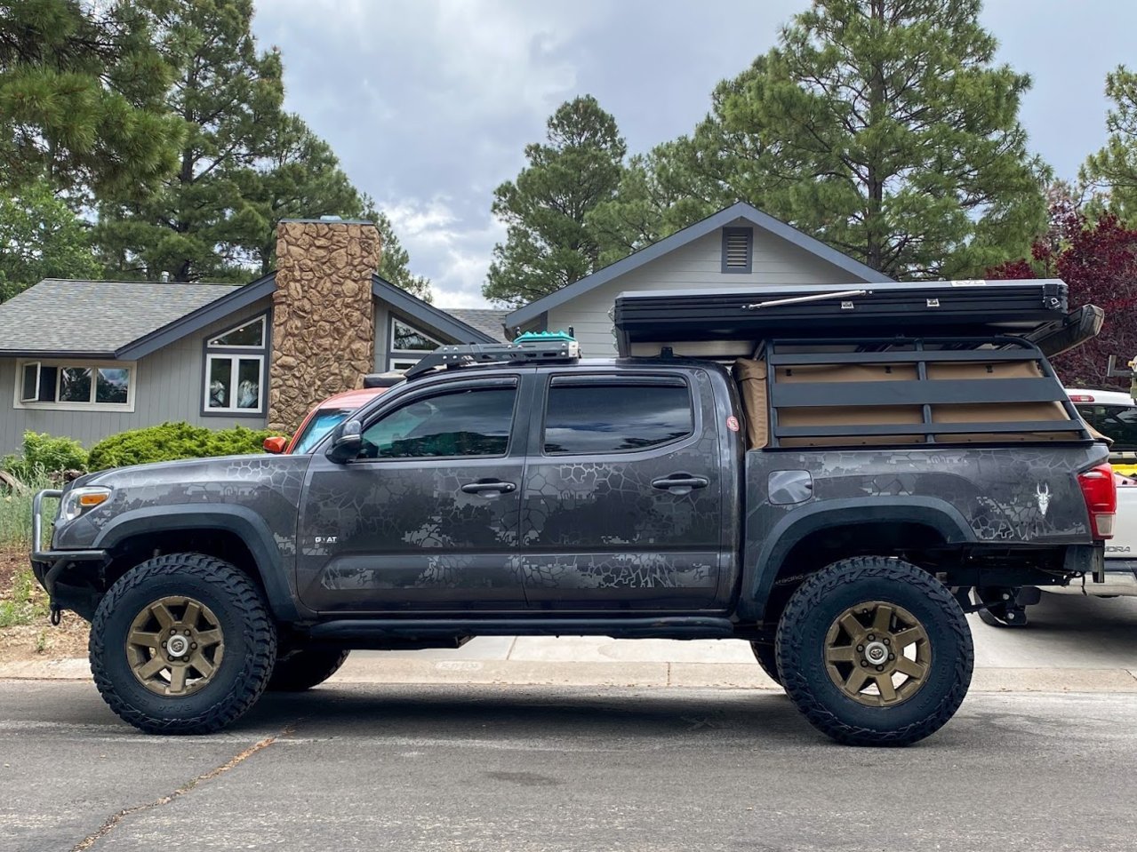

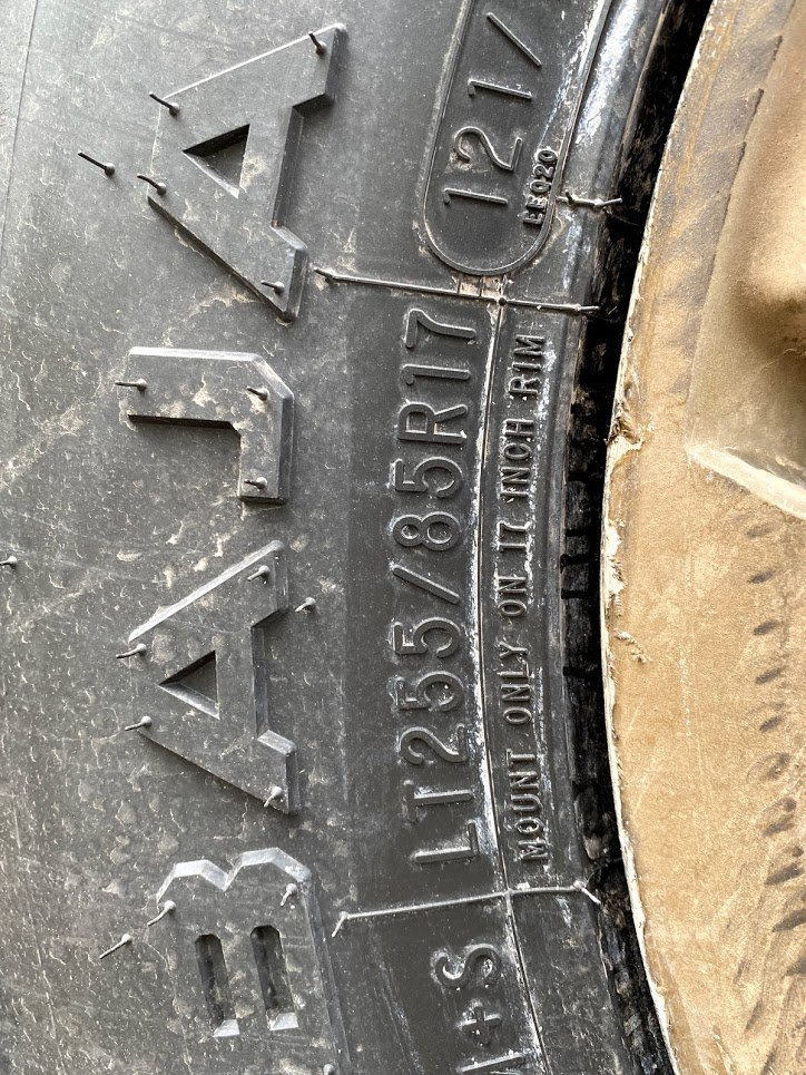

    Here they are, Mickey Thompson Baja Boss AT in 255/85R17
    Tall skinny 35s. Work still being done with the truck. Getting a new rear bumper fabbed up.

  4. Jun 26, 2021 at 4:56 PM
    #4164
    Admiral Noodle
    Admiral Noodle Well-Known Member
    Feb 3, 2019
    #281749
    95
    2019 DCLB trd sport
    Looks sick! What tire size did you come from?

  5. Jun 26, 2021 at 6:13 PM
    #4165
    Sixthelement
    Sixthelement Ran over a Yeti once, Texas, never again
    Apr 1, 2017
    #215083
    2,804
    Flagstaff
    24 F150
    Fox 2.0
    285/75R17 so went from 33.9 to 34.6 manufacture spec'd size.
    With the bulbious side wall when airing down. I kept slicing sidewalls.

  6. Jun 26, 2021 at 6:18 PM
    #4166
    Admiral Noodle
    Feb 3, 2019
    #281749
    95
    2019 DCLB trd sport
    I'm sure these should air down awesome, with a nice long footprint. Even with the taller tire, I'd bet you have more clearance at the usual spot at the cab mount. Obviously plenty of clearance at the bumper lol

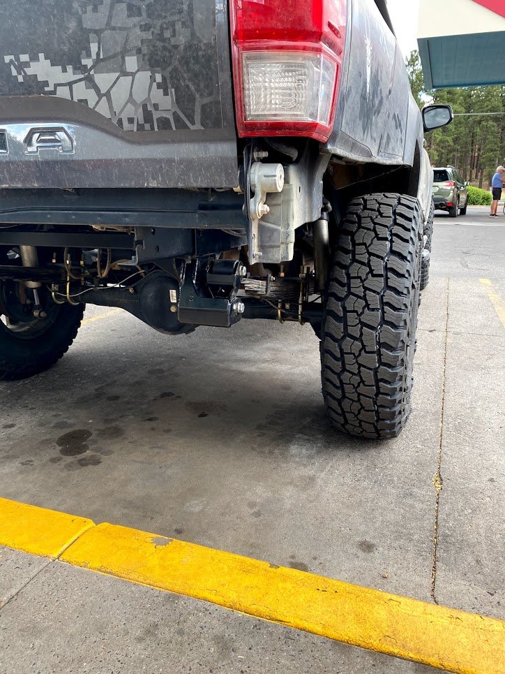

  7. Jun 26, 2021 at 6:20 PM
    #4167
    Sixthelement
    Apr 1, 2017
    #215083
    2,804
    Flagstaff
    24 F150
    Fox 2.0
    I have a slight rub in the same spot as the 285s with the spacers. I still have to full bump it to see where else its going to hit. That will be in a few weeks with some front end work.
    Lift is just Radflo coilovers and rear springs are All Dogs Performance pack. Waiting on shocks for rear relocation.

  10. Jun 26, 2021 at 9:18 PM
    #4170
    Sixthelement
    Apr 1, 2017
    #215083
    2,804
    Flagstaff
    24 F150
    Fox 2.0
    I'm regeared, 5.29s. Probably sitting about 2"+lil bit in the front. I do have an agressive CMC and with LCA at full max caster pushed forward the rub I get is right at the rear of the wheel well where the flare is.
    Stay 33s, still regear. Unless your building for specific purpose. Mine is to run Prichett canyon, Rubi and a few other trails next year.
