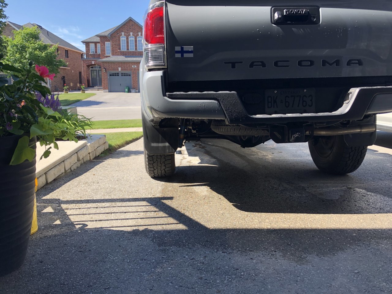

    Photo of the 255/70R17 nokian rotiiva

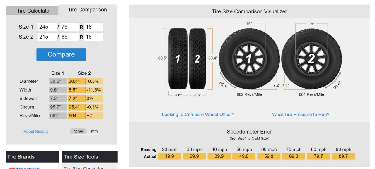

    Same diameter, sure, but the recommended wheel width for those is 5.5-7” wide. Even with a 7” wide wheel you’ll be taking some off the diameter and less able to air down quite as much. Just things to consider going that skinny on a truck (then off roading the trails you mentioned with them).

    Those look great online, thank you. Look smaller than a 255 on the truck tho! But I suppose we’re only talking a few mm’s.

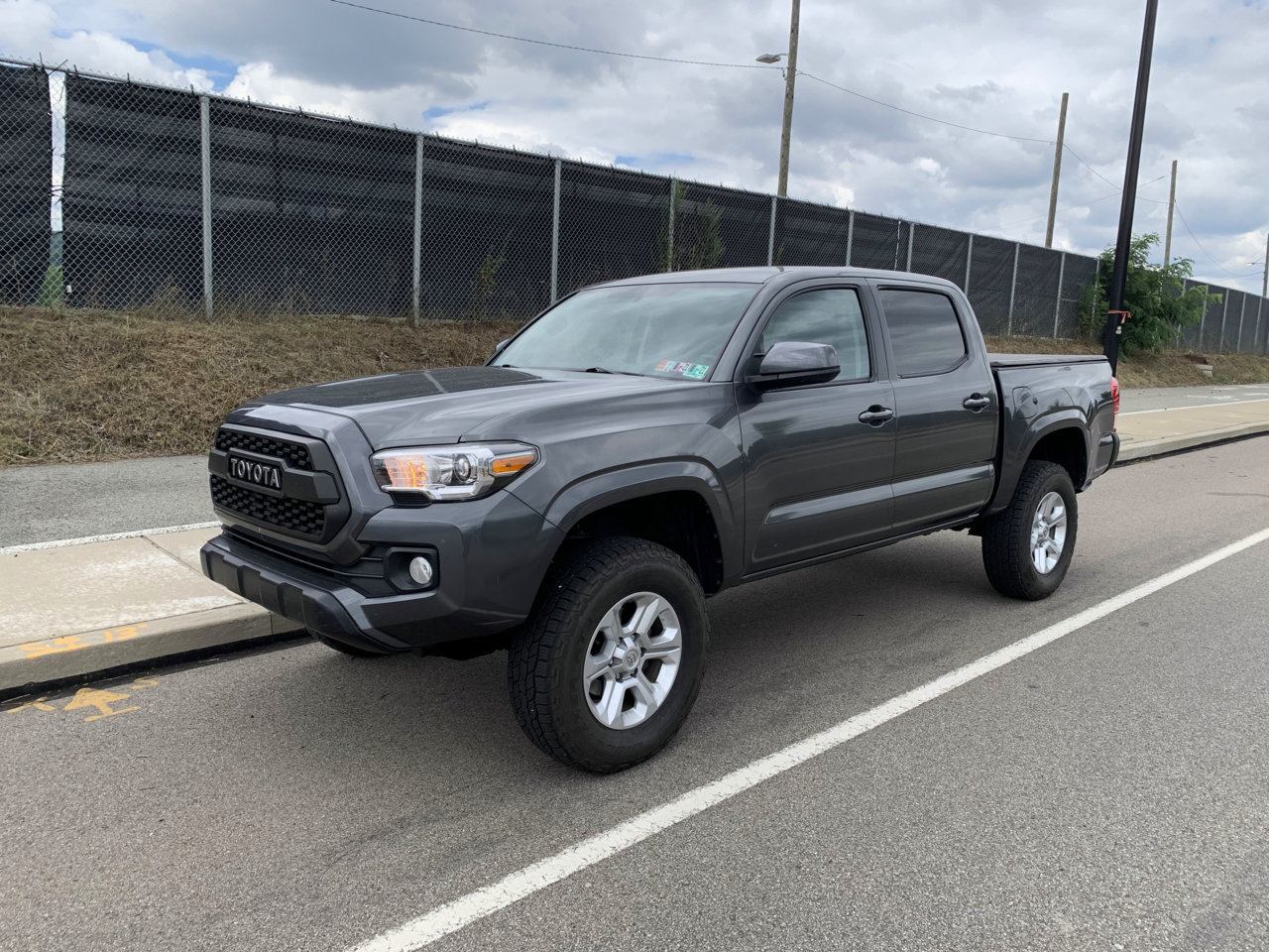

    Not Geolander’s but meets some of your requests. 255/75R17 Cooper AT3 4S on Bilstein 5100 all around (4th notch, 1.5” single AAL)

    Looking great!! My color too. I think I saved this photo from another thread bc I loved the stance. 4th notch seems right to me, though I might throw a block in the back to keep some minor rake.
    Also Have to look into whether the 255/7?/16s will fit on some SCS…someday. Right now I’m actually digging the ‘21 stock SR5 black rims.
    But thank you, man, this is really helpful.
