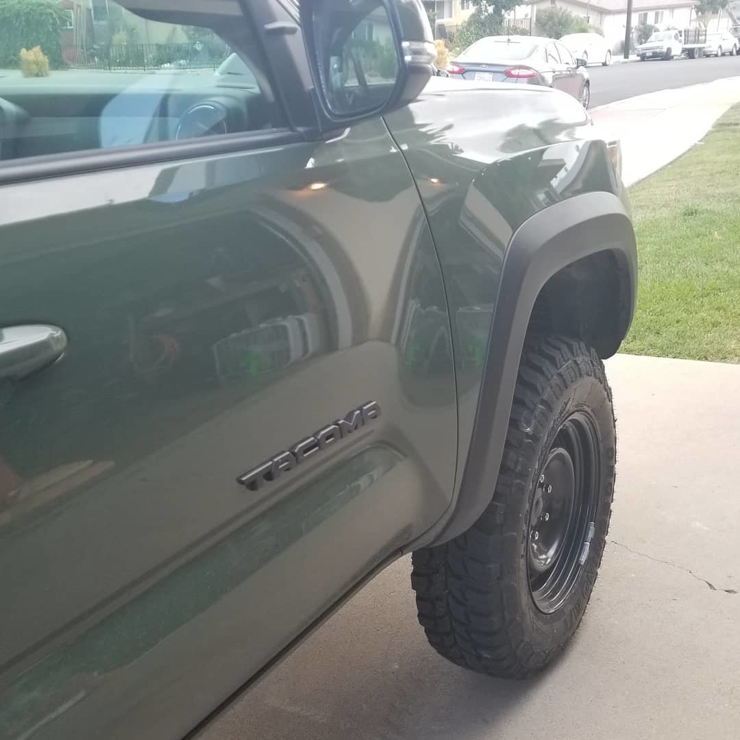

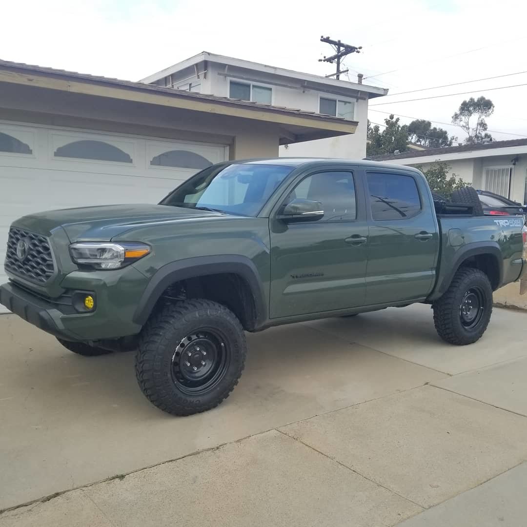

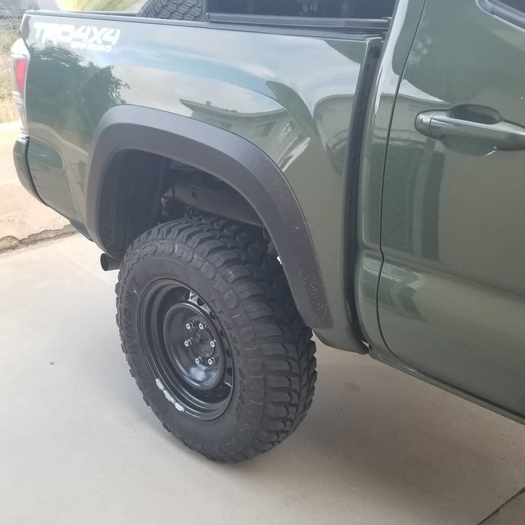

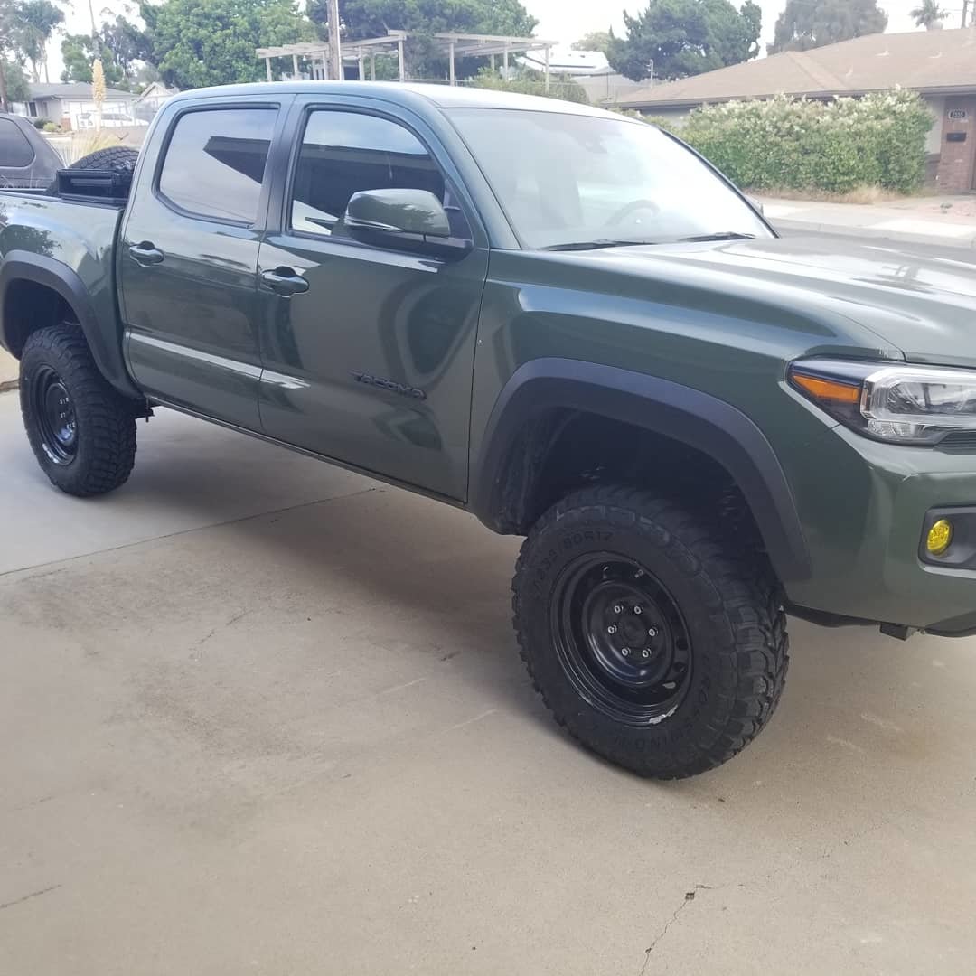

    quoted from my build thread. stoked i got these Toyo 255/80/17s to fit in the spare location!

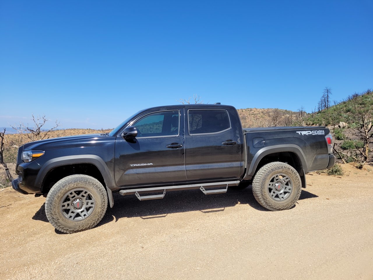

    I have a 3/2 lift on a 2021 4x4 20210605_152510.jpg 2021-07-08_15-52-31.jpg offroad. I wanted to avoid the rubbing that I had with my 2010 Sport running 285/75R16. Once lifted the factory 265/70R16 on oem wheels was really close to the UCAs. I decided that I wanted to push them out just a bit, so I sold my oem wheels and Goodyear Kelvalr SLs and purchased the gun metal SEMA wheels. I thought the gunmetal would give me a nice contrast. I have no rubbing and could probably go to 34 or 35" by just removing the front flaps. Lift and alignment was all done by Toyota dealer. Highway road and offroad traction are great with these Wildpeaks. I didnt notice any difference in power due to bigger tires. Looking at adding a low rack or bars and a HTT for some camping trips.
