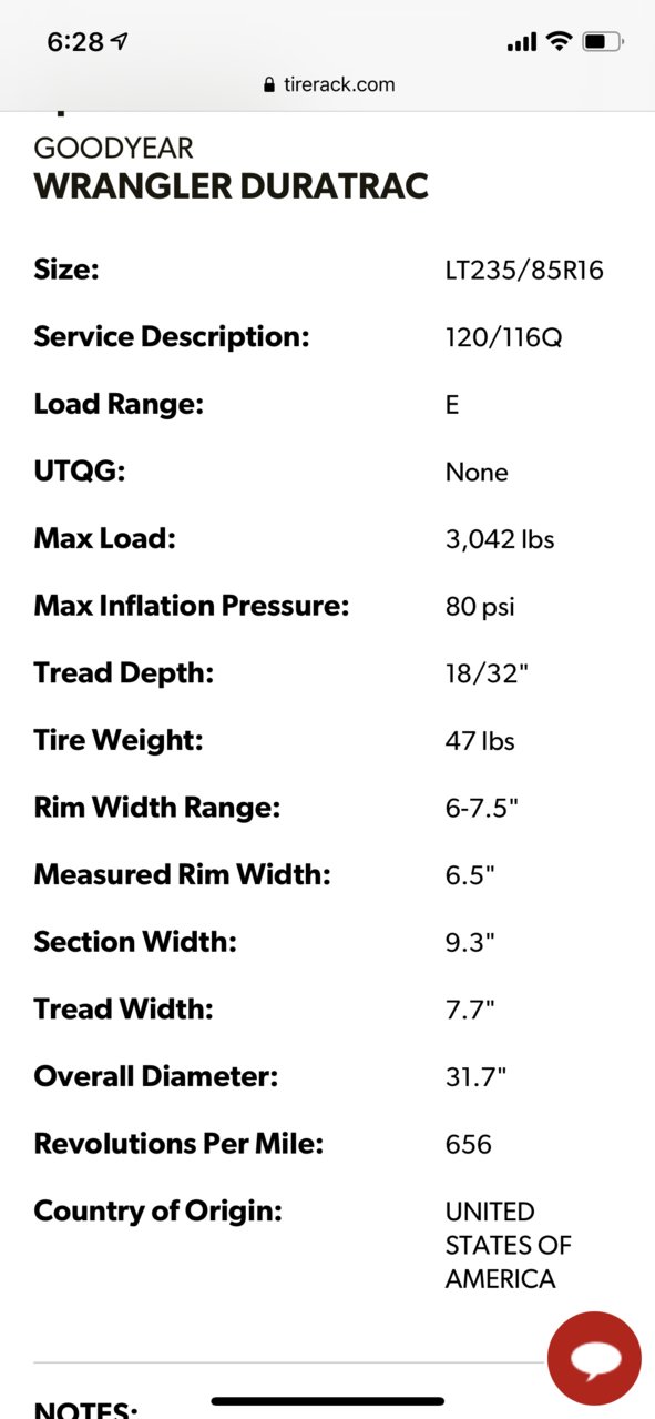

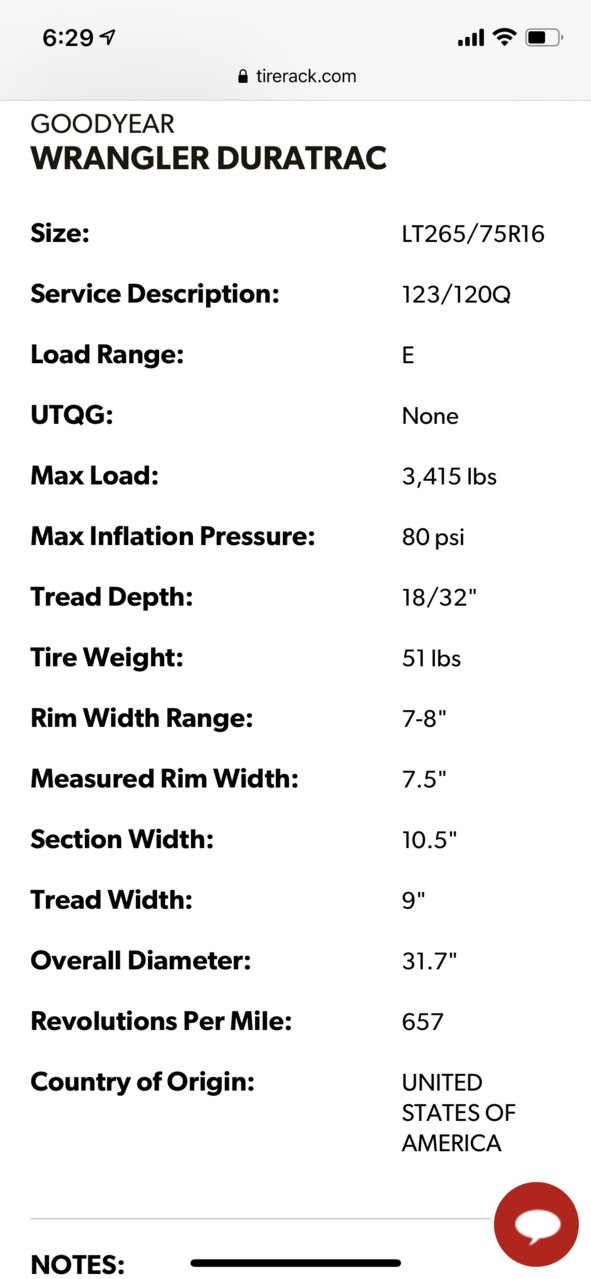

    they make that size in C load duratracs. 50 lbs is still a pretty heavy tire

    I meant to say the 265/75r16 come in C load or even SL if you don’t off-road and those are very very light. Alternatively you could get some light weight wheels to offset the difference.
    235’s are REAL skinny and look disproportionate IMHO.

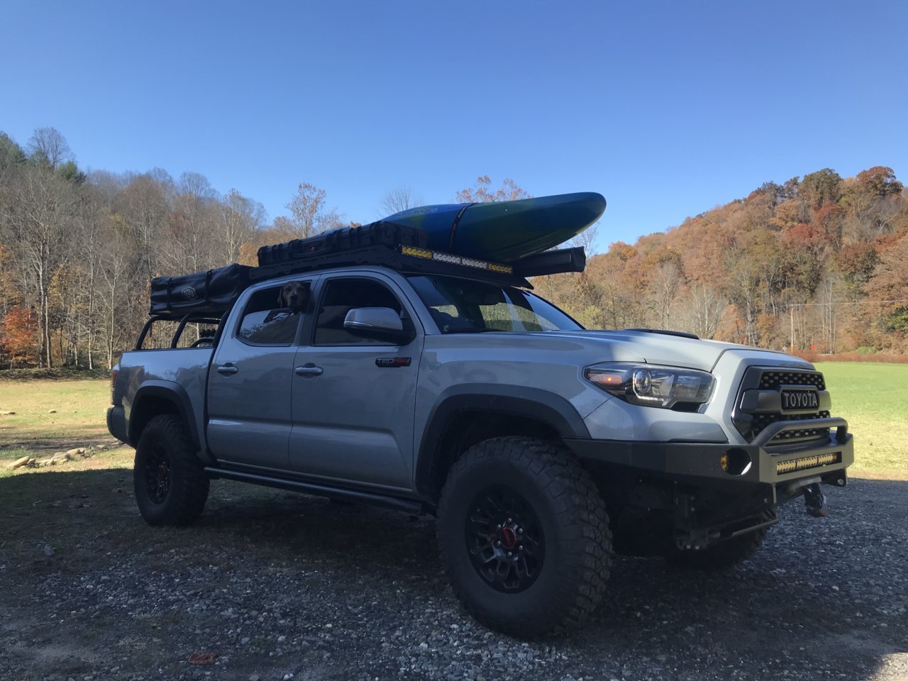

    What size were these? doesn't look bad at all!

    255/85/16 BFG KM3
    If I stayed at this size I would have gotten a different brand next go around. I loved the tires, but the foot print of the tread is wider on other manufacturers. These skinnies got even skinnier from the side wall down to the tread. If that makes sense.
