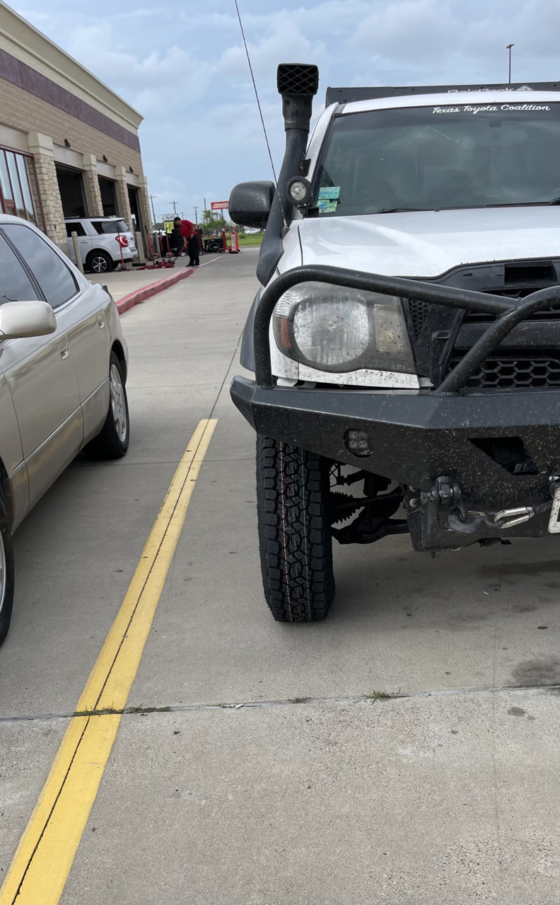

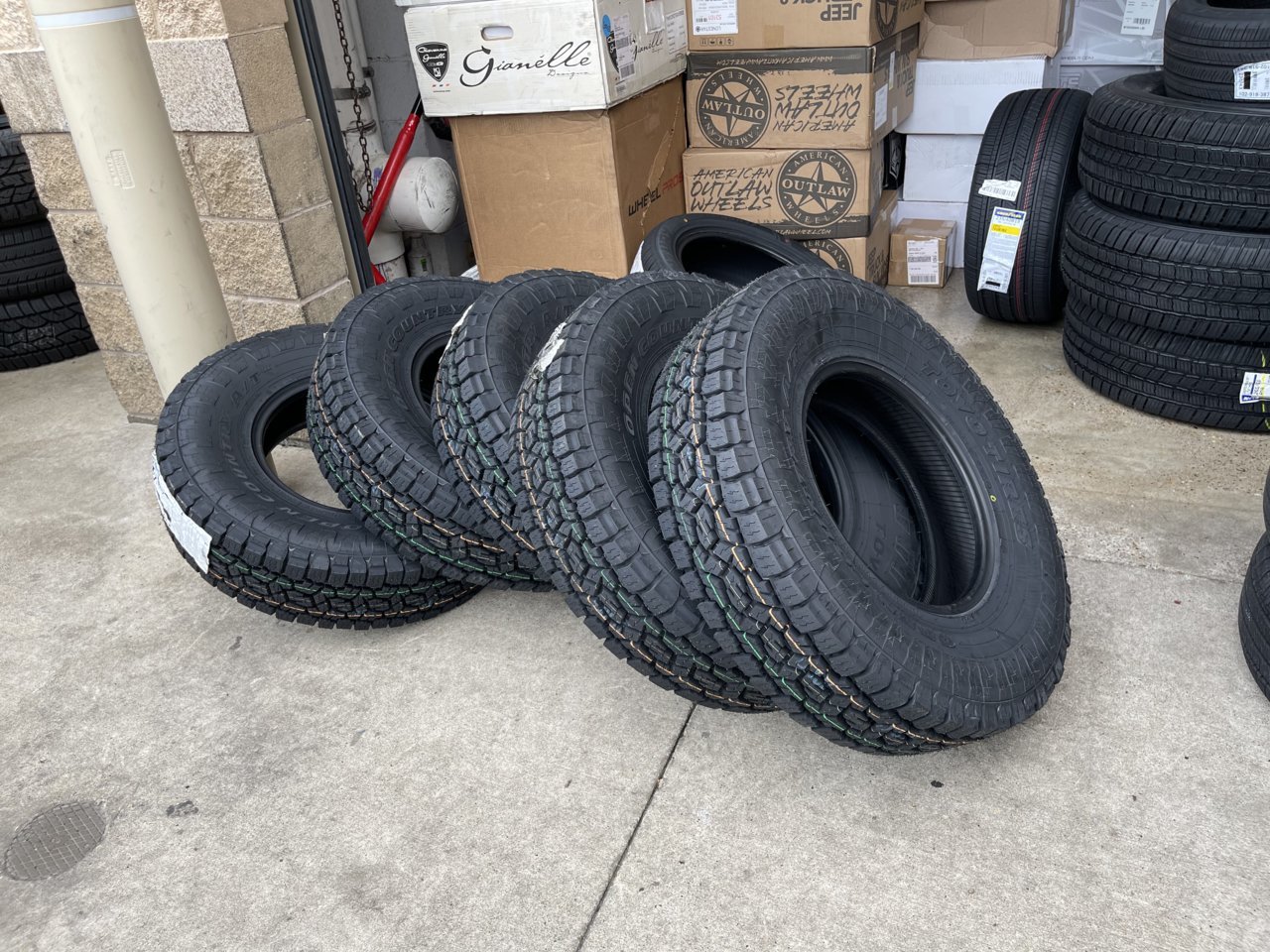

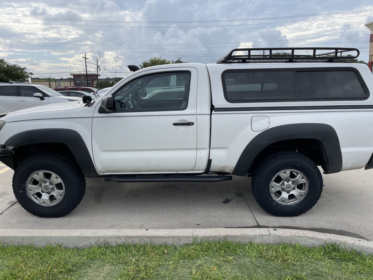

    AF018F57-6A41-4465-AAA6-BB2C556A66C0.jpg CFB9613A-A18A-4FE5-9CFA-B4E5A798515B.jpg 117DF87C-F494-4132-AE69-50D28E695C28.jpg 235 85 r16 weenie whistles. Toyo At3
    they is skinny af :anonymous:

    Dang, that is reeeeally skinny.

    That 235 looks like a donut on that truck.
