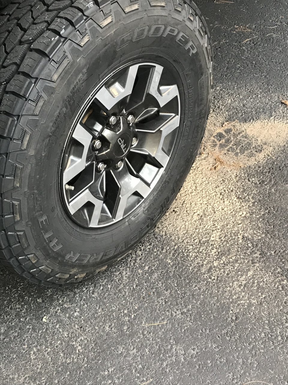

    Hey y’all, just got an 04 double cab TRD Tacoma.
    bilstein 5125 and add a leaf, 2in lift all around.
    rolling on 17” steelies and 255/80/17 cooper discover load E rating.
    I’m getting steering wheel wobble at speeds 55-65 mph, the PO said that it’s the tires because they are more narrow and taller with a high load rating it’s part of the drawbacks.
    How is everyone’s truck driving with these tires? Also I am getting 14-15 mpg…would a lower load rating and shorter tire help? The taco is my daily and about once a month I got into trails and camp etc.

    I had the same tire years ago in. 255/85R16 and had the same issues. No amount of balancing fixed it. Switched to Toyo MT in the same size and issue went away.

    If you are referring to the ST Maxx, albeit a great tire, they have some known shortcomings; pulling to one side or the other and balancing issues are examples of some.
    Any E rated tire is going to be heavier than a lower rated compound tire. So yes, going to a lower rated and/or smaller tire will improve your fuel economy.
    255/80/17 and 255/85/16 are almost identical sizes, just for different wheel sizes.

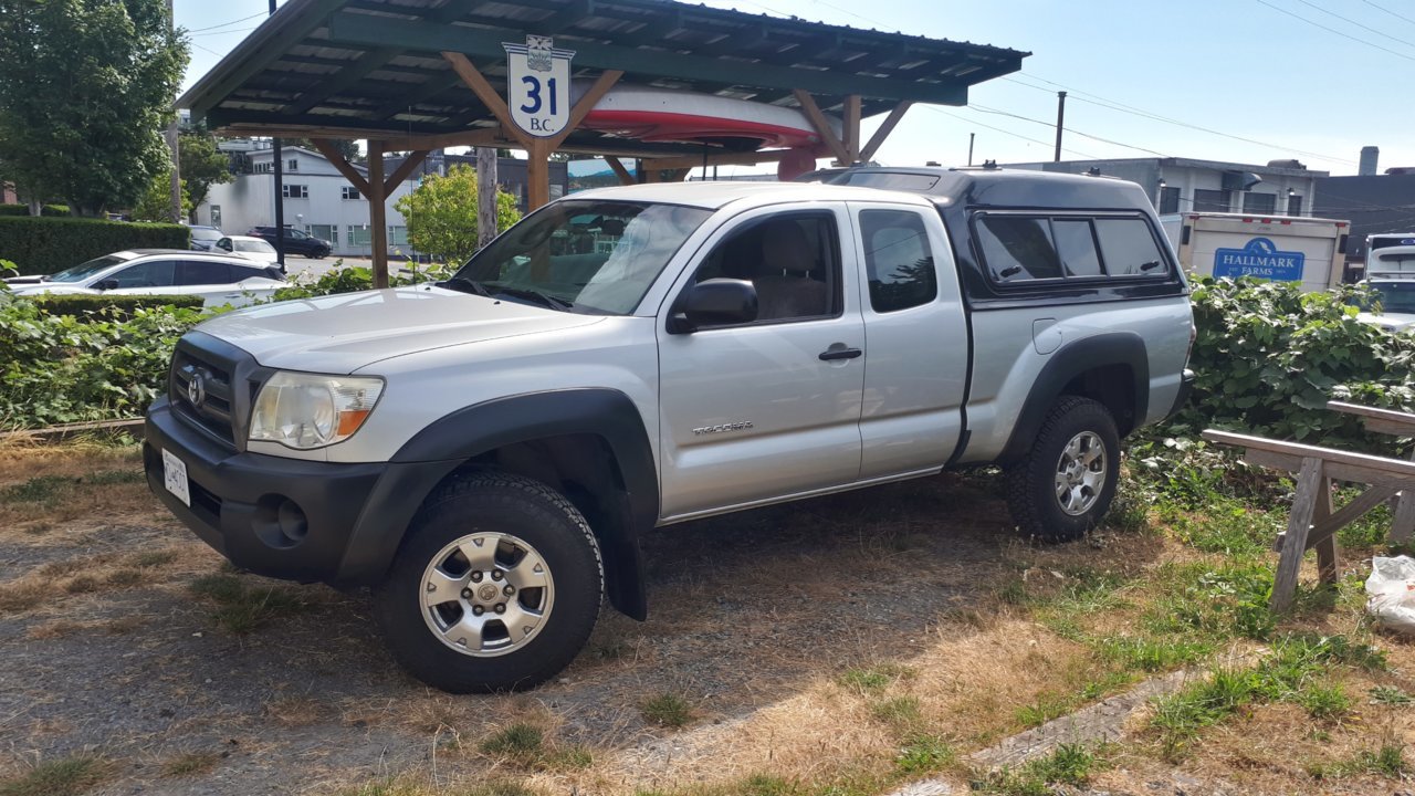

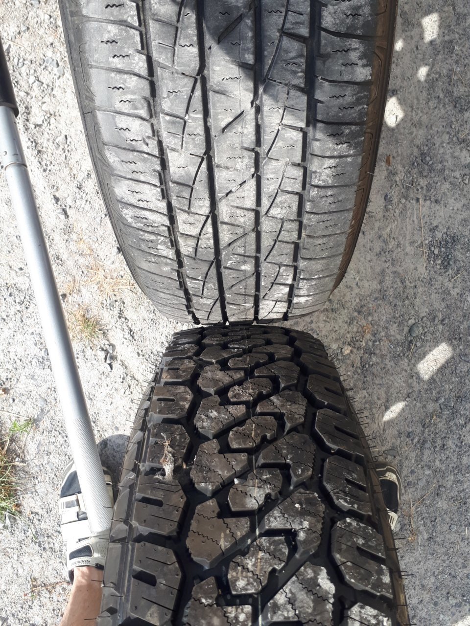

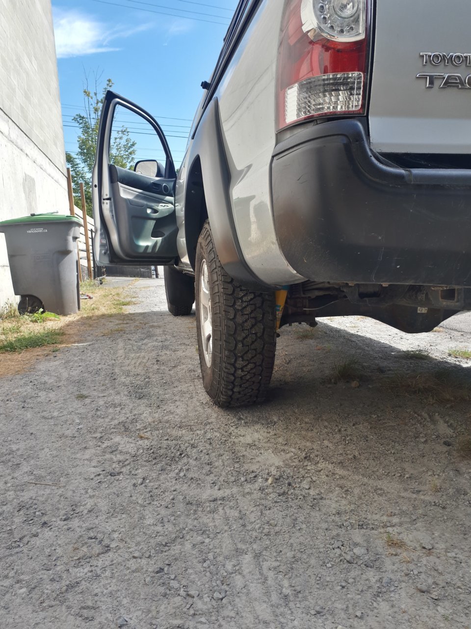

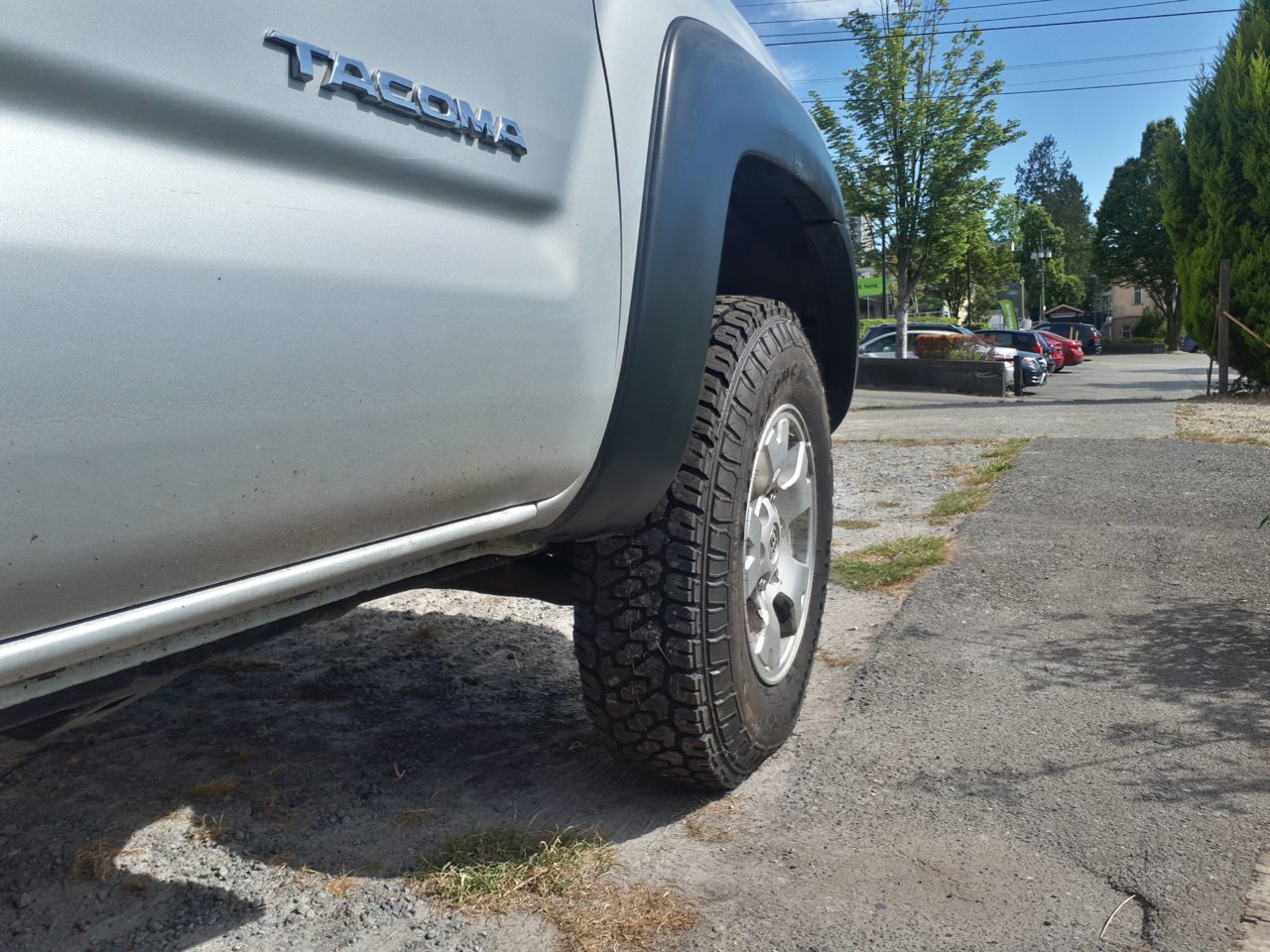

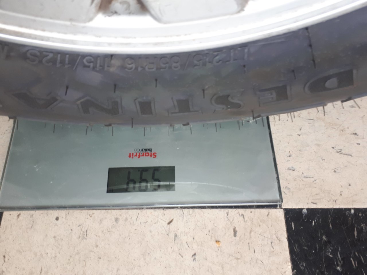

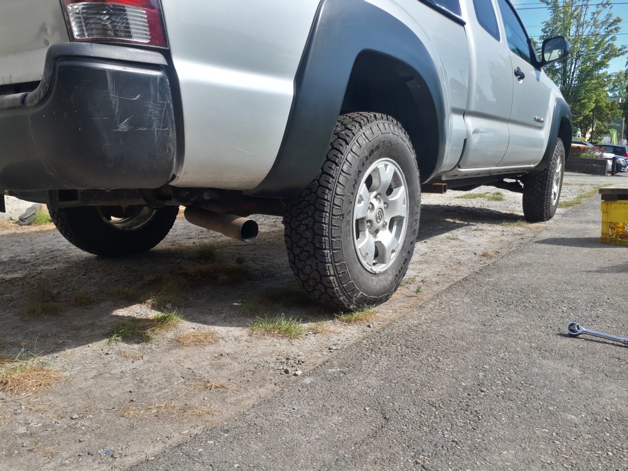

    I've wanted to get skinny tires for a while, but am pretty particular. Most of the time I roll on P rated 245/75 R16 General Grabber HTS 60's on alloy rims, as I want good wet weather traction, acceleration, and the best fuel economy I can get in a quiet tire. If I'm heading off the beaten path, I have a set BFG KO's in the same size on steel wheels. They are bullet proof, get at least 10% worse fuel economy, are not great in the snow, and loud. Truck feels like it is going up a constant incline as well. I'm not doing any massive offroading, so was looking for a happy medium. Something with a good tread and puncture resistance, as well as a good load rating, as I am constantly hauling gravel and stuff with this truck. I also wanted something that would work well in the snow, and not be as heavy as the BFG's.
    I also wanted something skinny (did I mention that yet;)
    I researched the crap outta tires and picked up a set of beater alloy rims that are starting to flake paint, but will be used in the winter anyway, so i don't really care about the aesthetics.

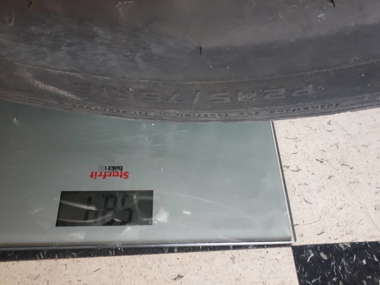

    Decided to go with some Firestone Destination XT's in an LT215/85 R16, as they weigh about a pound heavier per wheel than the P rated tires and are pretty much exactly the same circumference. That and these are absolutely the skinniest 16" tires you can buy (did I mention I like skinny tires?), and even if they did make a skinnier tire, I'd have to get narrower rims, as the stock wheels are 7" and that is as wide as you can go with a 215.
    I'd considered 235/85's but didn't want to make 1st gear any taller; it's already pretty tall with the older 5spd manual.
    I have the 4 leaf TSB spring pack and airbag suspension, so I have lifted the front with Bilstein 5100's set to the .85"+ ride height.
    I just had my alignment done today and mounted the new tires and wheels. Pretty happy with the short drive I took them on. Apparently they work very well in the wet snow we get here on the coast. I have chains for all 4 tires, so I'm not too worried, and that was another reason for not going to a larger tire size; I wanted to leave clearance for chains. I'll update after I have a few more km's on them

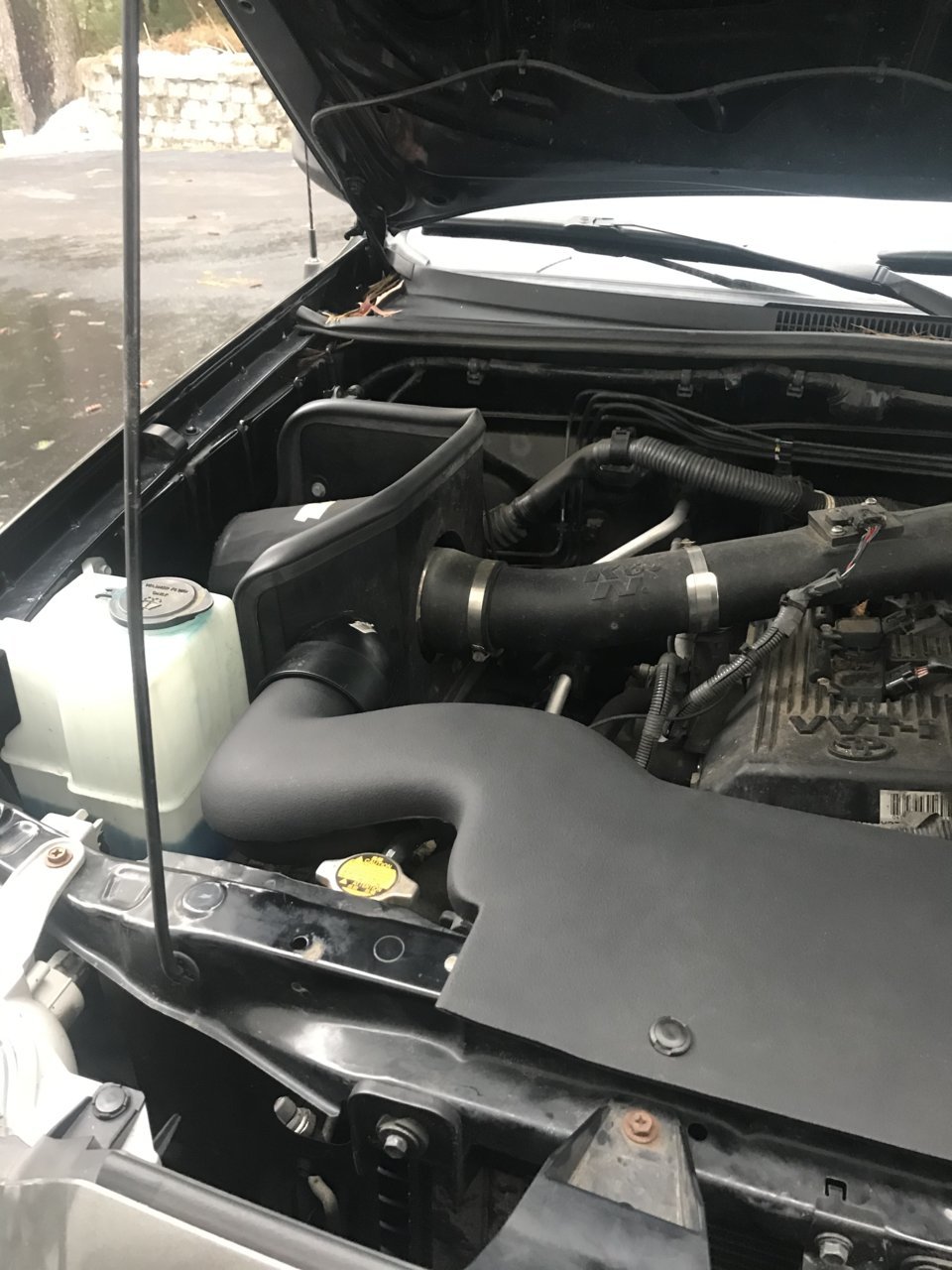

    2.25 inch lift, Firestone airbags, 235/85/16 tires, k&n 63 series cold air intake, LCE header and exhaust, nfab prerunner light bar, trd skid plate 3rd gen oem knock off, ecometer, kc lights, trd grill emblem, trifold bed cover, cb radio and antenna, pedal commander, volant ram air scoop, daystar airbag cradles, trd off road 3rd gen rims, hood hinge light mounts, bilstein 5100 shocks and 5100 struts set at 1.75 lift, strut spacers to gain . 5 more inches of lift, Jba standard high caster upper control arms
    I’m running 235 85 cooper discoverer at3 LT and they weigh at 43 pounds, yes there heavier than stock but I did some engine mods to get the mpg’s back. And I must say I’m getting better mpg even if I had stock tires.
    regular cab 5 speed 4x4with 2.25 front lift on air bags in back and bils all around rolling on 3rd gen trd off road rims since there 7 pounds lighter than my stock steelies. I also have a pedal commander and a eco meter
