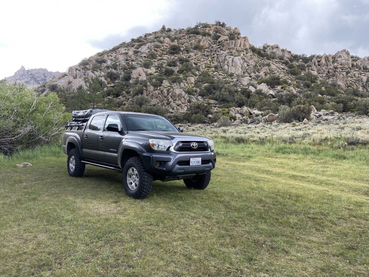

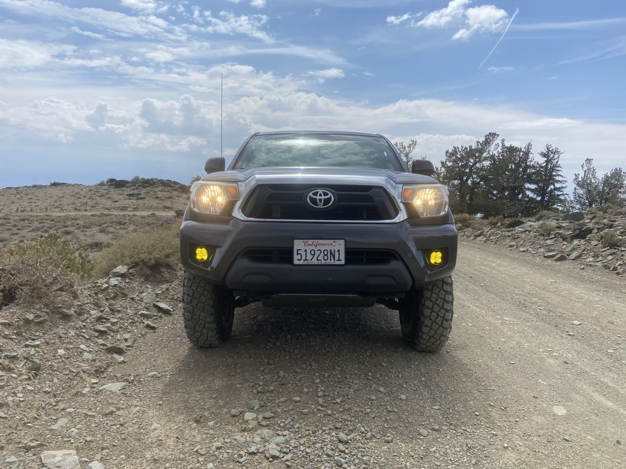

    Put the Baja Boss AT through some trails last weekend in southern Utah. Did awesome in the sand and slick rock. Then through a knarly mud test tonight to pull someone out. Aired down to 15psi pulled through no issues. Had easier time in deep nasty mud than on the slicked out hard pack; that was like ice. Just had to spin em a bit to clear and easy peasy.

    Sounds like a ton of fun. How they on the road? Noisy?

    Not yet. Only have maybe 2k miles on them.

    Those are cool rims!! What are they?

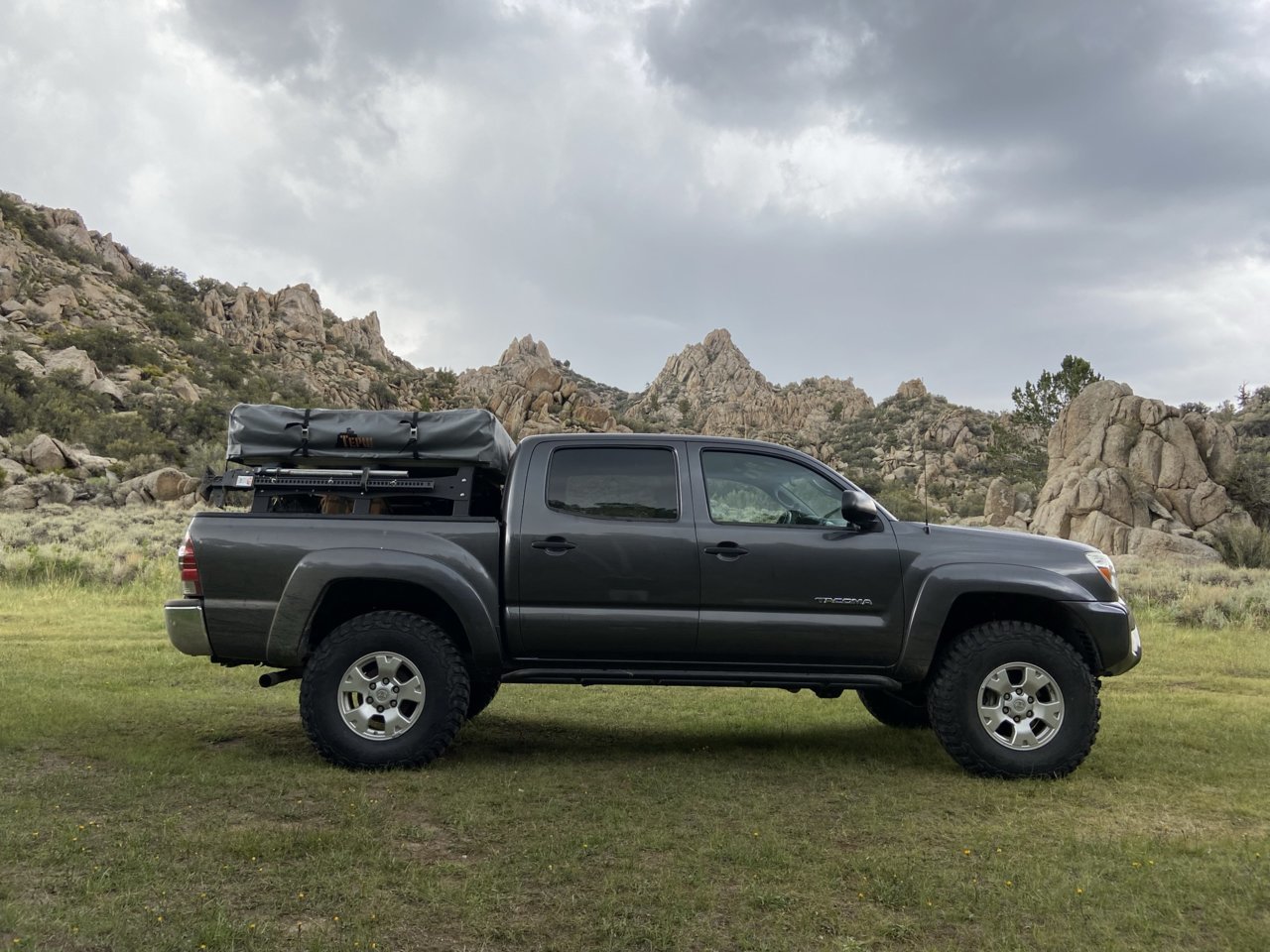

    What rack is that over you Softopper? But nice wheels

    Custom rack made.
    Wheels are just FJ/4Runner wheels with some plastidip on them.

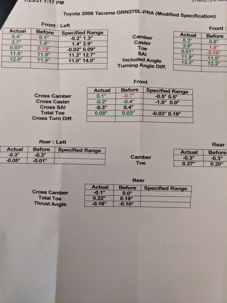

    So stoked on my 255/80/17 Toyo AT3s. It's been a thousand miles and they are great. Haven't taken them on dirt yet but I will soon. I had slight rubbing when reversing on inner fender liners, I just squeezed them away from the tires a bit by hand, no longer rubs in that spot. Teeny tiny bit of rubbing in the rear of the wheel well, that's gone after alignment. I have SPC UCAs so we had plenty of play. Love that these are just around 50lbs for eload... other options were much more weight. here's the specs on my alignment
    Thanks again everyone for all the tips and recommendations on skinnies. they don't even look that skinny

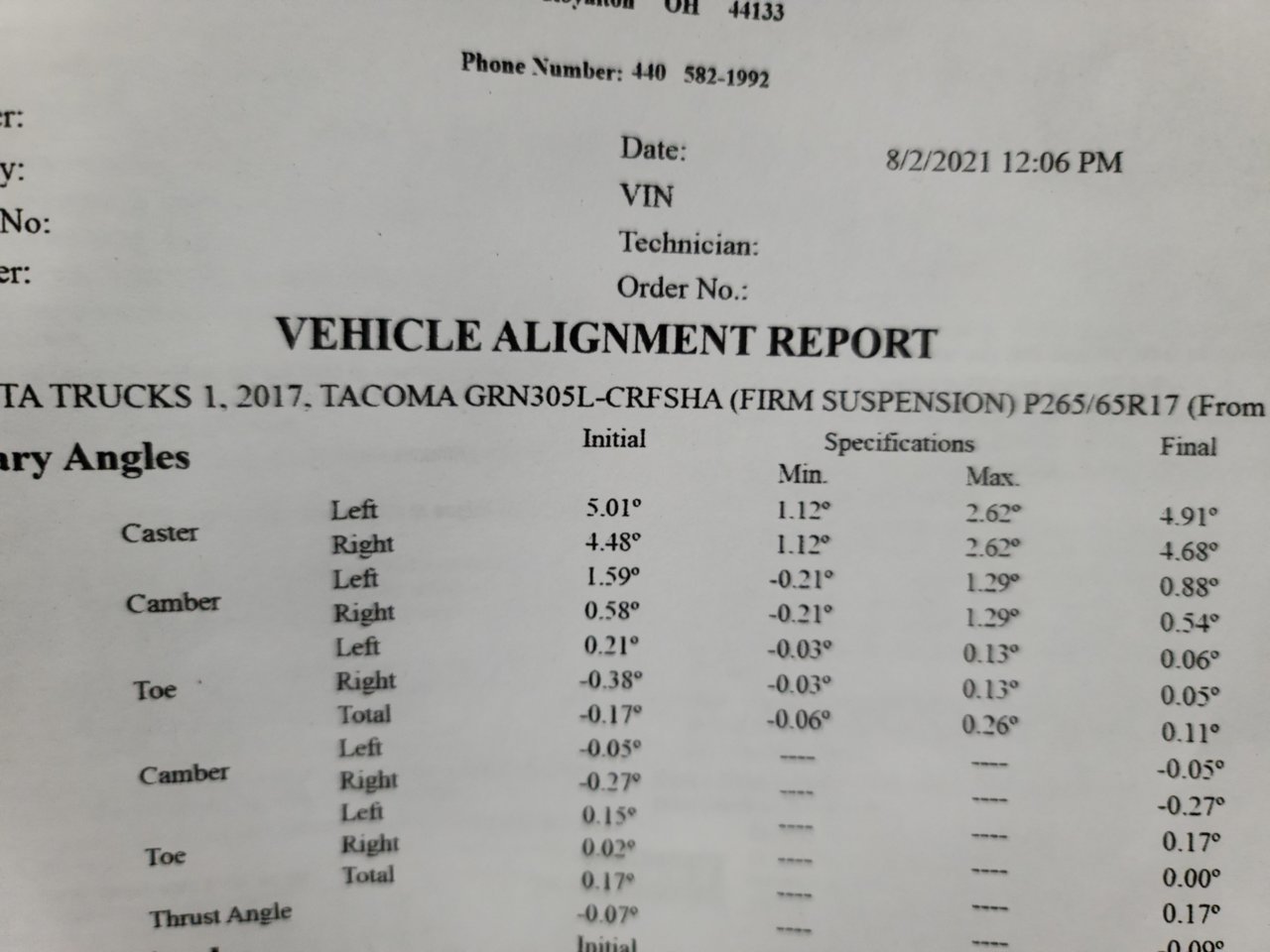

    I just installed Eibach pro kit on 1st clip, spc uca, icon progressive leaf. Still on 265/75/16, going to 255/80/17 considering toyo at3 still looking at wheels. Shop did alignment said they shoot for 4-5 ? My stearing wheel is little off. Probably go to another shop that specializes in off road vehicles, they said they do.. was gonna wait till i get new wheels an tires. 20210810_122043.jpg
