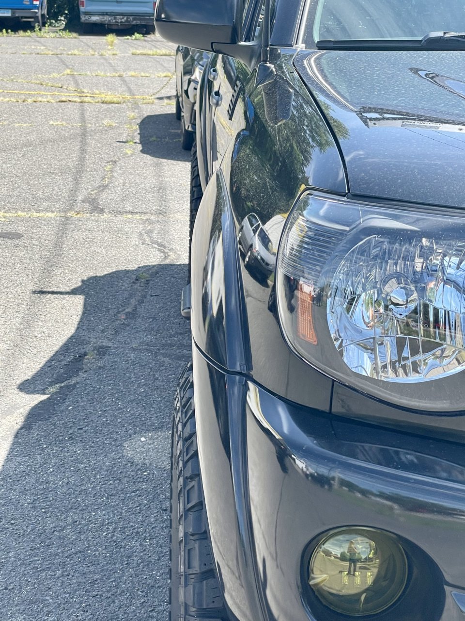

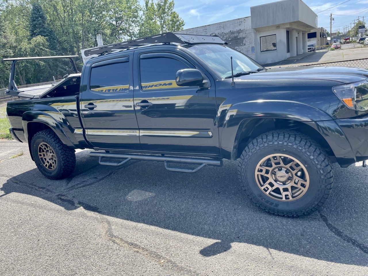

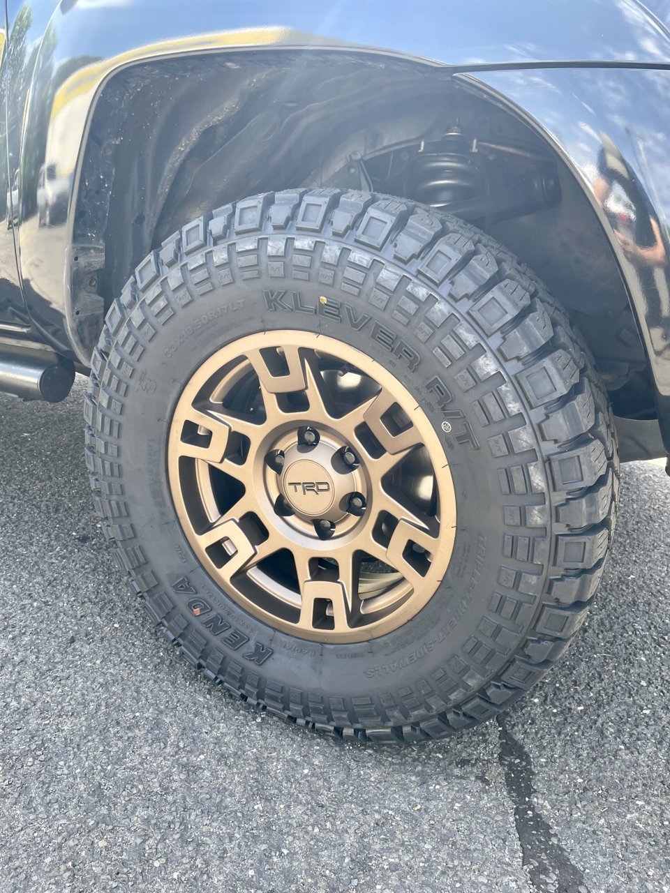

    A6235BBF-E63D-4B41-ADA3-3B714C9E1BB5.jpg These are mine skinnies
    2020 4runner TRD wheels -4 offset
    on Kenda Klever RT 33 10.5 x 17C8B628C5-BCDF-4CF4-8096-C7F5F6773046.jpgA9E3ACD7-FA4F-4B7B-A8A1-CF81643AADD3.jpg

    No,
    Front Old Man Emu 884 Coil with billies 5100
    Rear Icon 3leaf pack 1.5 added with overload
    roughly 2" lift all around
    Just removed front flaps
    no rubbing so far.

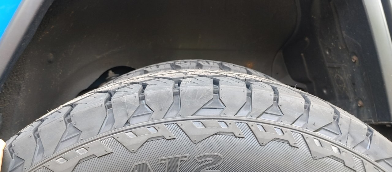

    So went with motonetal 970 17x8 0 offset with 255/75 Dynapro AT2. These should be a good set up for traction and mileage.

    Well I pick up the assembled wheels today can get you pics of them but truck is in shipping stage of production.
    Little over 1,5 inches taller and 1/2" narrower

    66
    Ken
    2021 Tacoma trd sport 07 FJ Cruiser
    sport- none yet FJ- Bilstien lift 33 x 12.5 BFG, TRD Exhaust, ECG third member
    Just picked up my set will be 2-3 weeks till the taco gets here.
    Slightly shorter than the 285/70-17 Bfg ko2 on the fj and noticably thinner.

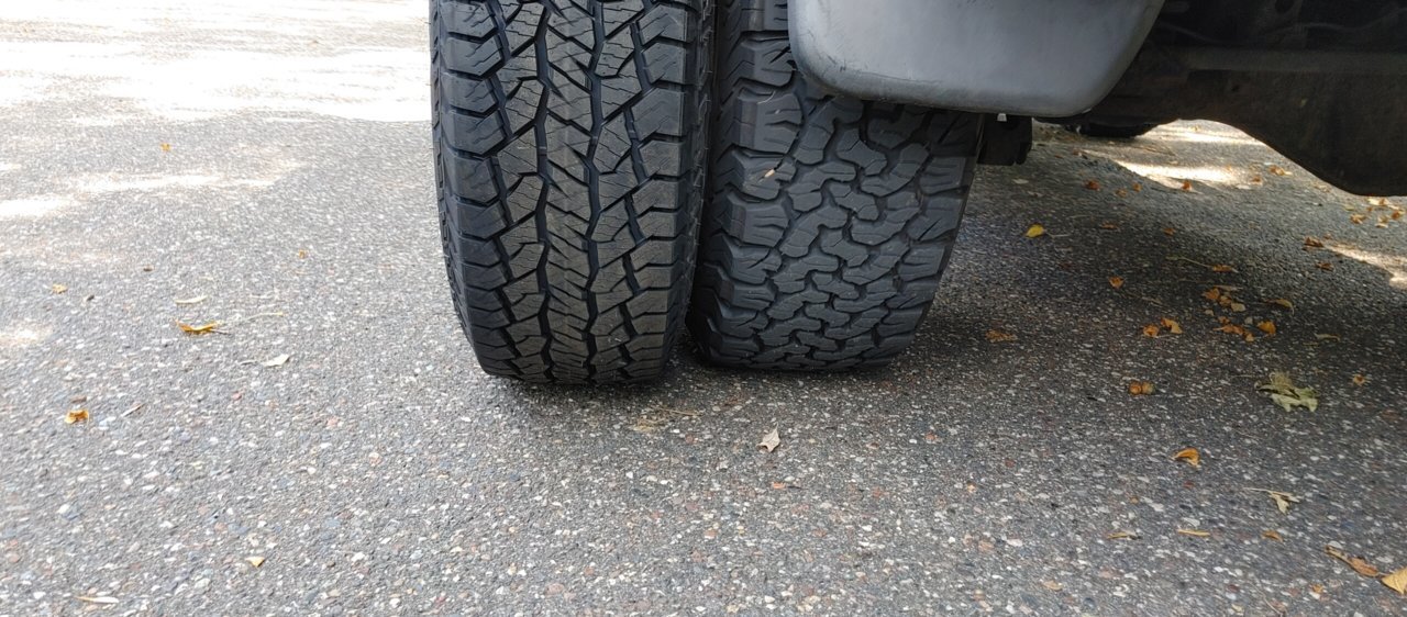

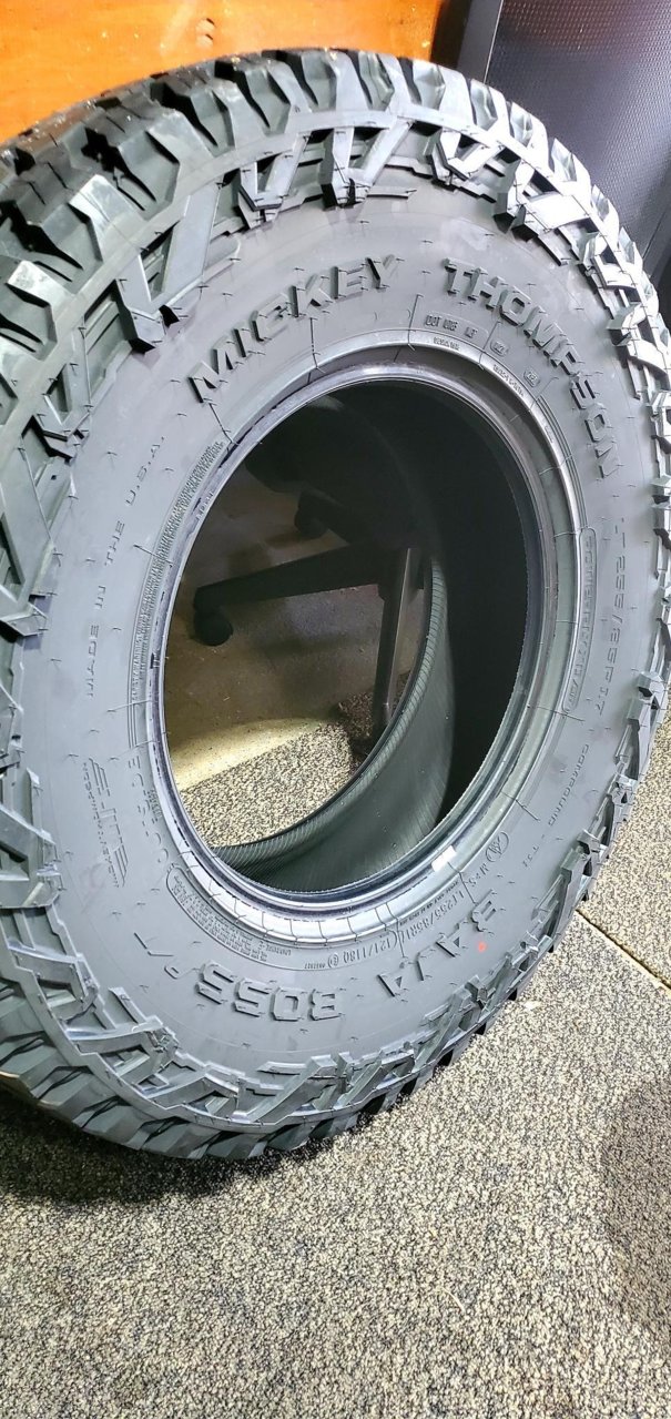

    A little preview
    255/85/17 Mickey Thompson Baja Boss's .... Last picture next to 285/75/17 Ridge grappler
