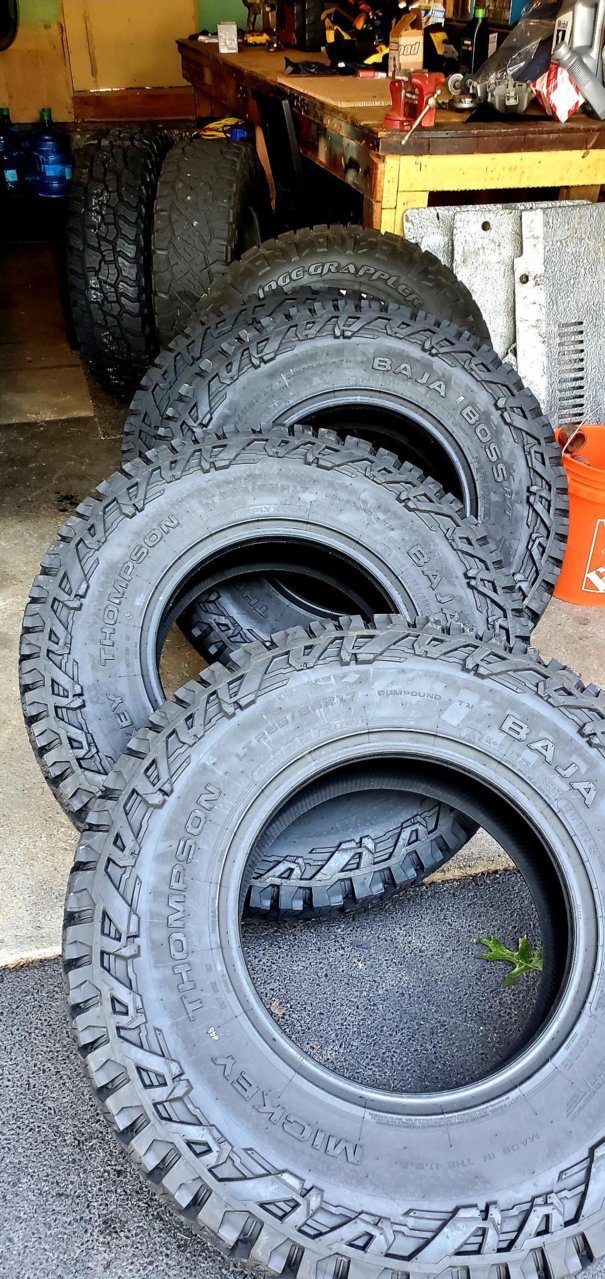

    Getting Closer!

    If I ever decide to move back to 17s after I get over my wheels that are currently incoming, these Mickey's are high up on my "need" list. Cant wait to see pics.

    I’m running the same wheels and they are the perfect offset for the skinny 35 setup. I did not have to trim my fenders except near the cab mount but I’ll be trimming them back a few inches at some point as I prepare the truck for eventual 37x12.5R17’s.
    From my experience, I recommend you pull the front struts and springs and cycle the suspension at full lock. You’ll need to hammer the pinch welds, firewall and inner fender. You’ll still rub a tiny bit but it’s as good as you’ll get without chopping up the inner fender. This will eventually go away after the tires wear a bit and the inner fender get self clearances my the tires. Adjust LCA all the way forward and make your final adjustments with your JBA UCAs to stay as far off the firewall as you can. Less caster in your UCA is actually better as it will move the wheel forward.
    Happy Hammering! :thumbsup:

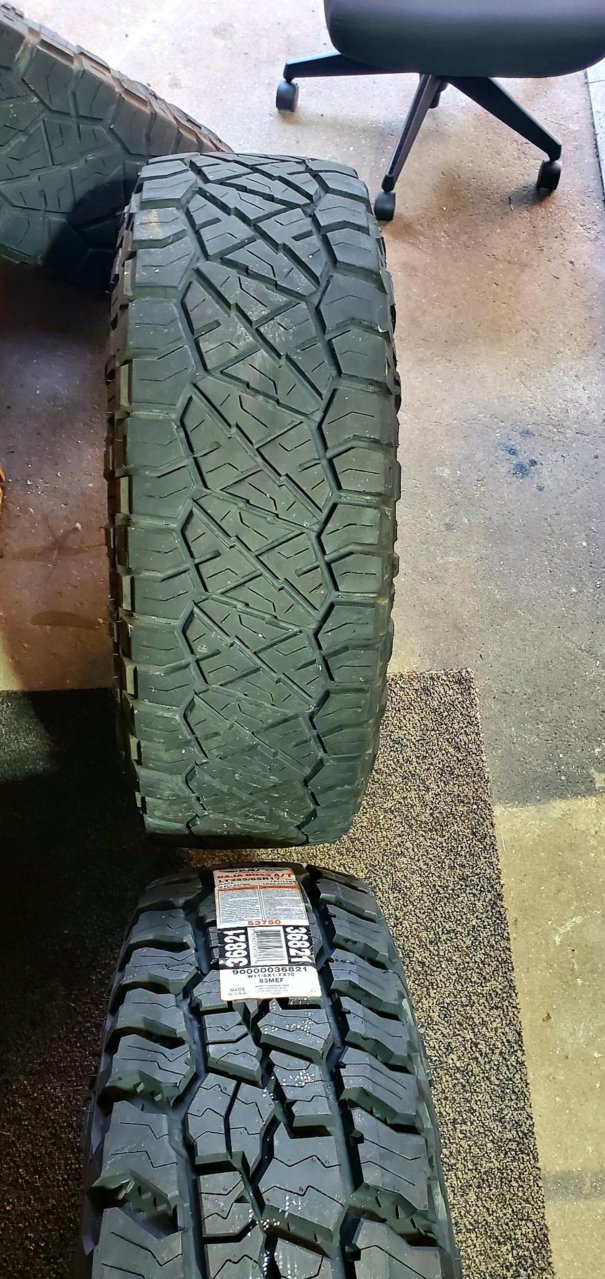

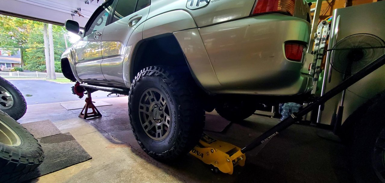

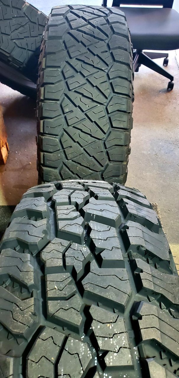

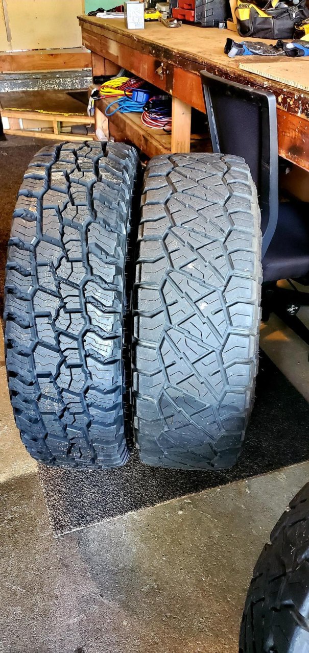

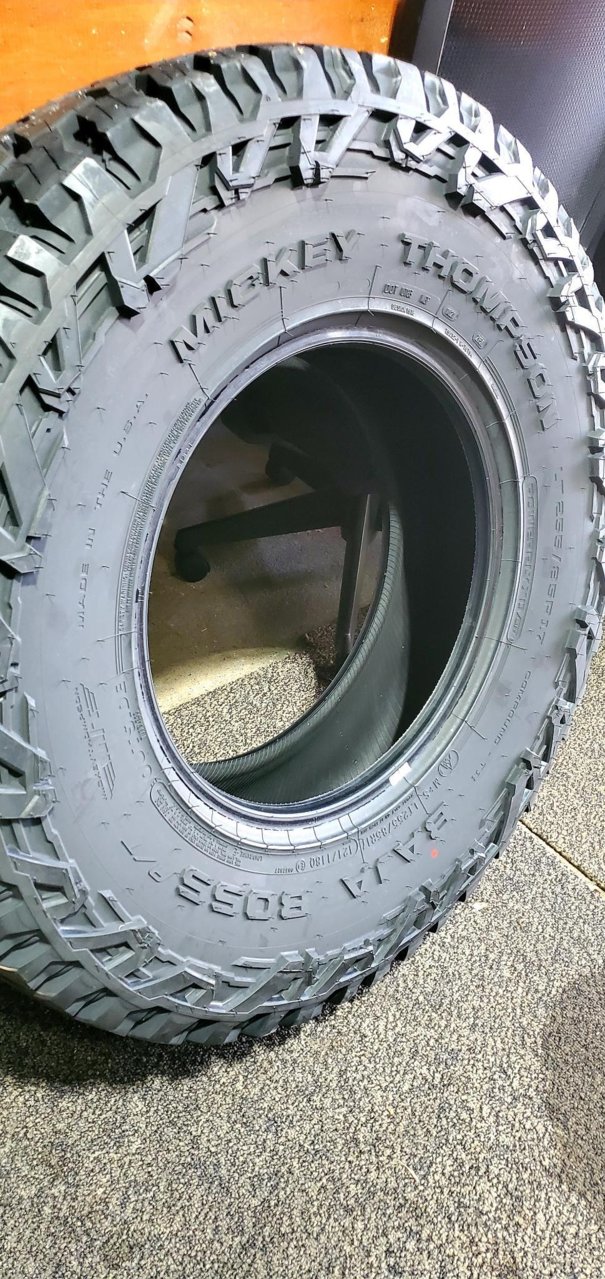

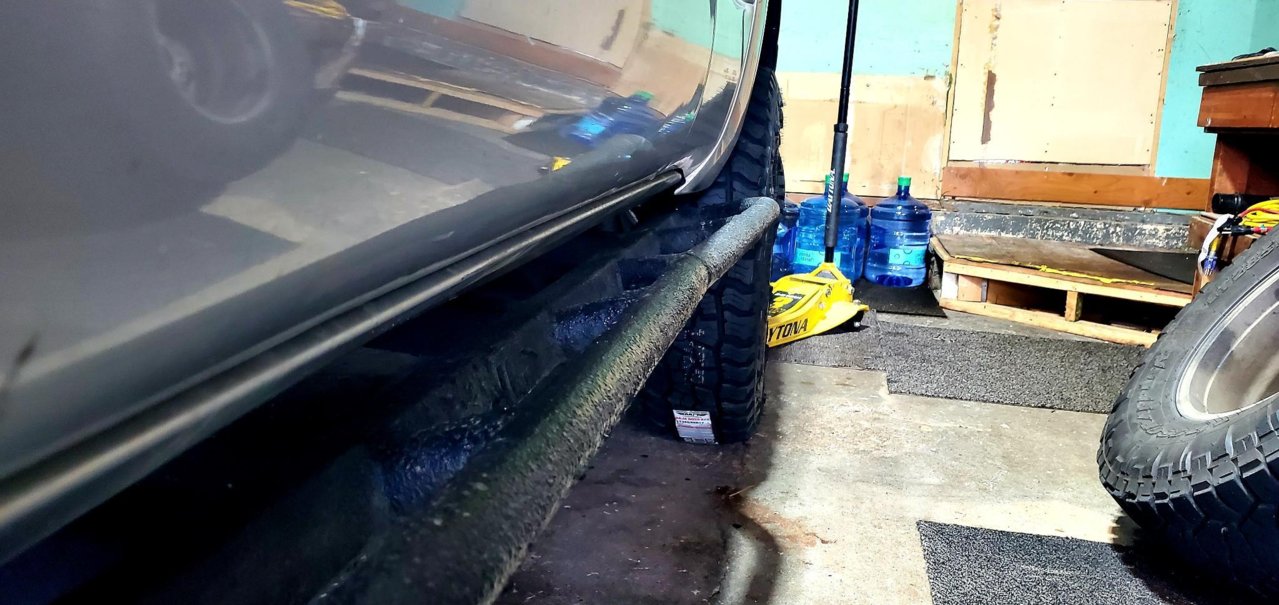

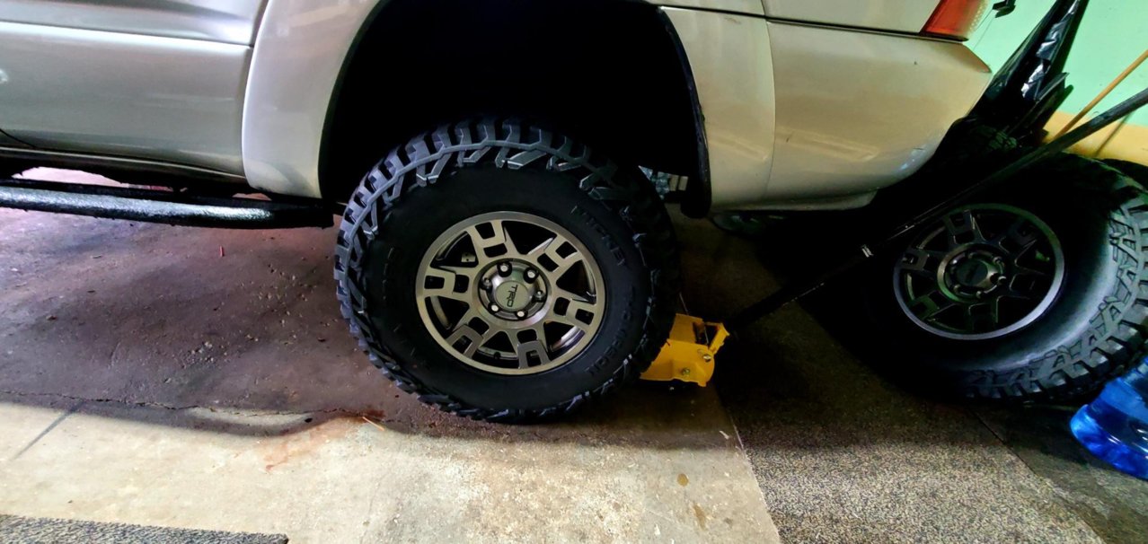

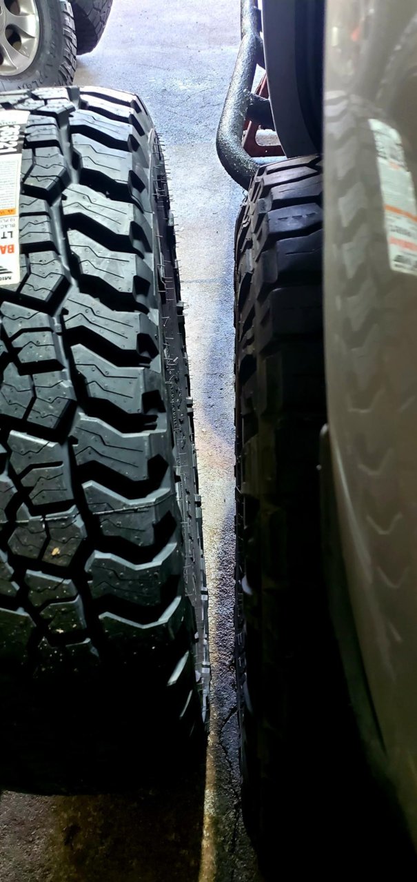

    Some Test Fitting and comparisons- 255/85/17 Baja Boss AT vs 285/75/17 Ridge Grapplers
    I cycled the rear up and down with the jack and looks like clearance is no problem, I Have bump stop extensions on there now, and im adding Durobump extended bump stop onto the extensions this weekend so no fenders will be popping off in the rear at least lol.

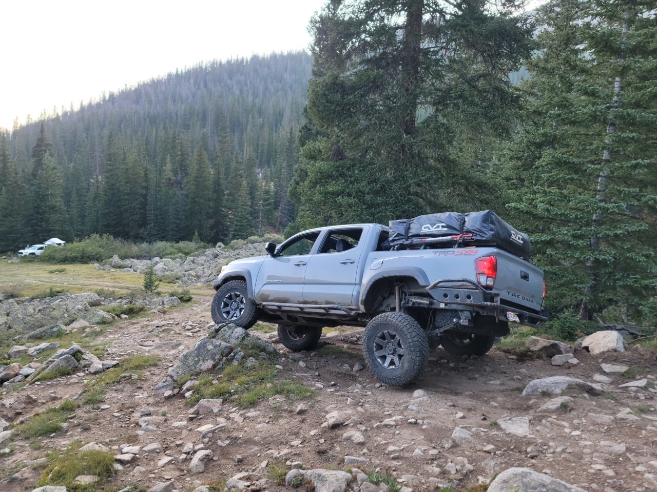

    The spare rubs the diff. I don't care. Metal beats rubber. I wheel every weekend so it is always rust free. Under the bed isn't the most ideal spot but for me but it's better than a tire carrier on the hard trails and I need my bed space.
