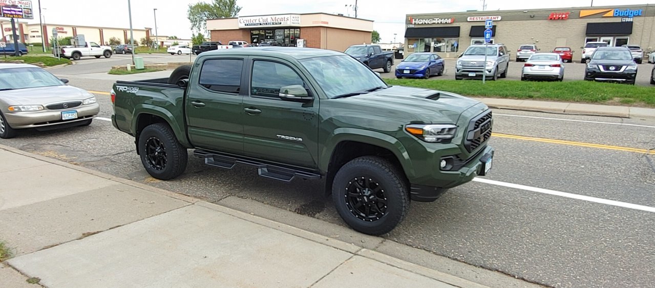

    4Runner/FJ wheels.
    bbSX-erFa6C3FVaHKk9JjWmnOMfKAegDtwxw4aU1_b43c09ff6aa05ea08bd519ac5efdc4671186401e.jpg

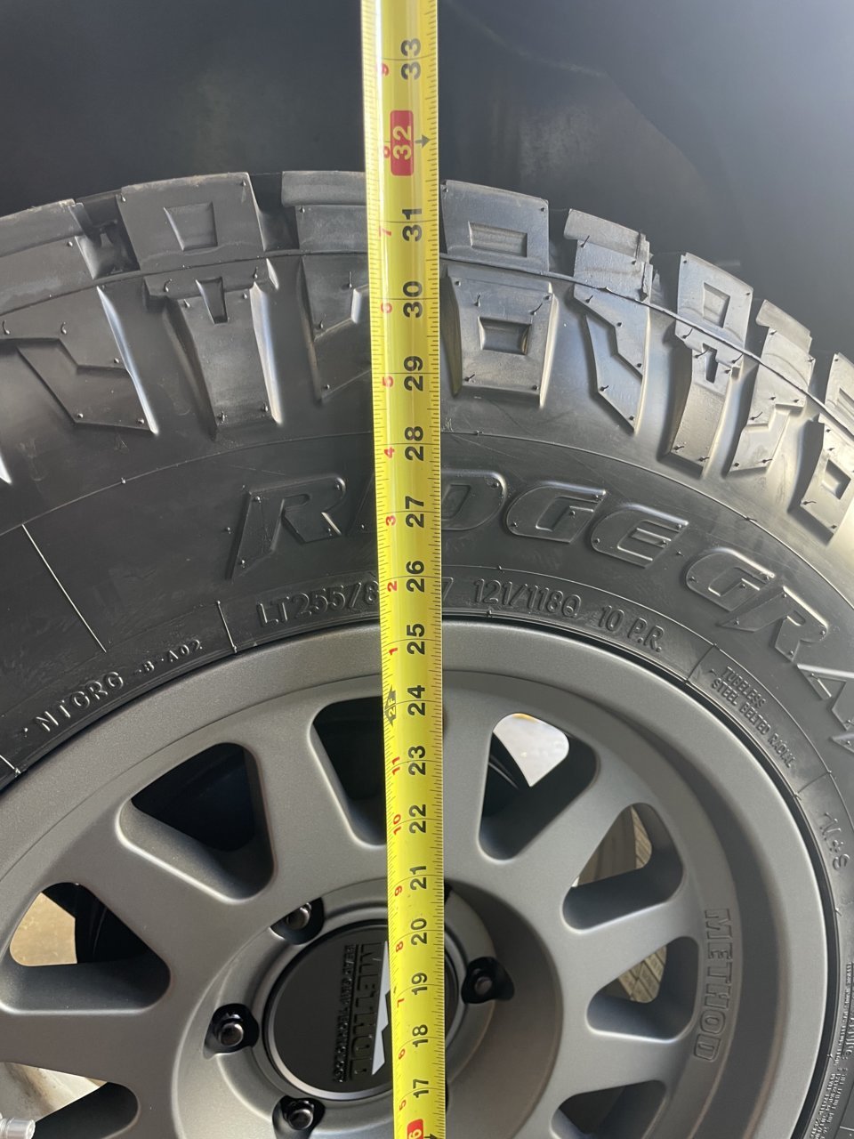

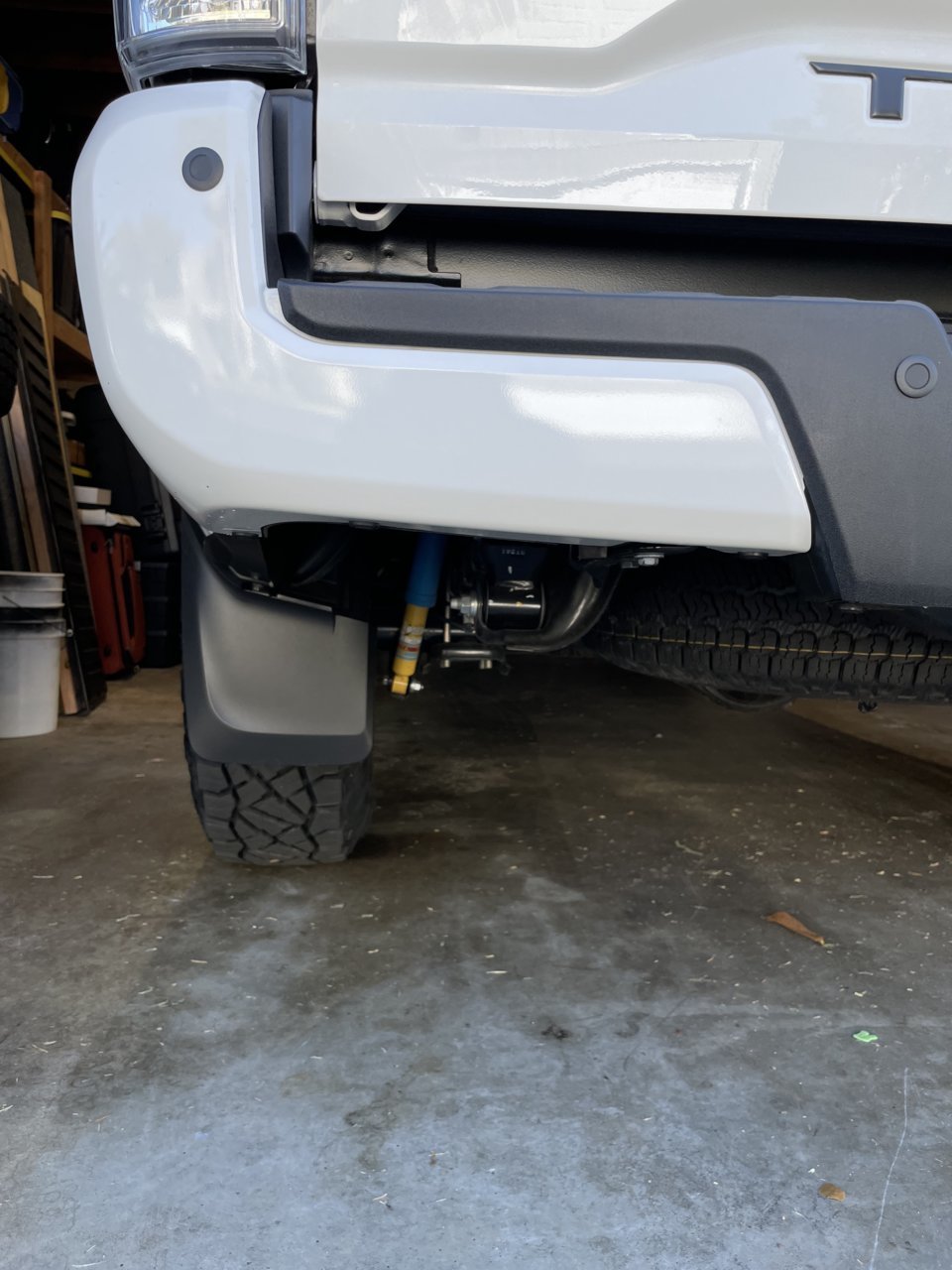

    Got my Ridge Grapplers in 255/80r17 and Method 704s installed yesterday. I'm on a stock suspension ('21 TRD OR 4x4). Had to remove the front mud flaps and trim the lining a bit along the inner edge. Still rubs a little! New suspension goes in later this week but some alignment magic would probably take care of it if I kept it stock.

    Touché. Overall super stoked on this combo. I was expecting though for the overall height to be closer to 33" than where I'm at per Nitto specs. The 0 offset is a nice improvement over OEM wheel offset.

    That's odd, they appear much closer to 32" than 33"... And you said you had some rubbing? I'm curious how much my 255/80r17s will rub with the 4Runner TRD wheels. I'll report back next week.

    Yep they rubbed hard on the front mud flaps and got caught a bit on the liner at near full lock after removing

    No tire meets manufacture specs once mounted and under the weight of the truck! Tires are measured from the manufacturer unmounted or on a rim that is typically in the middle of the suggested rim width with no load on them. Changing the offset to sit out further in the wheel well almost always leads to rubbing! Stock wheels are the secret here.

    Most people seem to think wheels sticking out the wheel well means less rubbing. It's the opposite.
