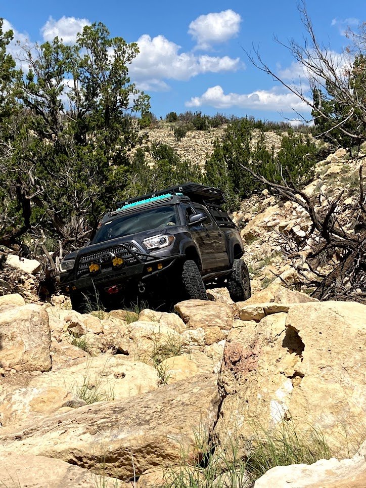

    On a local trail.

    Definitely curious as to just how big they actually are and how much trimming was required compared to the typical 35. I'm figuring the trimming is more similar to what you'd be doing for a 285.

    They definitely rub more than my 34s 285-75-R17

    and I assume they don’t fit in the spare location?

    Probably not. I run HH and the cross brace so no spare spot for my anyways.

    Looks like you had fun on this rocky trail adventure.

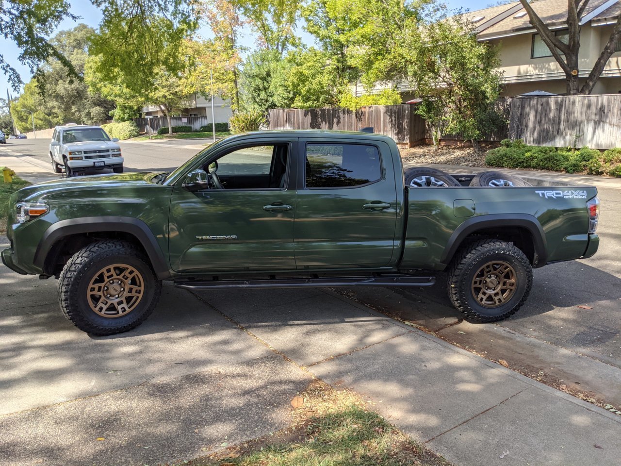

    Finally got the wheels in after Fedex delayed delivery for a week.. 255/80r17 ST Maxx tires. Stock height. So far, I had a bit of rubbing on the drivers side when moving forward and turning left. I'm guessing it's more pronounced here since drivers side sits lower. I trimmed about 5cm from a plastic piece, nothing major, and that rubbing is gone. No rubbing in reverse, even full turn. I also noticed slight rubbing if I brake hard. I'm feel like there's definitely going to be more rubbing off road since the space is pretty tight there. I'm going to get a 2 inch lift soon and I think that will sort the rubbing issues out. I think it will also help with the look.. Right now it looks like a lowered truck lol..

    I love the bronze on green. Looks killer. I almost went bronze but black just looked better.

    Really like the bronze, heavily considering it for my black taco
