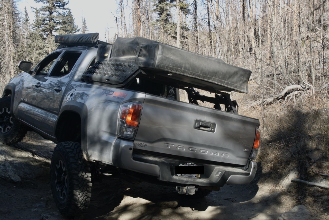

    Update: installed 1.25” spidertrax spacers onto my stock 2020 TRD OR wheels to effectively get to -6 offset and the 255/85/16 Geos rub on the fender pretty good during bumps even with 2” lift and UCAs, it’s because of the backspacing of the stock wheel. We trimmed and used a torch to bend it back a bit. Will definitely still rub at stuff and turn. We are going wheeling in about an hour, I’ll report back with whatever issues we run into. I don’t think I’ll hit the cab mount during full stuff and lock, but not 100% sure until I try. Have a good Saturday errbody

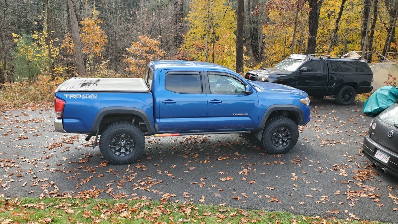

    Finally got these on, 255/85r16 wildpeak mt's looking good :D

    Shake down complete, only rubbing on full stuff at full lock in reverse so I'm not even going to do the CMC. Here's a baby flex, didn't take many pictures

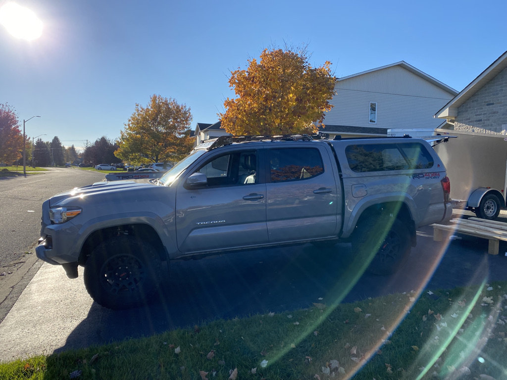

    [EDIT] see post #4650 below, 112 load rating will be fine because I will just borrow an F-150 if I want to tow a car carrier. The "drive axle" weight reported by the CAT scale includes the trailer axles because the scale is designed for 18 wheelers.
    I was hoping to get a P-rated tire in the 40 lb range for city fuel efficiency. But now I think I am forced into an LT tire, because these are the axle weights reported by the CAT scale, *before I installed the fibreglass cap*:
    steer axle: 2700 kg (2980 lb per tire assuming 50/50 left/right - I have an AGM battery which means the driver's side is likely in the 3020 lb range)
    drive axle: 2260 kg (2490 lb plus the cap will be in the 2590 lb range, before the tongue weight of any trailer and the stuff that will 100% be in the bed all the time)
    The Defender, and most other P-type tires, cap out at 2469 lb (load index 112).
    Absolute minimum load index I could run without exceeding max. load spec, is 115 (2679 lb). I would not be able to tow anything.
    Thoughts?

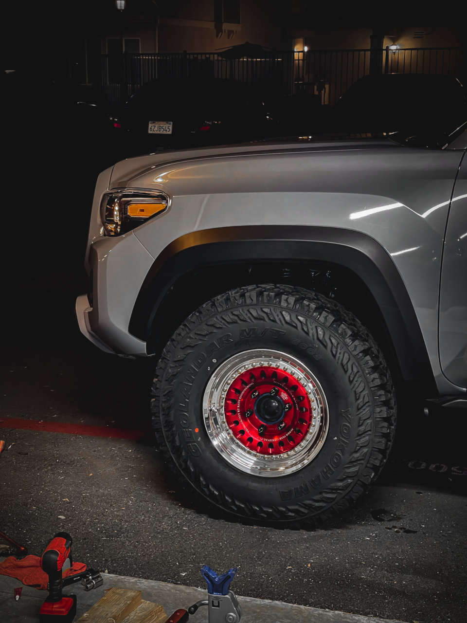

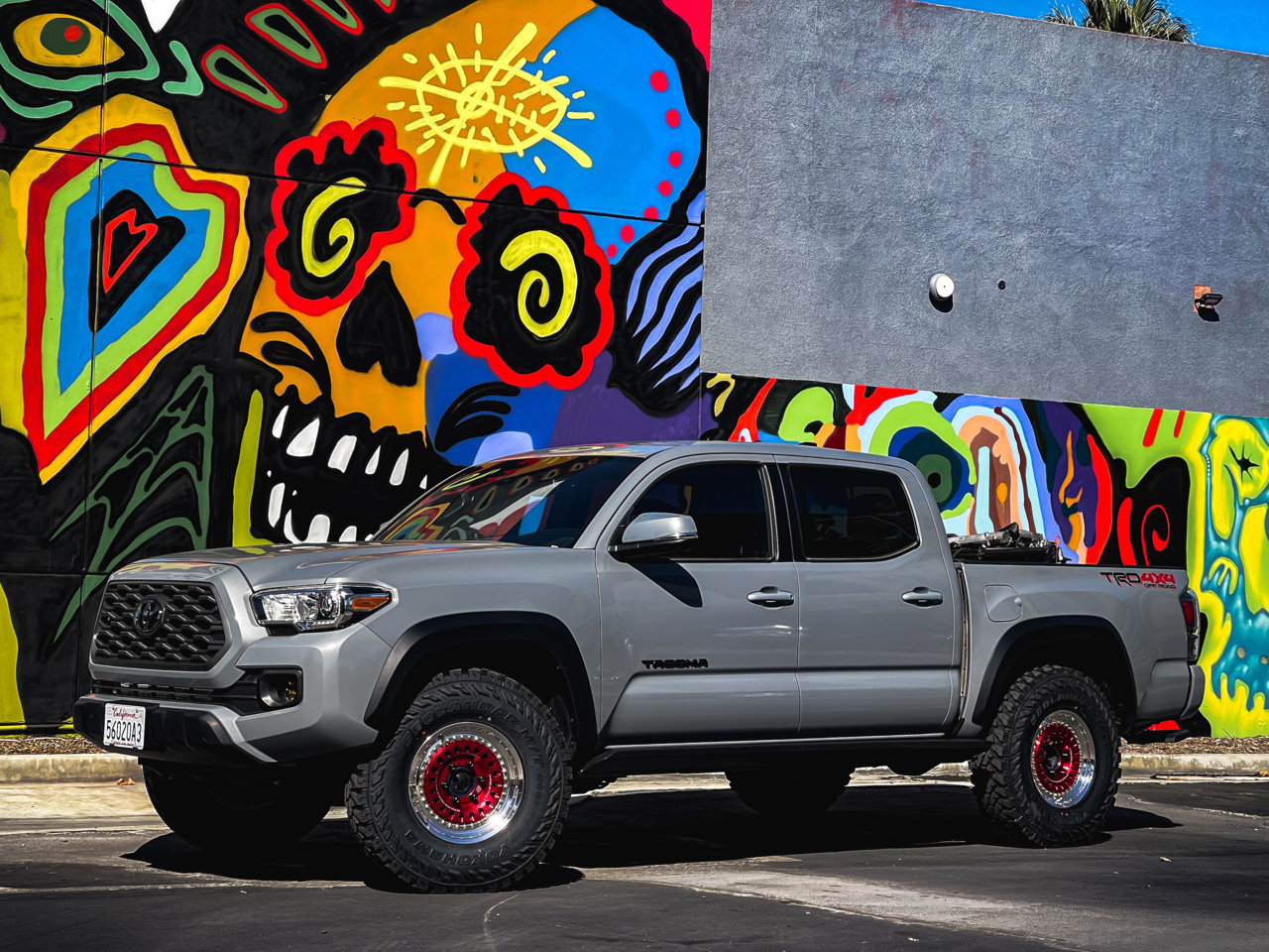

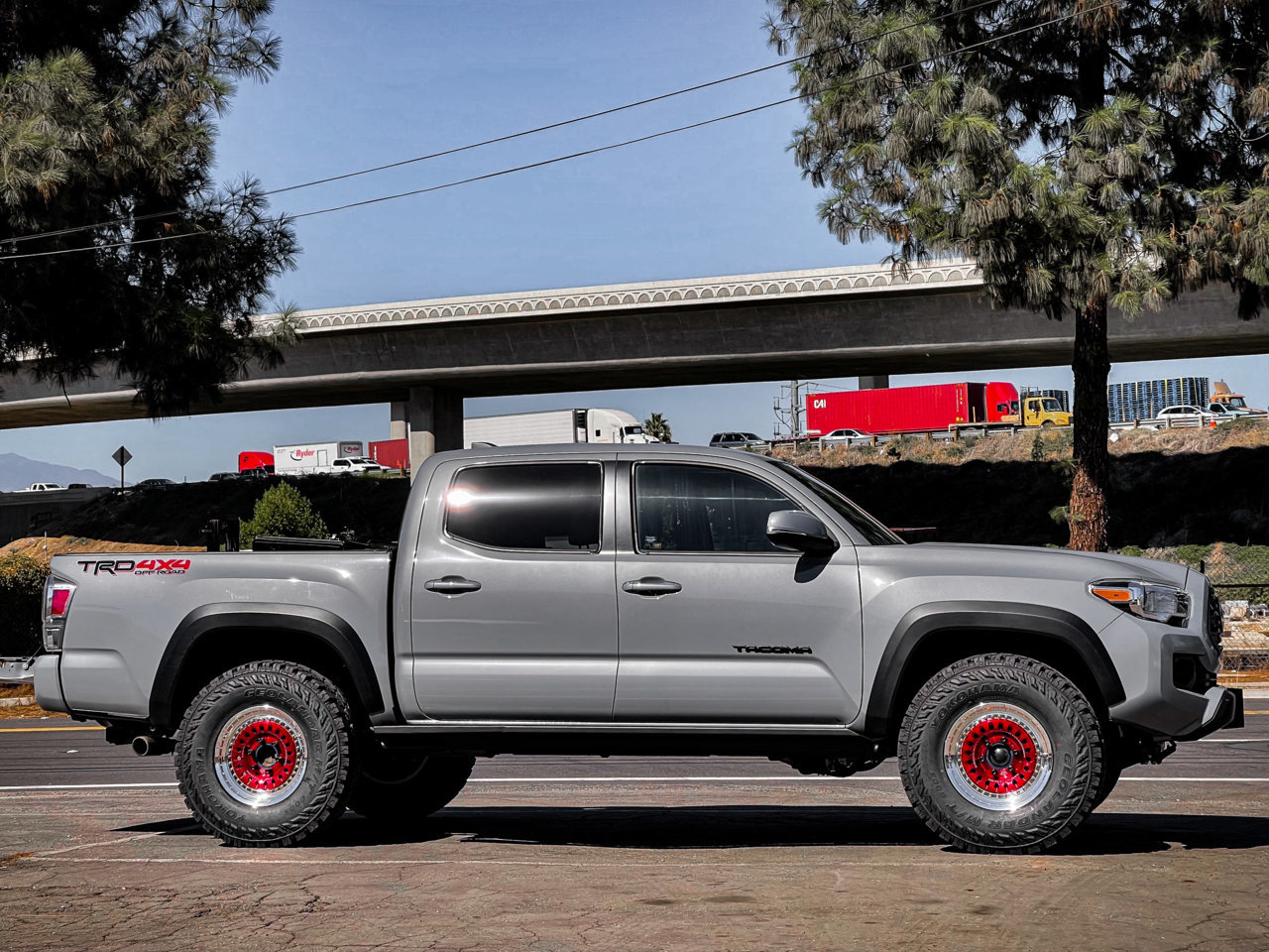

    17" TRD SEMA wheels w/ 265/70R17 Nitto Grappler G2
    Alrighty- I've been slacking. Here's photos of the new setup!
    These wheels are 16x7 +25 (similar to stock OR wheels) but i'm running a 1.25" spacer all around, making the effective offset -7mm. Similar to previous posts, Yoko Geo G003 255/85r16. Stock ride height. It rubs. These tires are pretty tall but share nearly identical treadwidth to my original Nitto Terra Grappler 265/70r17.
    Rubbed on the edge of the over fender plastic at the fender base so I trimmed it off. Extremely close to cab mount but I can probably fix that with a little caster adjustment. Rubs in front just barely on the fender liner, and under large bumps I'm getting some contact on the fender liner near the pinch weld.. I think if I pulled the wheels in about 10mm I'd fair a little better but I like how it looks so I plan to mold the fender liner and go from there. No off road yet until the trimming/molding happens.
