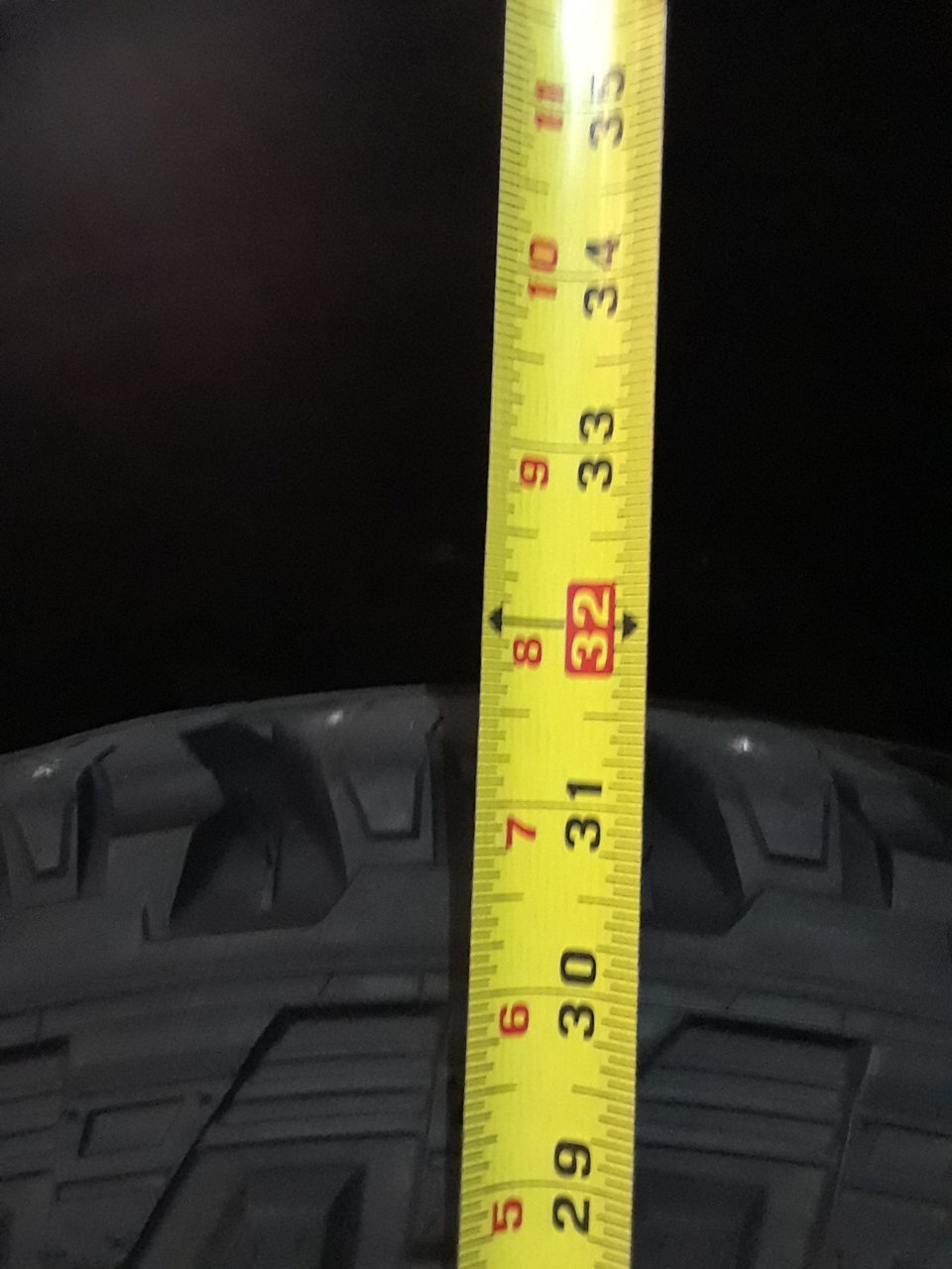

    Great tires! My 255/85R16 are mounted on stock wheels & stock suspension and don't rub anywhere.
    With my truck weight and 37psi, they reach 31.75" from the floor.
