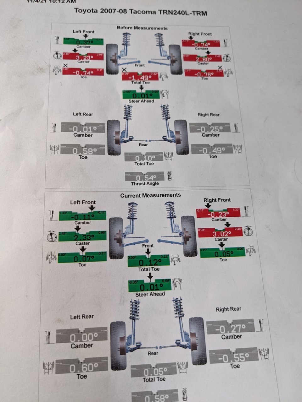

    '21 DCLB TRD Off Road - Army Green
    I guess that's a possibility too. Are these numbers bad? Where should they be if you have any suggestion?

    Numbers are theoretically fine but it will pull to the right and your only using the LCA bolts to set alignment. You’ll need SPC UCAs so you can move the wheel forward in the wheel well. A standard high caster UCA will move the upper ball joint back and cause more clearance issues, you need the adjustable UCA ball joint and a good tech to make it work. Can’t be that much rubbing though. I would cycle the wheel with no coil over and cut for clearance.

    Your caster is right where mine was running the larger Toyo 255’s yet I was not able get the tires to rub.
    Maybe the reply above is onto something.. not sure. I was expecting you to have much lower caster numbers.

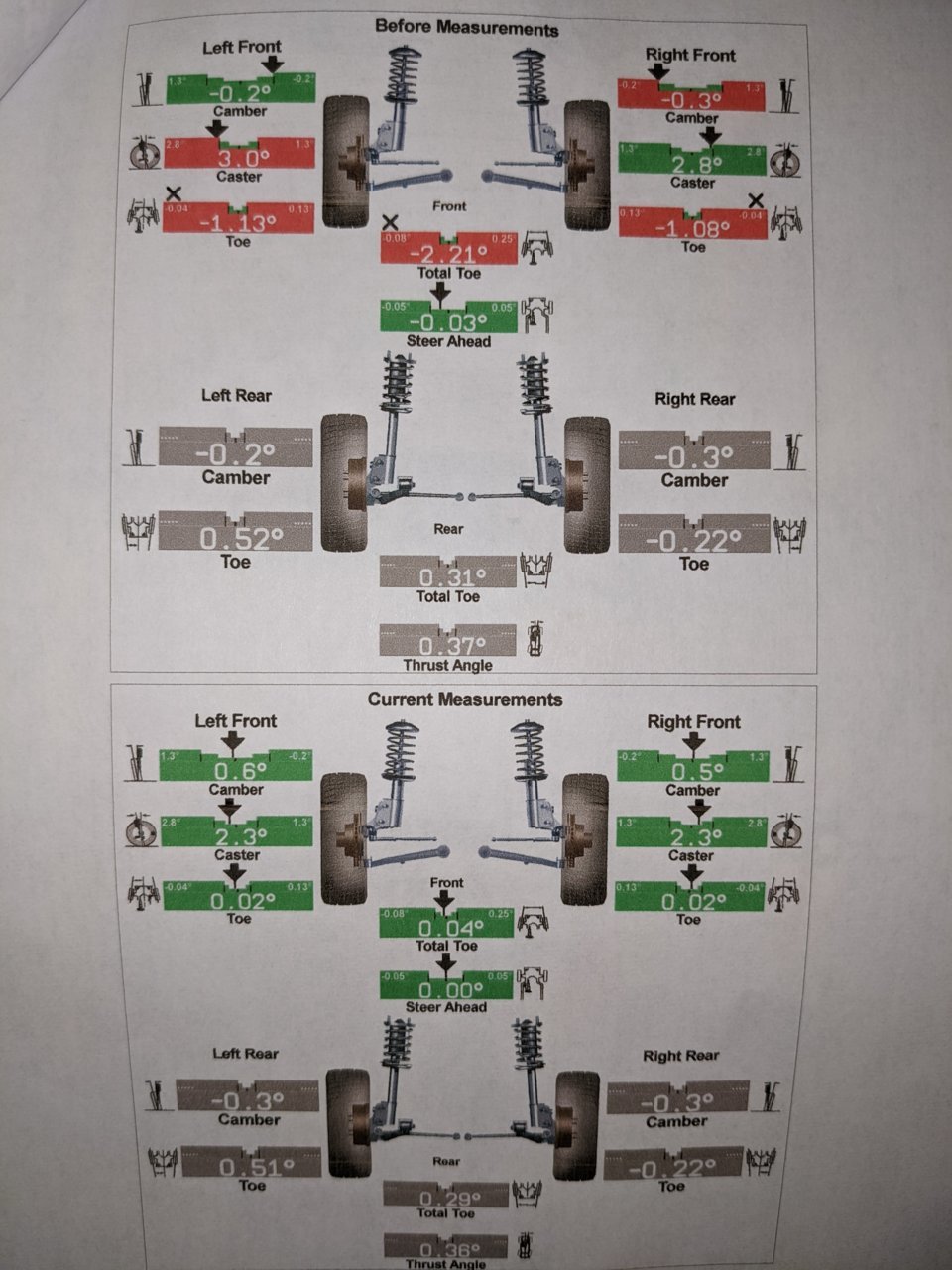

    Since we are talking alignment numbers and such with skinny tires here are mine. I have the 5 spoke OR wheels and about a 2.5 inch lift using 5100s. I got wildpeak AT3w tires at 255/80/17r. When I got the JBA UCAs installed, rubbing on the inner side of the UCA got MUCH worse than with the stock UCAs. The alignment tech that I spoke with said he couldn't do better than what is shown in the numbers below. Nothing is bent and most of suspension is new. I find it hard to believe that things would be so bad with the new arms. He had no idea why I wanted caster at 4.0 even though thats what the JBAs are designed for. Did I just get a tech that has no idea what he is doing?

    JBA's will rub anything taller than 32.5 on stock wheels. Plenty of back space info on their website.

    Talked with them on the phone and they mentioned that they should pass no problem according to their site it also says it should pass. Some members on here are running the same thing also. I'm getting a rub with almost one full turn of the wheel.

    Gotcha. Actually looking at your numbers I wonder why the tech adjusted the camber like that? I think a better alignment tech could get that sorted out.

    That's what I was thinking. Unfortunately out of everything alignments are the thing I have no idea are done. He was saying I have no more adjustment on the bolts but JBA says that can't be right as the UCAs should be able to adjust back to a good spec.

    I set my LCA bolts to push the wheel all the way forward, maxed out.
    Use the UCA adjustable Ball Joint to set camber to 0.
    Check caster.
    Use UCA adjustable Ball Joint to get caster near 2-3 degrees.
    Adjust LCA as little as possible to get caster in spec.
    If needing to make major adjustments or running out of adjustment at the LCA, adjust UCA Ball Joint to the next position to get most caster. (SPC UCA, not sure about JBA)
    The more caster you have to add at the UCA, the less firewall clearance you have.
    The more caster set at the LCA, the more firewall clearance.
    The goal to to keep the LCA adjusted as far forward while keep the UCA ball joint adjusted as far forward as possible while getting 0 degrees camber and at least 2 degrees of caster.
    Add 0.6 degrees more caster to passenger side to compensate for coming pull to the right.
    Set toe last.
